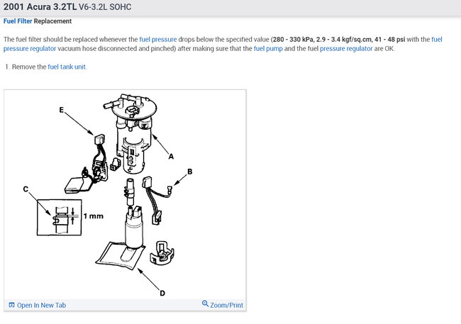

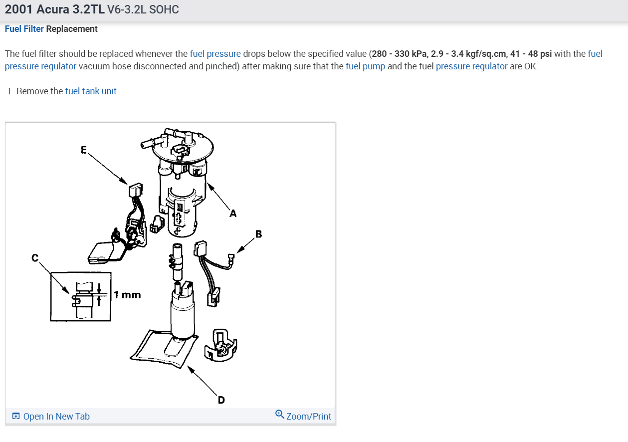

If no codes are present let's check the fuel pressure because it sounds like the fuel pump is weak. This guide can help, and you get rent a fuel pressure gauge from the auto parts store for cheap or free.
fuel pressure specified value (280 - 330 kPa, 2.9 - 3.4 kgf/sq.cm, 41 - 48 psi)

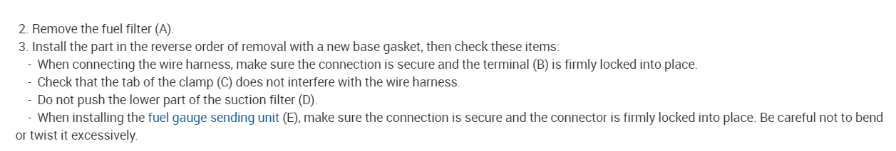

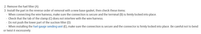

If the pressure is low this is how to change the pump out. Check out the images (below). Please let us know how it goes.

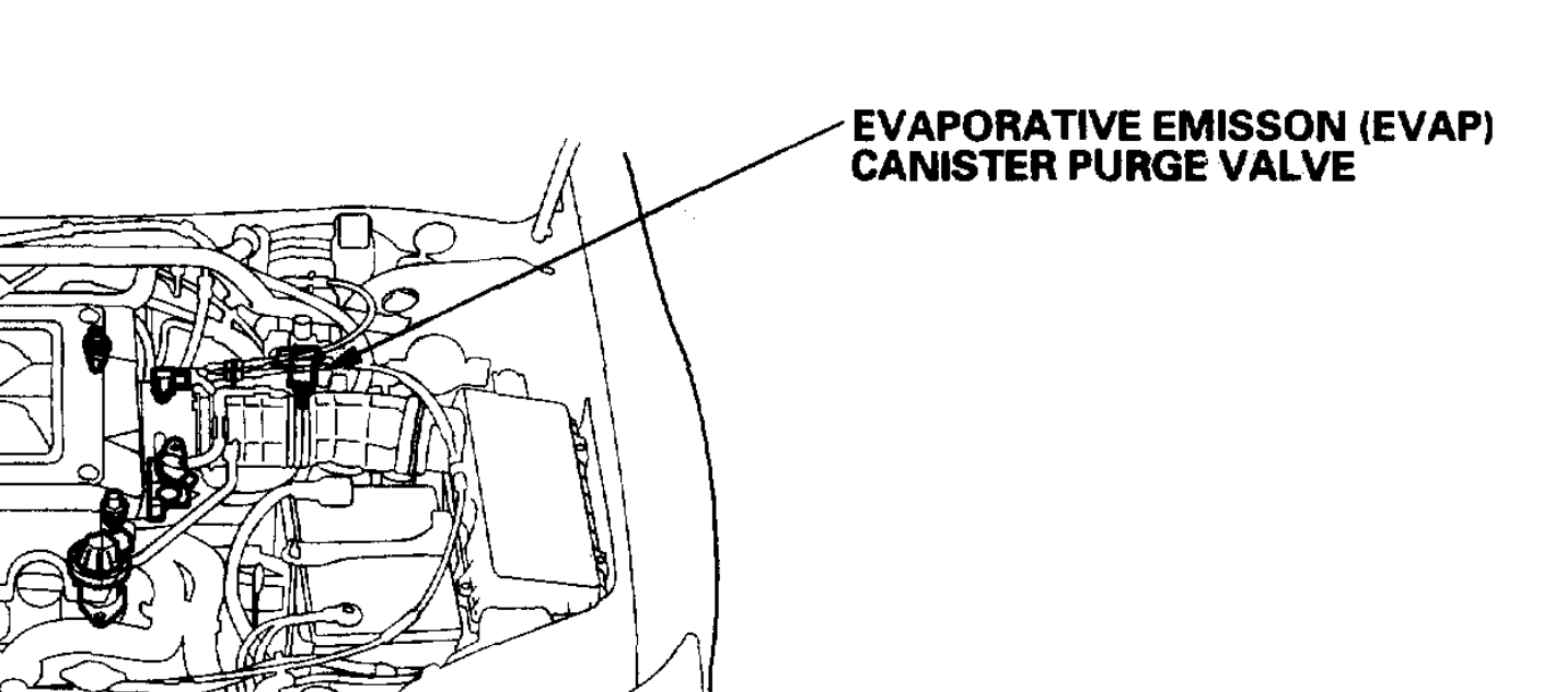

The evap system leak detected code is a clue that the EVAP purge solenoid might be stuck open, let's remove it to see if you can blow through it, if so, it is bad and needs replacement, here is the location. Check out the images (below). Please let us know what happens.
