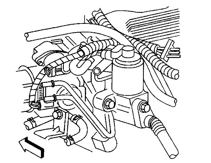

I had the same problem with my 99 alero. The problem was a vaccum leak, a small hose located right on the front of the motor had worn and split. The issue was that I couldn't see it was split from the front, rather the puncture was on the engine side (facing the motor). Right as you open the hood, look straight down, across from the cooling fans you will see a black rubber fitted hose that connects from the intake to the exhaust manifold. Carefully pull it off (there are no clamps holding it) and inspect it. It costs less than $2 to buy a new hose and replace. While trying to diagnose the problem myself i changed the spark plugs, airfilter, cleaned IAC and throttle body...all this to eventually find out it was a simple fix...oh well the car runs like new now:-) Goodluck!
