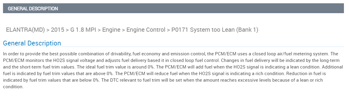

Can you look at any live engine data with your scan tool? Look into Live ECM Engine control module data, and (1) look at the MAP sensor voltage at idle, (2) look at Long Term and Short-Term Fuel Trim (LTFT-STFT) most likely because of the code the fuel trim will be positive. The ECM is reading a lean exhaust so it will add more fuel.

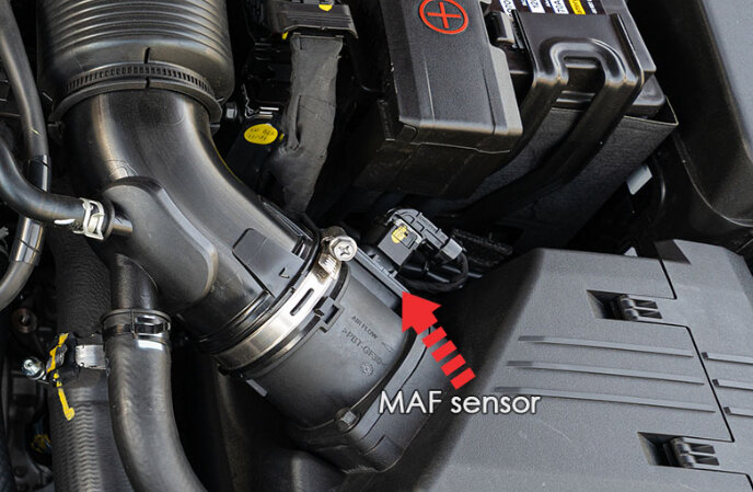

I don't believe this vehicle has a Mass Air Flow sensor, I don't see one on the wiring diagrams, but if it does it would be on the air intake boot usually near the air filter housing. It measures the air coming into the throttle body. I will post some more information of fuel trims as well.

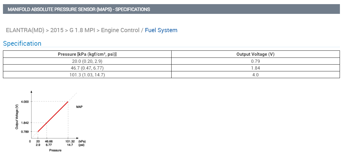

The MAP sensor voltage should be below 1volt at idle with the throttle plates closed and as you open the throttle the MAP voltage should rise to around 4volts or so.

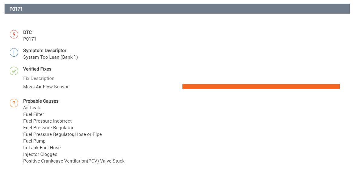

The 3rd diagram are some possible causes, but disregard the Mass Air Flow sensor, I don't see one on this vehicle. The 4th diagram shows what a MAF looks like.
