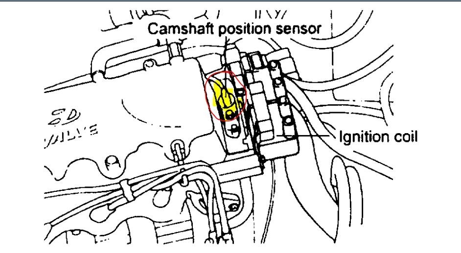

Do that first and let me know the results. Also, I attached a pic below of the cam sensor. Make sure wiring and the connection is good and not damaged.
Let me know what you find.
