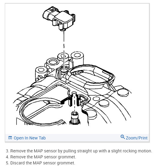

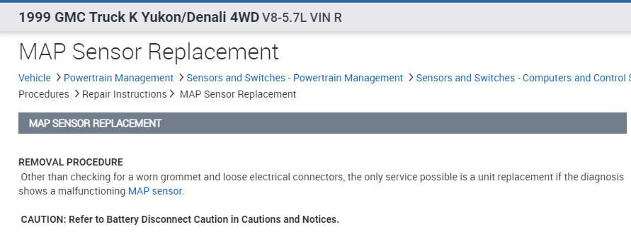

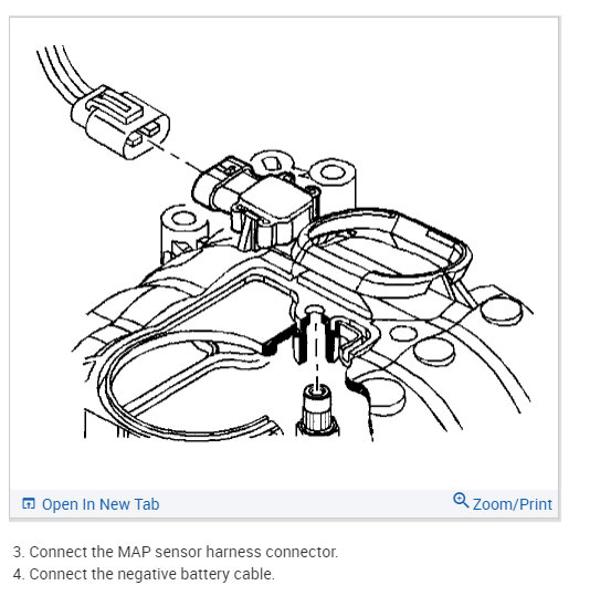

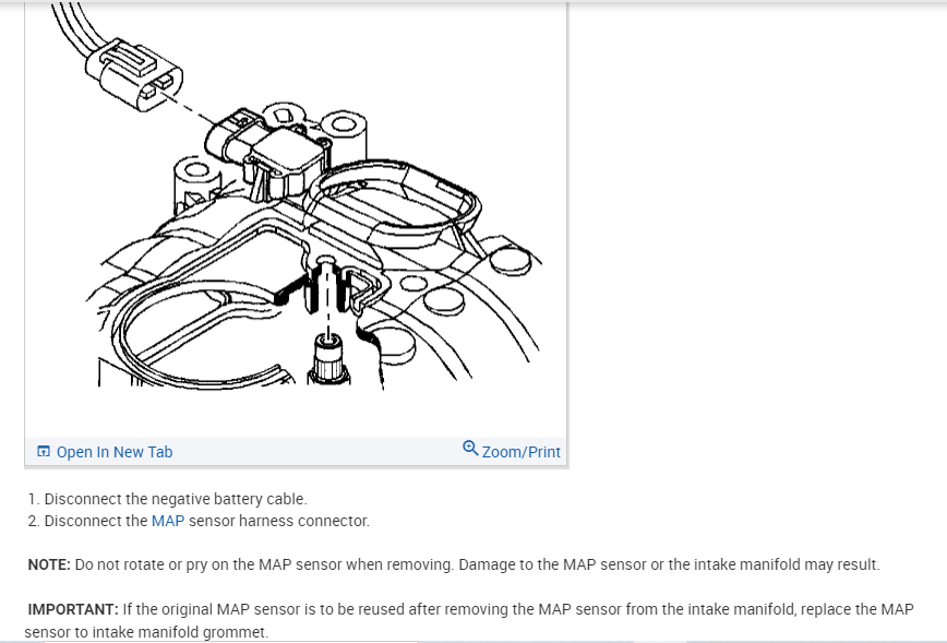

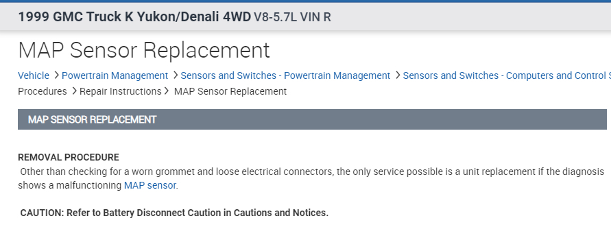

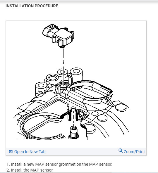

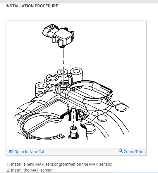

If the MAP is bad, yes it could cause this to happen. Check to see if there are any issues at the connector. Check for corrosion or damage to the connector.
I attached the directions below showing how it's replaced.
Let me know what you find.
See pics below.
