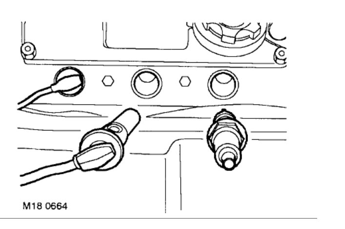

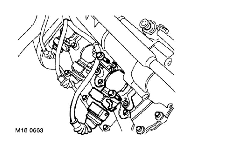

You can't tell if the plugs are worn on the iridium plugs, you just have to replace them. Mileage only.
I would start there with a clean slate and do wires as well (OEM only). Here are some diagrams to help you. (Below)
https://youtu.be/c9_NVXiwvYg
Set gap of each new spark plug to 1.00 mm .
Fit spark plugs and tighten to 25 Nm (18 ft. lbs.) .
LH bank only: Connect ht leads.
RH bank only: Fit plug top coils to spark plugs.
RH bank only: Fit bolts securing plug top coils to RH camshaft cover and tighten to 9 Nm (6.5 ft. lbs.) .
RH bank only: Connect multiplugs to plug top coils and secure with locking clips.
Fit engine acoustic cover.
Connect battery earth lead.
