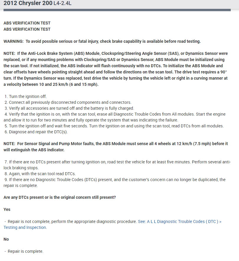

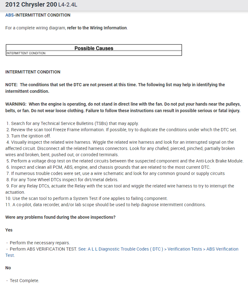

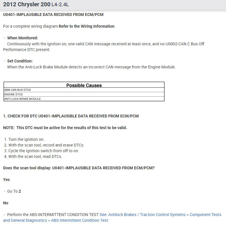

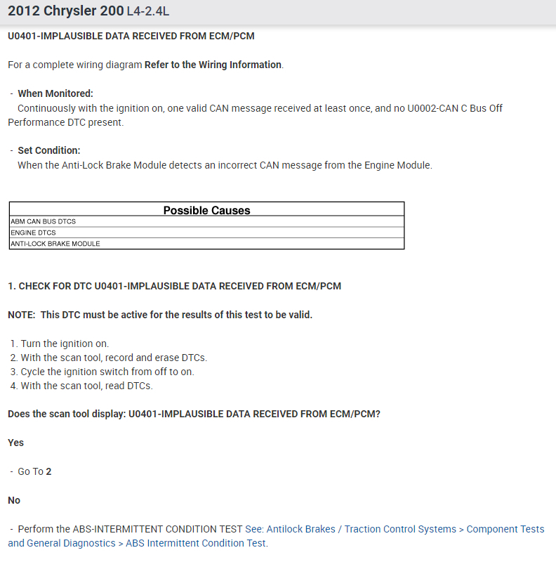

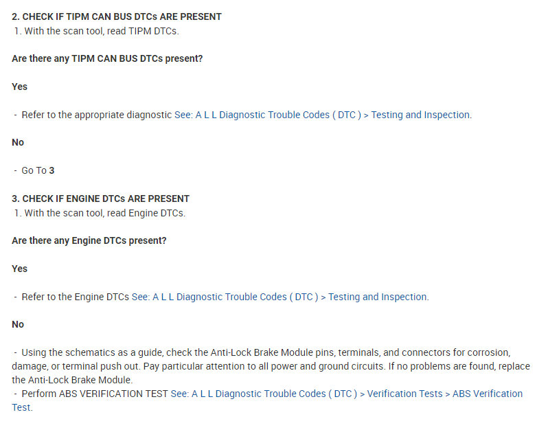

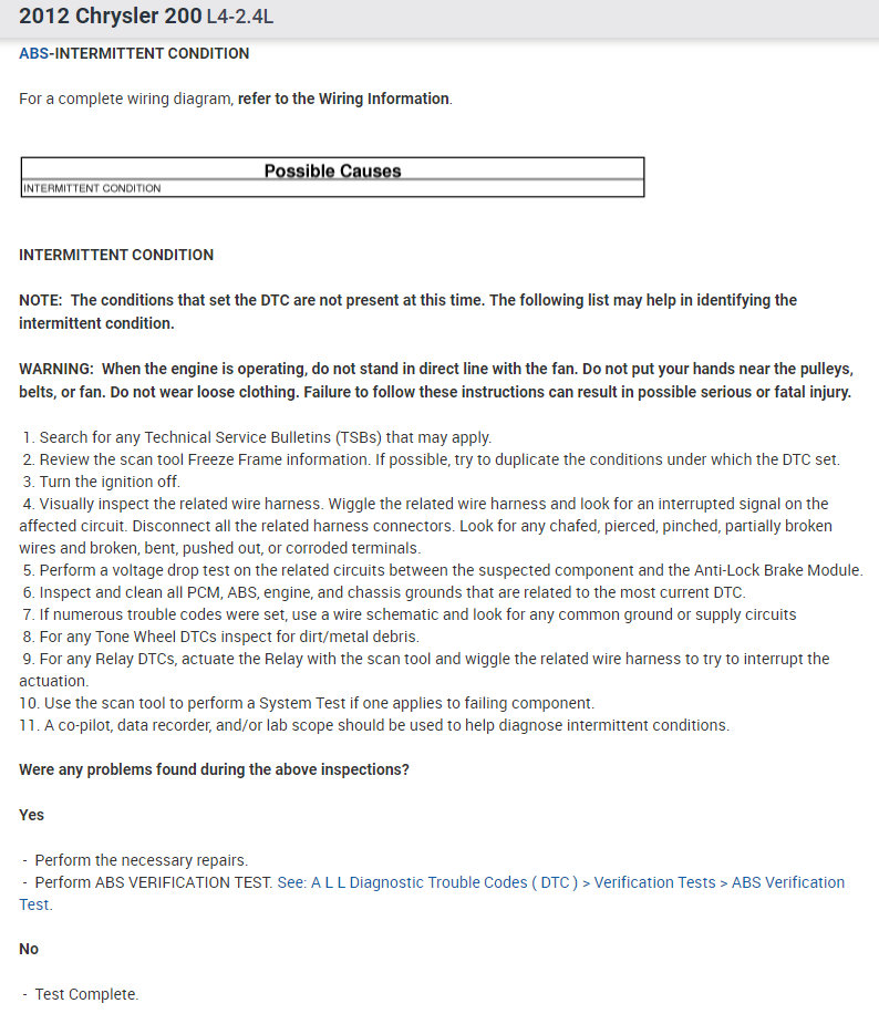

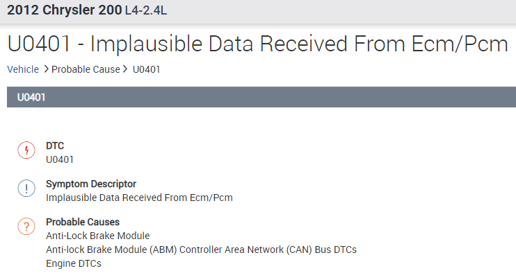

The code:
U0401-Implausible data received from ECM/PCM
This could be triggered due to the Anti-Lock Brake Module, the brake module controller area network (CAN) bus.
I have included the basic diagnostics for that code (look below).
As for no start what does it do? Does it crank? Are you getting fuel/spark?
Please let me know.

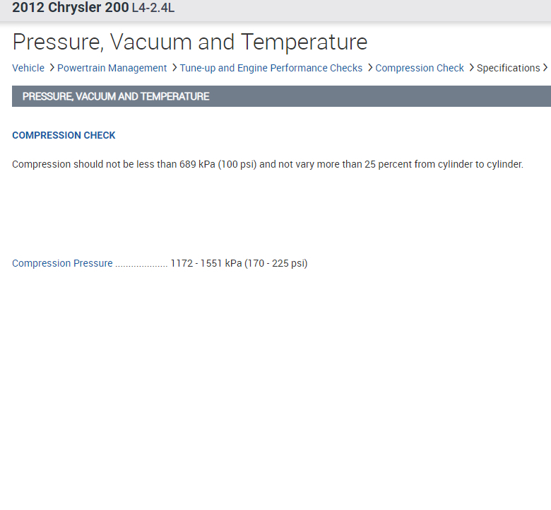

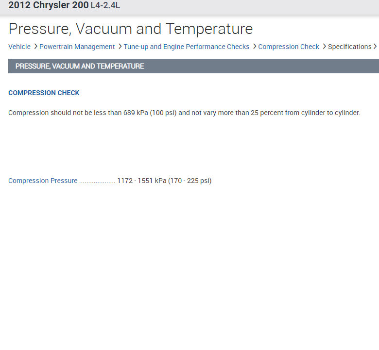

Well, the fuel pressure is good. But there is no way to 'deactivate or bypass' to start the engine.
The compression low. It should be in 170 PSI range.
Low compression is another piece of the puzzle in a non-start situation.
