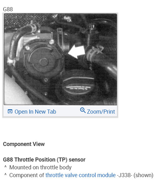

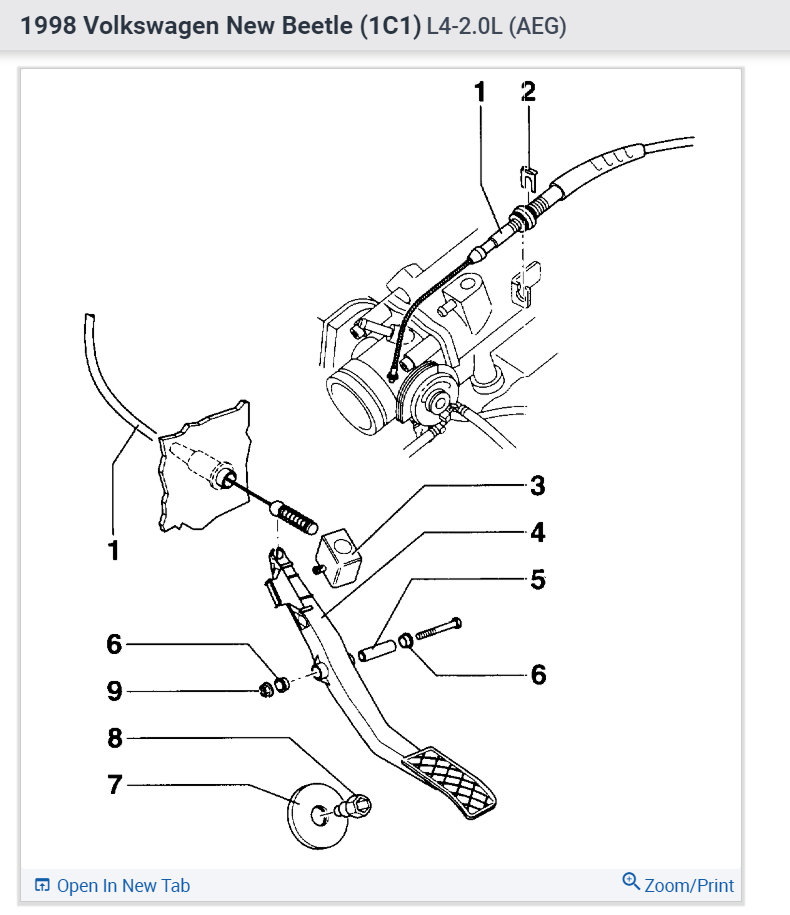

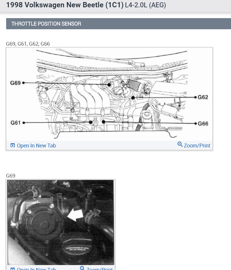

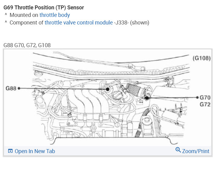

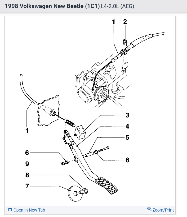

These are throttle body codes I would replace the TPS and clean the throttle bore. here is a guide and diagrams below to help you get he job done:
Jul 2, 2019 at 1:37 PM
