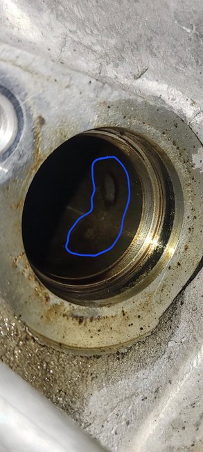

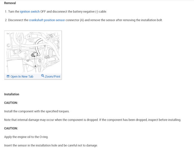

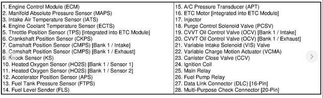

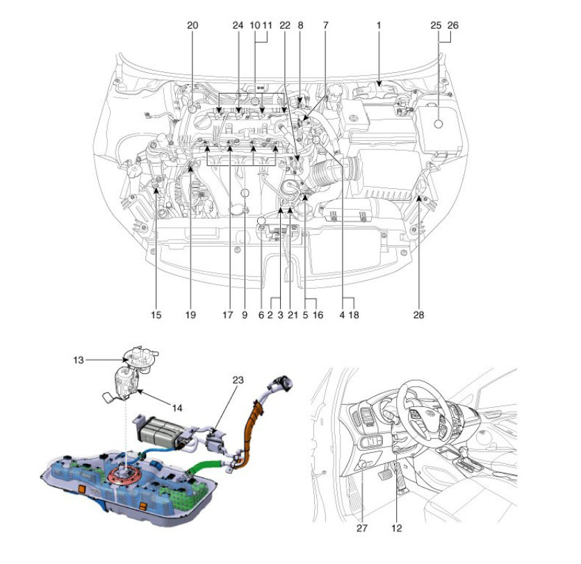

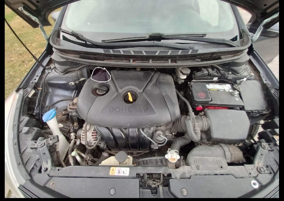

I need some advice. When it gets hot outside my engine will randomly shut off, all of the electronics are still on, power steering and A/C still work. It doesn't chug or sputter like it is running out of gas, the engine just turns off. I just put the car in neutral and turn the key and it fires right back up.
Some observations I've made, it seems to happen when I have let off the gas to coast like when approaching a red light or traffic on the interstate. It doesn't seem to happen if I am actively pressing the brake pedal to stop. A/C on or off doesn't make a difference. It seems very random, sometimes it won't shut off for a week and sometimes it will shut off three times in one day.
Things I've tried: replaced spark plugs and coils. used a propane tank to check for vacuum leaks. cleaned the throttle body. pulling check engine light codes, there weren't any and the light isn't on.
If I can give any additional details that might help, please let me know. I've been dealing with this since last summer and then it stopped when the weather cooled off and it has been getting worse and worse as the weather gets hotter and hotter again.
