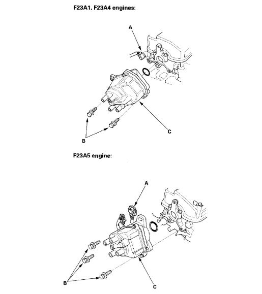

When it does not start, did you check for spark and can you hear the fuel pump run?
It could be either. Spark is a more common issue.
