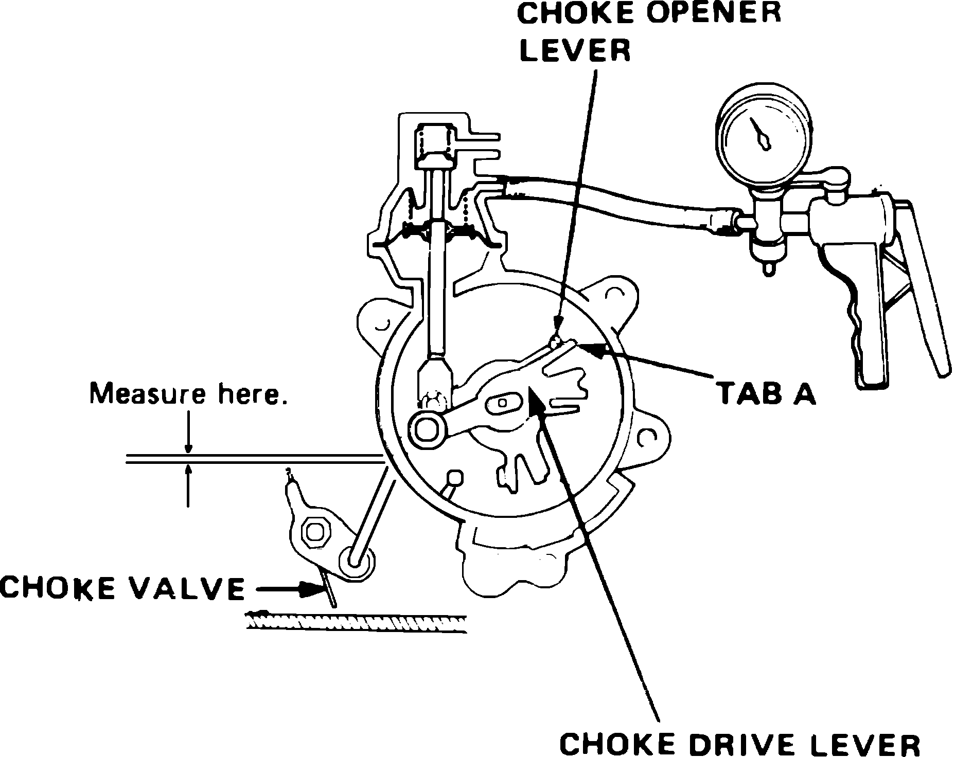

Fig. 9 Choke linkage adjustment, first stage. See picture 1
1. Remove air cleaner and choke coil
2. Disconnect upper choke opener hose from thermo valve and leave open to atmosphere, and disconnect lower hose and connect suitable vacuum pump to thermo valve.
3. Apply at least 8 inches Hg vacuum to thermovalve. If vacuum drops below 8 inches Hg, vacuum pressure has opened bleed valve. Slowly reapply vacuum until highest vacuum reading can be maintained; this will bring opener rod as close as possible to bleed valve without opening valve.
4. Rotate choke drive lever counterclockwise until it contacts choke opener lever, then measure choke valve clearance, Fig. 9.
5. If 1st stage clearance is not .119-.125 inch for manual transmission models or .091-.097 inch for automatic transmission models, adjust by bending tab A, Fig. 9.

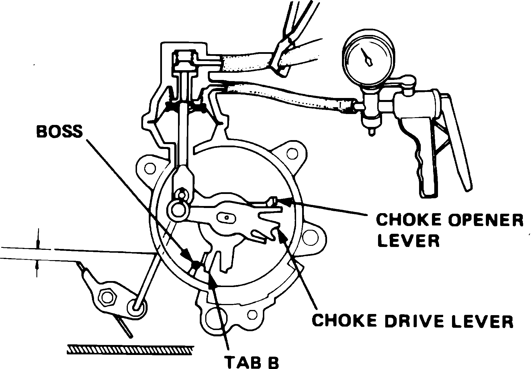

Fig. 10 Choke linkage adjustment, second stage. See picture 2
6. Plug upper port on thermo valve, pull choke opener rod to the fully extended position by applying 6-7 inches Hg vacuum to lower port, Fig. 10, rotate choke drive lever counterclockwise until it seats against choke opener lever, then measure choke valve clearance.
7. If 2nd stage clearance is not .200-.208 inch, adjust by bending tab B, Fig. 10.

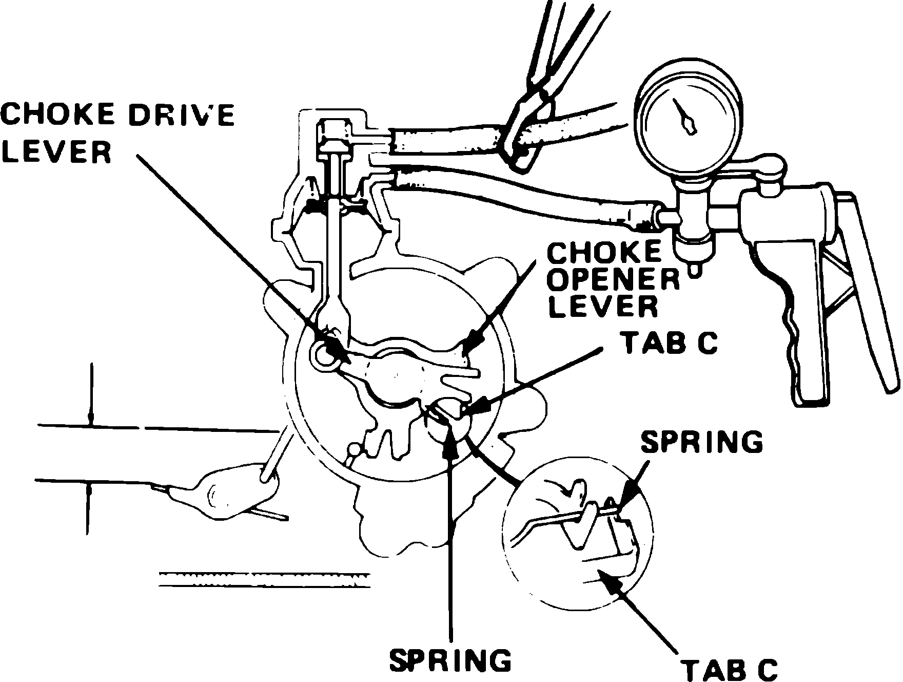

Fig. 11 Choke linkage adjustment, third stage. See picture 3
8. Continue holding opener lever against tab, rotate choke drive lever until tab C contacts spring, then measure choke clearance, Fig. 11.
9. If 3rd stage clearance is not .394-.412 inch, adjust by bending tab C, Fig. 11.

For the measurements shown on the sketches, I do not understand what the upper horizontal line is measuring to.
And - what measuring device to you guys use to get an accurate readings as measured on the horizontal in such a limited space and, worse, being unable to measure directly parallel to the choke drive. i.e., it is not directly in the line of sight? Feeler gauges?
Steve
Nov 27, 2018 at 10:13 AM
The horizontal measurements are showing where to measure opening between choke valve and housing. Each step is for a different adjustment which shows the choke valve opening further.
