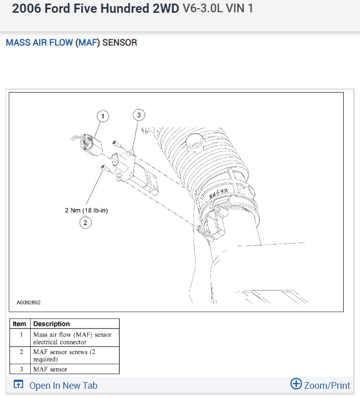

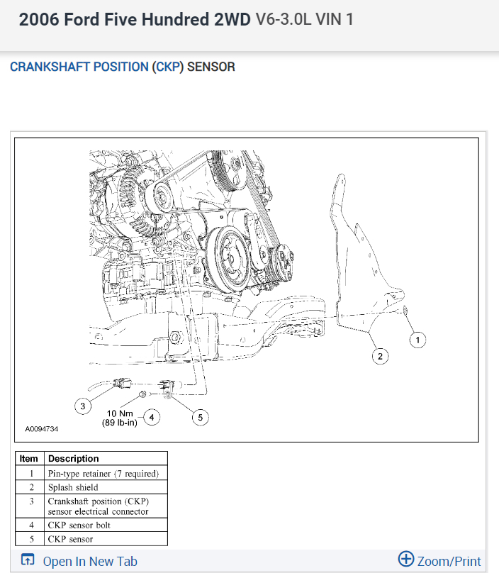

I have seen the MAF, and crankshaft sensor fail intermittently and cause this issue. But we should run the codes to see if any are stored.
This guide can help:
Here are the locations of these sensors so you can check them out. Check out the images (below). Please let us know what happens.
