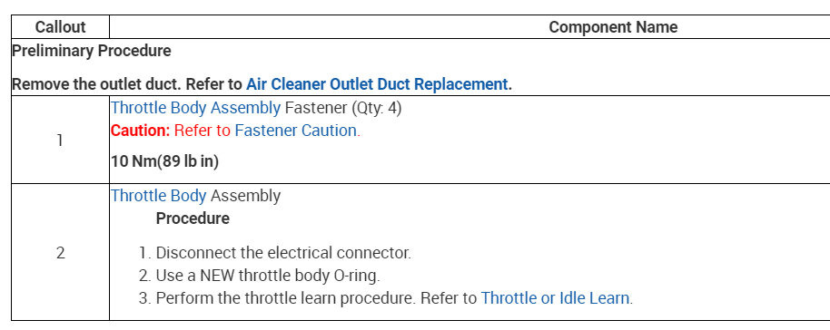

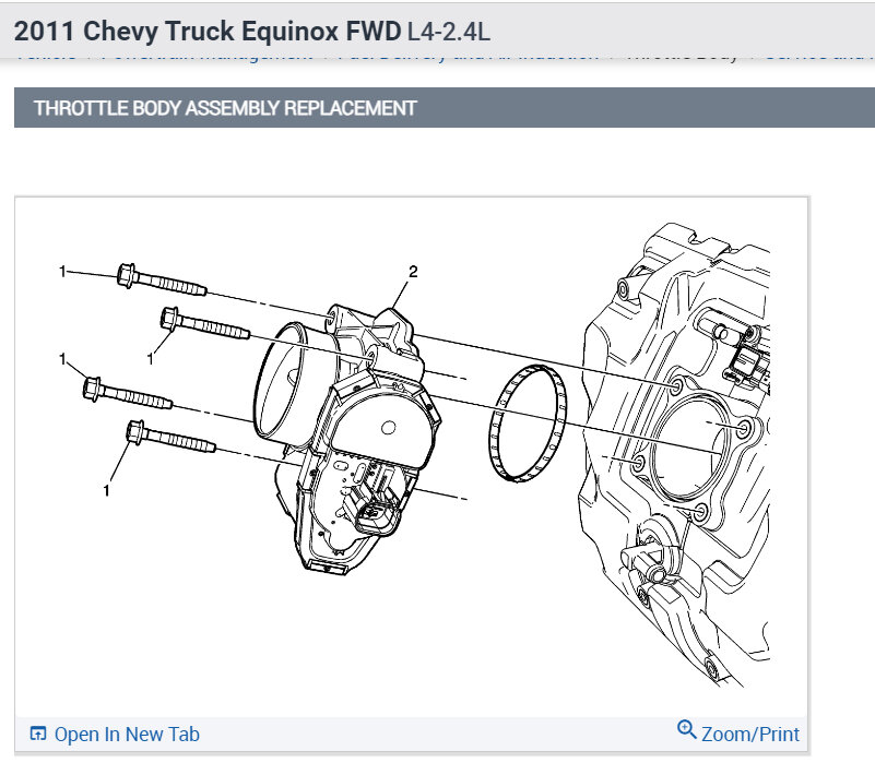

First make sure the engine oil is clean and full, next run the codes and give me the code numbers, then I would service the throttle body because it sounds like the vehicle is in limp mode.
Here is a generic guide to help you step by step with instructions in the diagrams below to show you how on your car:
Check out the images (below). Let us know what happens and please upload pictures or videos of the problem so we can see what's going on.
