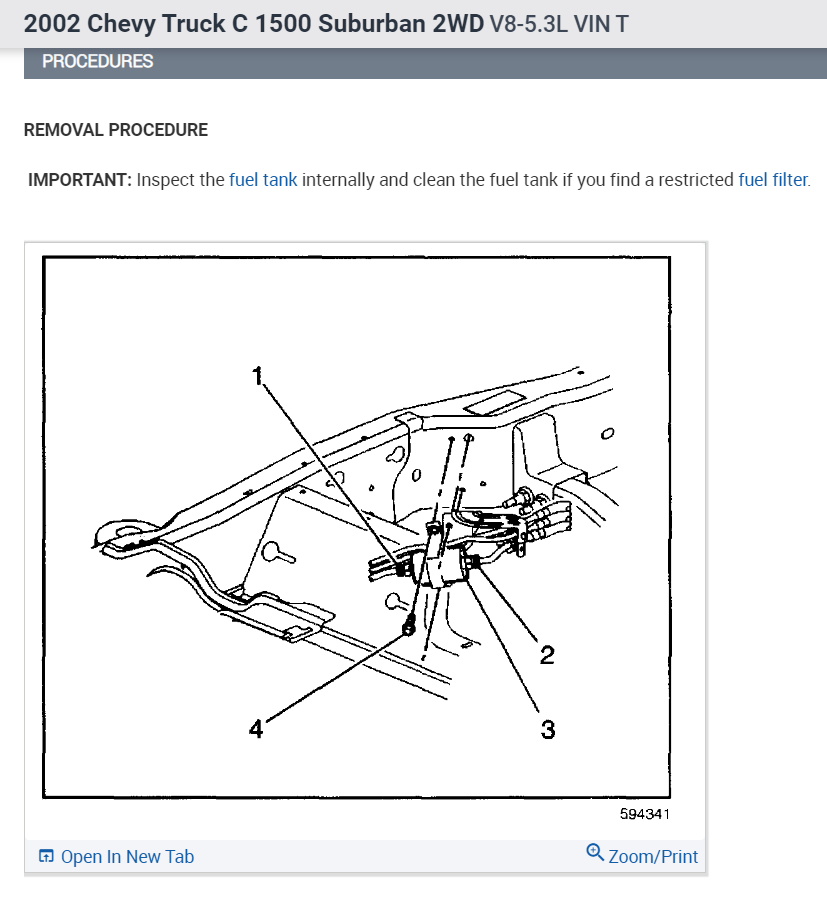

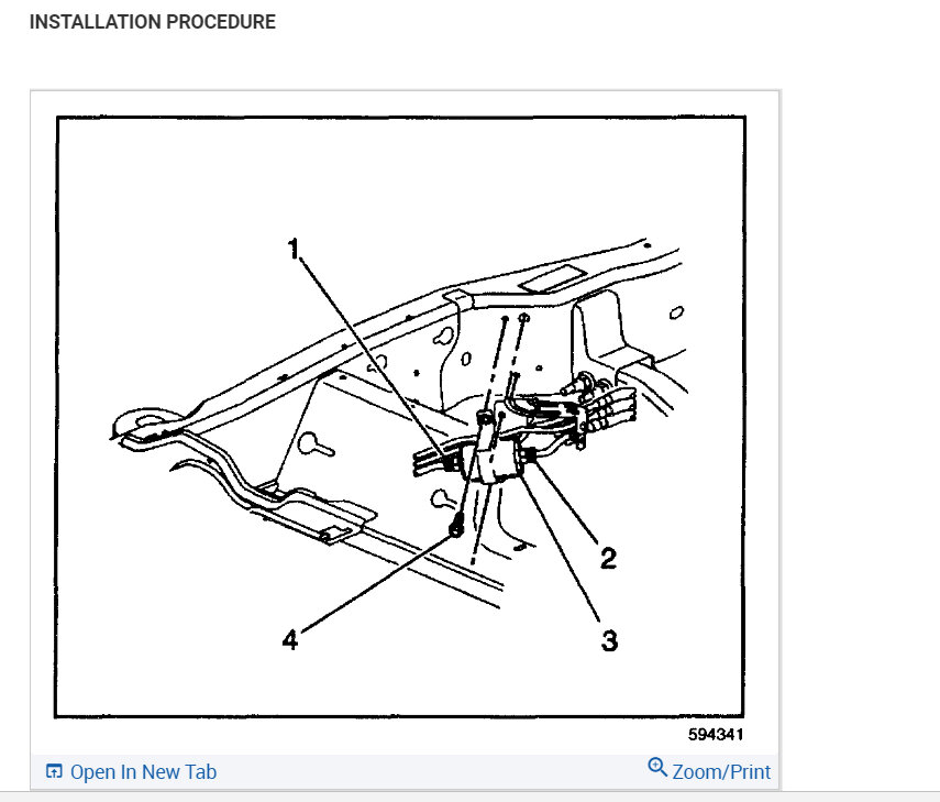

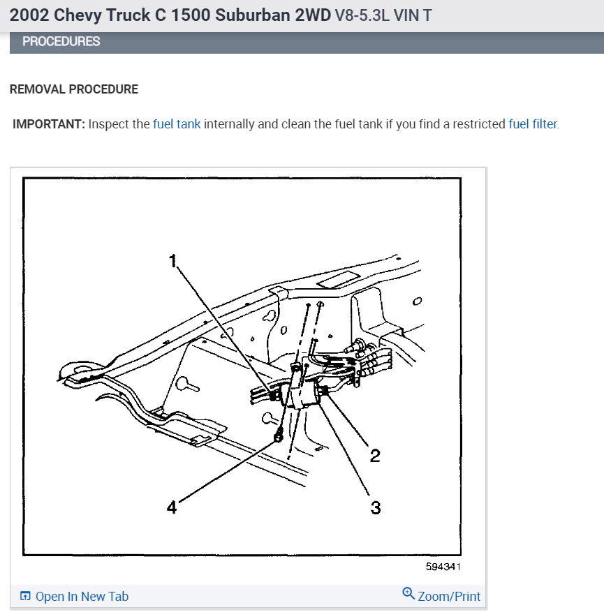

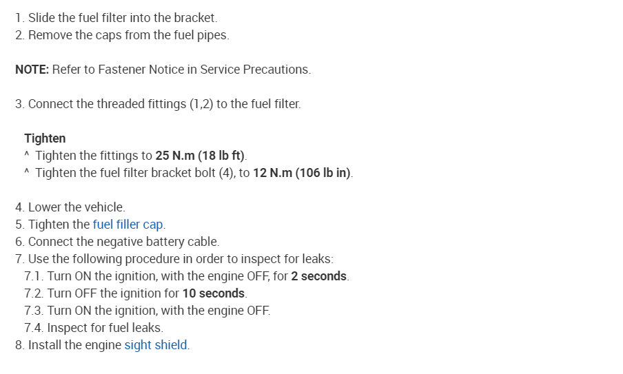

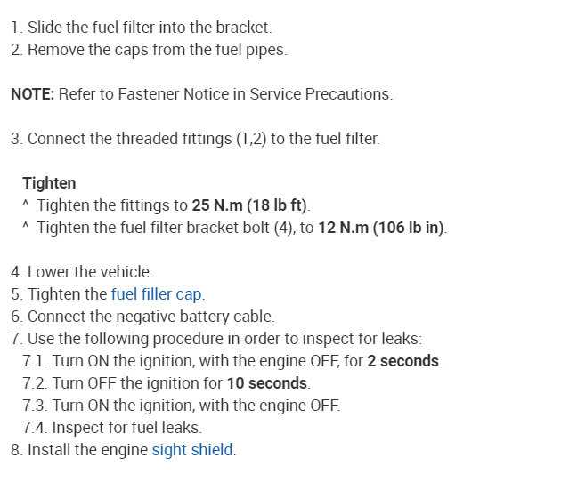

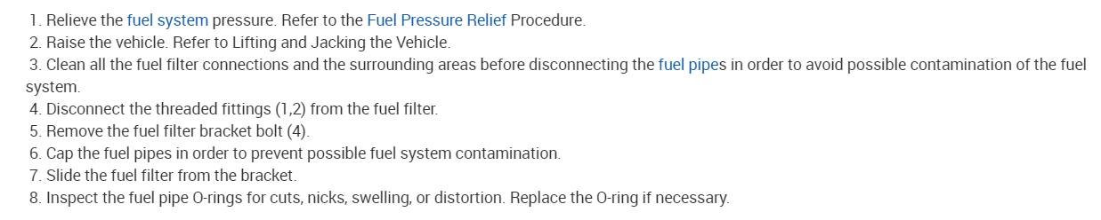

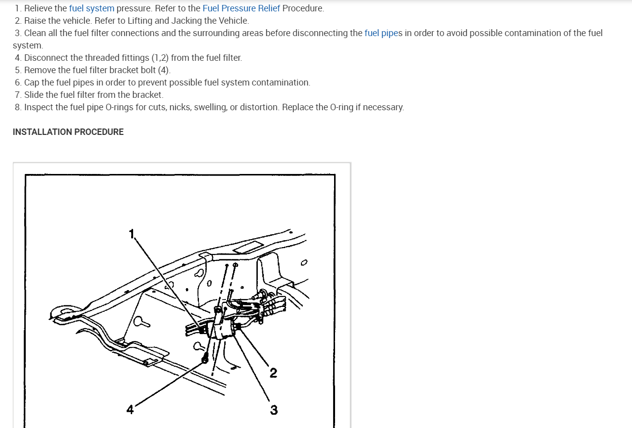

Fuel Pressure (gasoline) .................... 55-62 PSI so it looks like the fuel pump is weak or the fuel filter is plugged. Here is the location of the filter and how to replace it, I have included a video as well.
https://youtu.be/cMa2bp4jbNU
