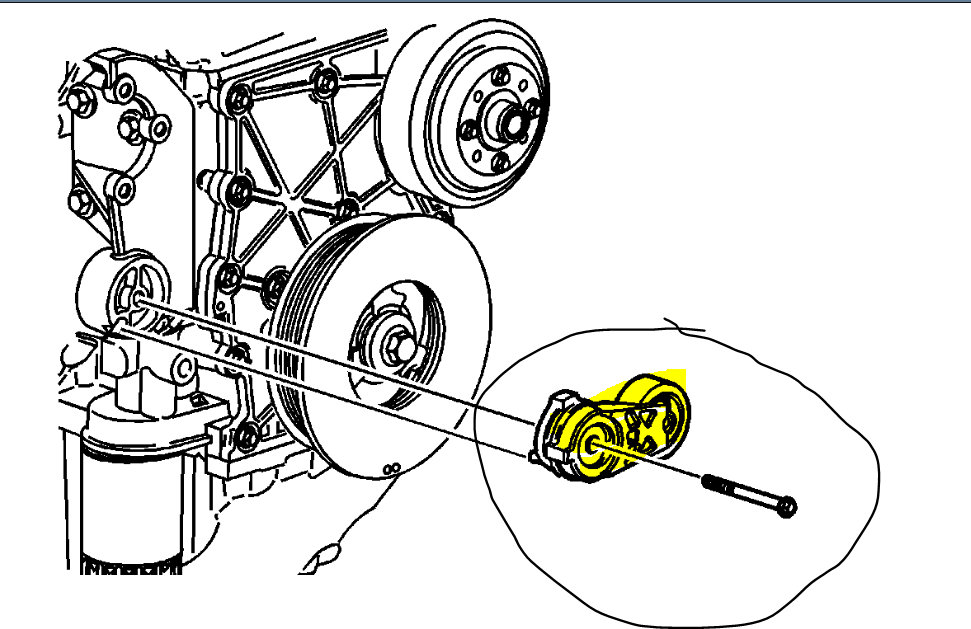

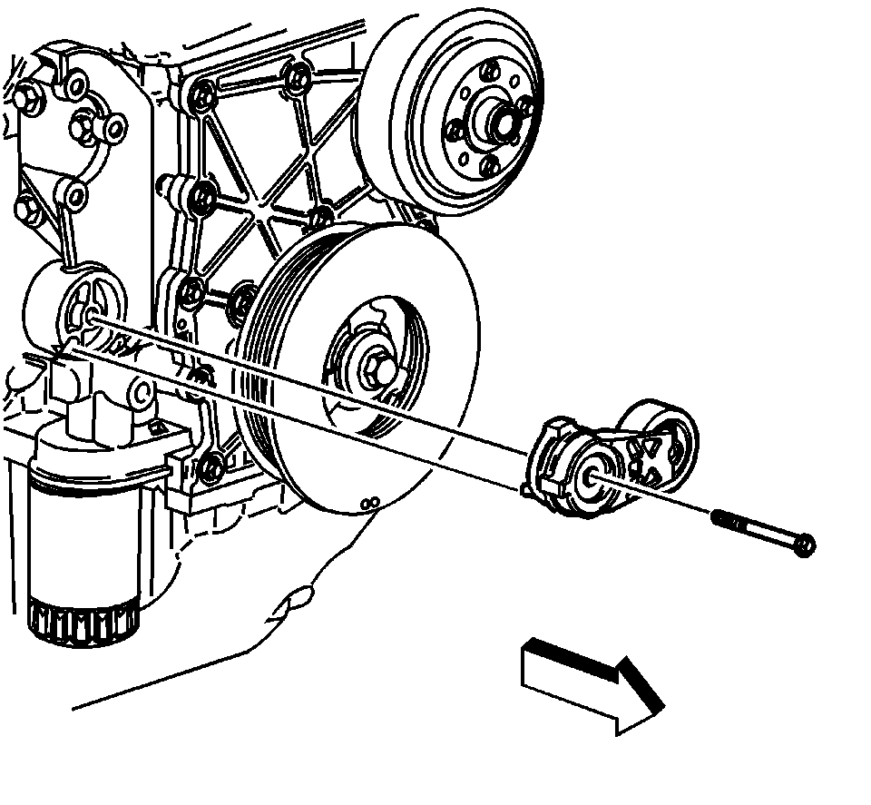

If you find the belt is not tight enough, there is an automatic tensioner that will need replaced. Here are the directions for that. The attached pictures correlate with the directions.
___________________
2005 Chevy Truck TrailBlazer 4WD L6-4.2L VIN S
Drive Belt Tensioner Replacement
Vehicle Engine, Cooling and Exhaust Engine Drive Belts, Mounts, Brackets and Accessories Drive Belt Tensioner Service and Repair Procedures Drive Belt Tensioner Replacement
DRIVE BELT TENSIONER REPLACEMENT
Removal Procedure
1. Remove the drive belt.
2. Remove the drive belt tensioner bolt.
pic 1
3. Remove the drive belt tensioner.
Installation Procedure
pic 2
1. Install the drive belt tensioner.
2. Install the drive belt tensioner bolt.
Tighten the drive belt tensioner bolt to 50 Nm (37 ft. lbs.).
Notice: Refer to Fastener Notice in Service Precautions.
3. Install the drive belt Drive Belt Replacement.
I highlighted the tensioner in pic 2 for you. Let me know if this helps or if you determine the belt isn't the issue.
