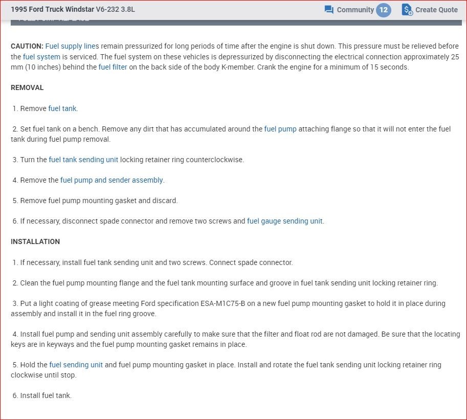

Sounds like this is a weak fuel pump. Let's start with getting fuel pressure readings when the vehicle is acting up.
Once you get the fuel pressure, I suspect we will find it is not the proper PSI.
Please let me know what you find. Just in case, I included the procedure on how to replace the pump.
