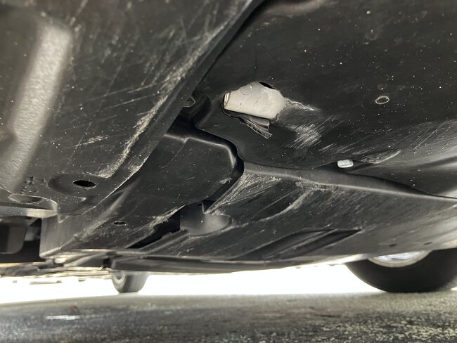

have a hole in Engine Splash Shield from impact, should i replace it or not?

Are you referring to the plastic shield under the engine compartment? I so, chances are you would be okay. However, if you have any wiring exposed or belts, water can become a potential problem if you hit a large puddle or drive in heavier rain.
If this wasn't a hybrid vehicle, I wouldn't be concerned.

here is the image, i don't know what's the white thing though as you can see in the picture... so, basically if you can look at this picture is it worth replacing it? thanks

Where it is damaged, I see something that appears to be steel. Is that correct? Also, because of the location, I feel it may be a good idea to replace it. I can't guarantee it, but you may get water up near the belt which can cause other issues.
Also, if all the plastic is still there, you could even drill a few holes in the damaged section and zip-tie it together. That should be okay as well. We just want to keep it sealed up as much as possible.
