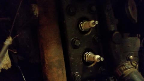

I have a old 38 Bantam, when I turn
Key the motor turns over very slowly.
Has new battery, clean battery terminals, etc.
See video, please help
Thank you

Does this have a 6 volt system or is a 12 volt system? If it is a 6, that is very common. Is the video the MG or the Bantam?

Joe hi, its the Bantam, 6 cylinder.
Thank you Kenny.

No, I meant is it a 12 volt or 6 volt system. Basically, is the battery in the vehicle a 6 or 12v battery? It is normal if for the engine to crank slower with a 6v system.

Joe, it's a 6 volt system, it's reversed , black is positive ground.
Thank you.
Kenny

Honestly, the way it is cranking sounds normal for that type of system. I don't think it will do any better.
Let me know if I can help.
