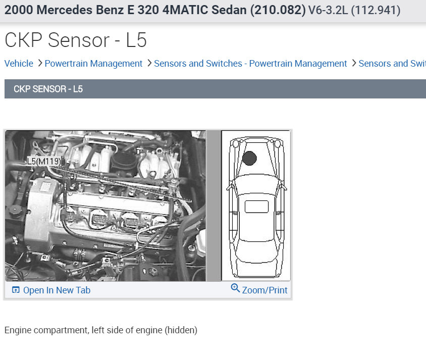

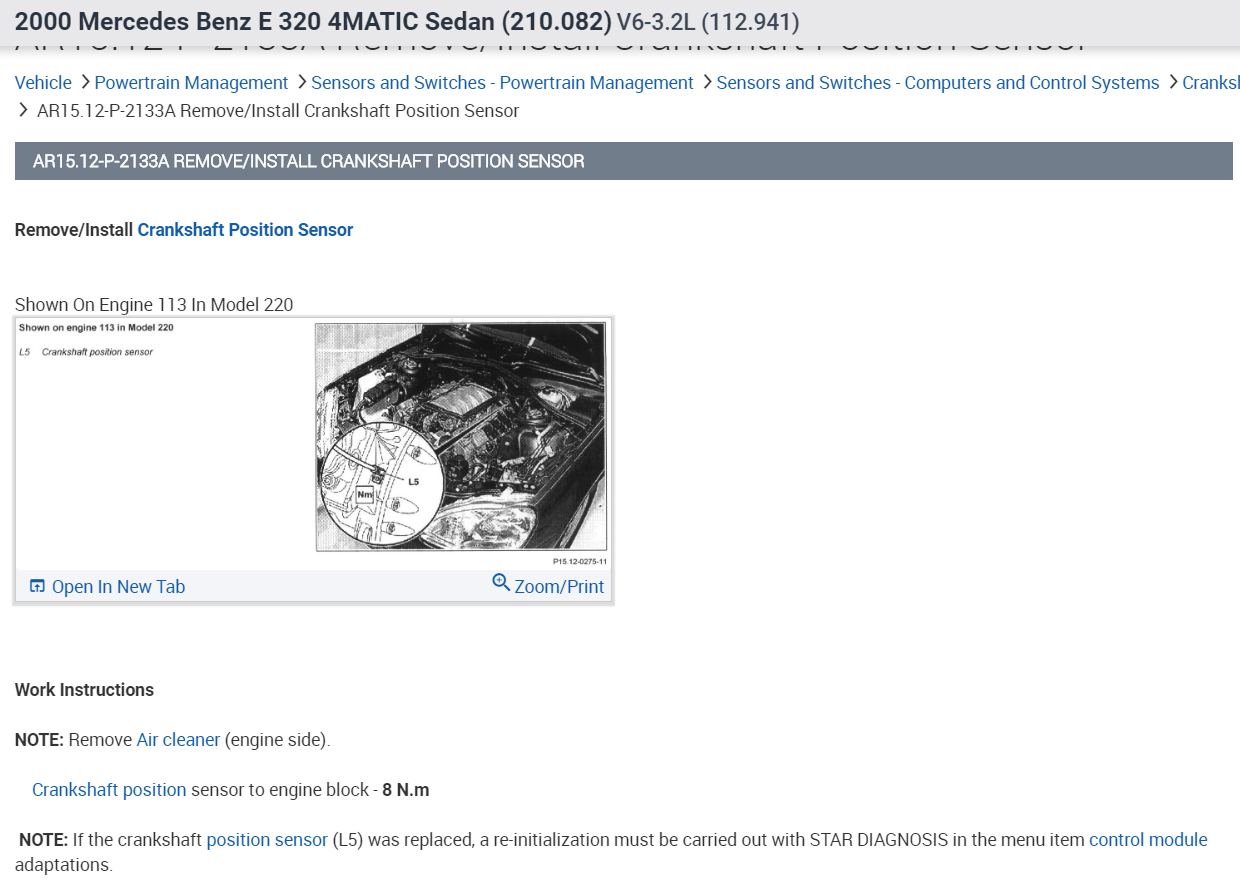

Most of the time testing the crankshaft sensor will not help and the computer cannot tell as well. But can I ask if you ran the codes? if not here is a guide to help:
If no codes here is the location of the crankshaft sensor. Check out the diagrams (below). Please let us know what you find. We are interested to see what it is.
