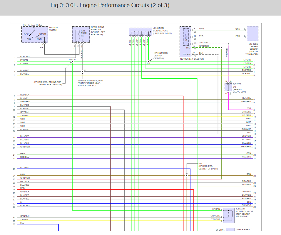

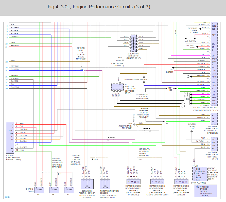

Engine starts runs about ten minutes then shuts off code reader shows p1300.
Aug 10, 2018 at 8:10 AM

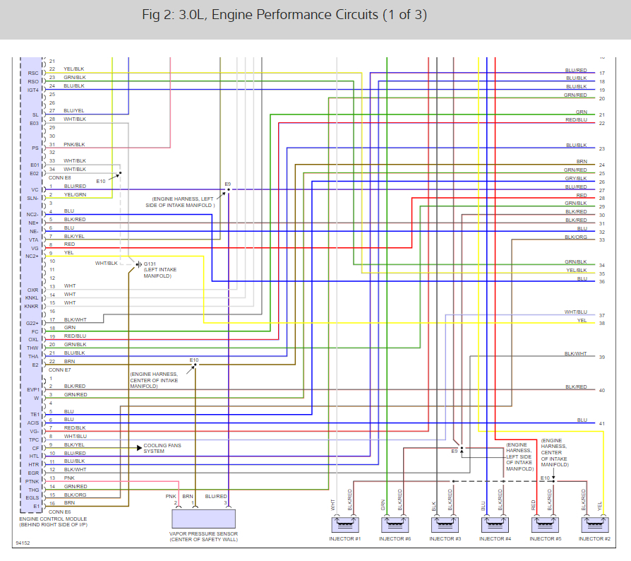

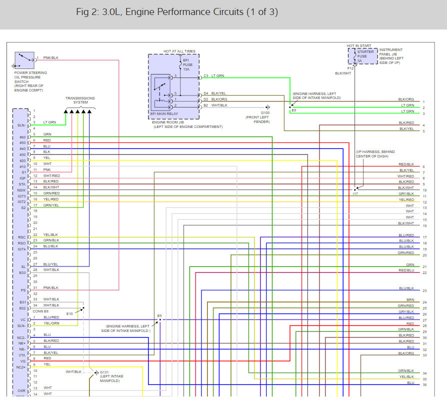

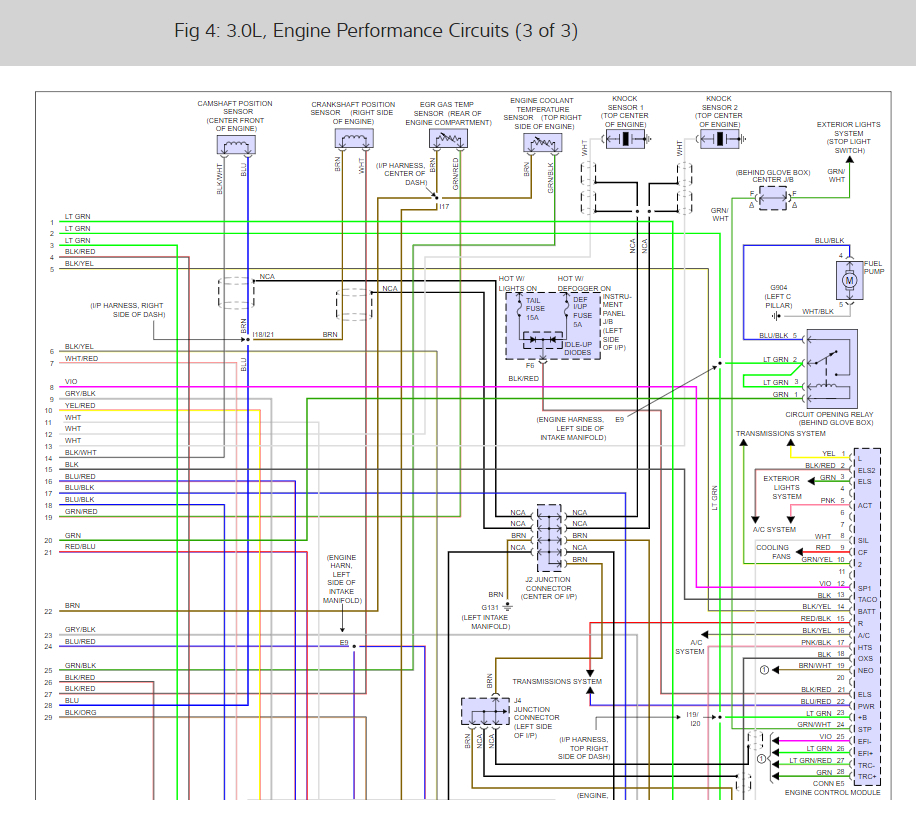

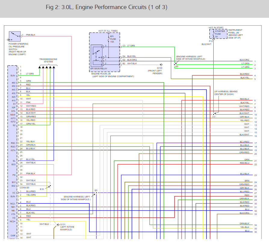

This code it for the ignition igniter problem. Here is the location so you can change it out and check the connections for corrosion. The igniter is located at the left rear of the engine compartment. Here is the engine wiring diagrams so you can see how the system works and the color wires going into the igniter.
