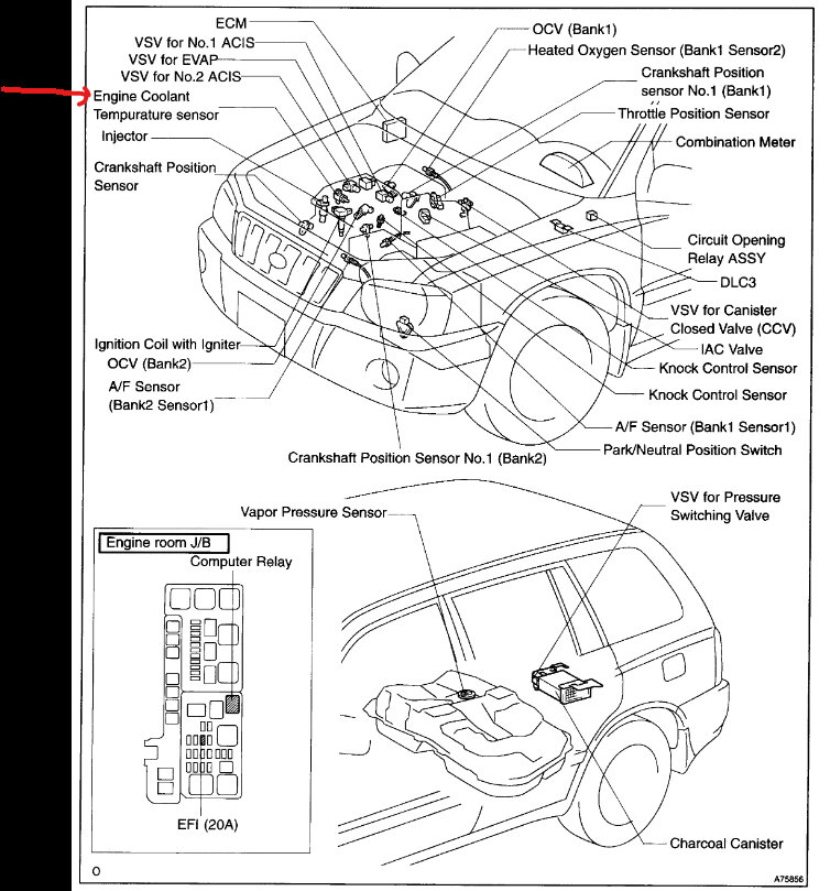

Do you have any codes? Here is how to get the codes which can help us fix it, I have seen the engine coolant temperature sensor short out and cause this problem as well.
This guide can help as well:
https://www.2carpros.com/articles/comprehensive-guide-reasons-why-a-car-engine-wont-run-when-hot-and
Here is the location of the engine coolant sensor, if you unplug it when the engine is hot, and it starts up for sure the coolant sensor is the problem. Check out the images (below). Please let us know what happens.
