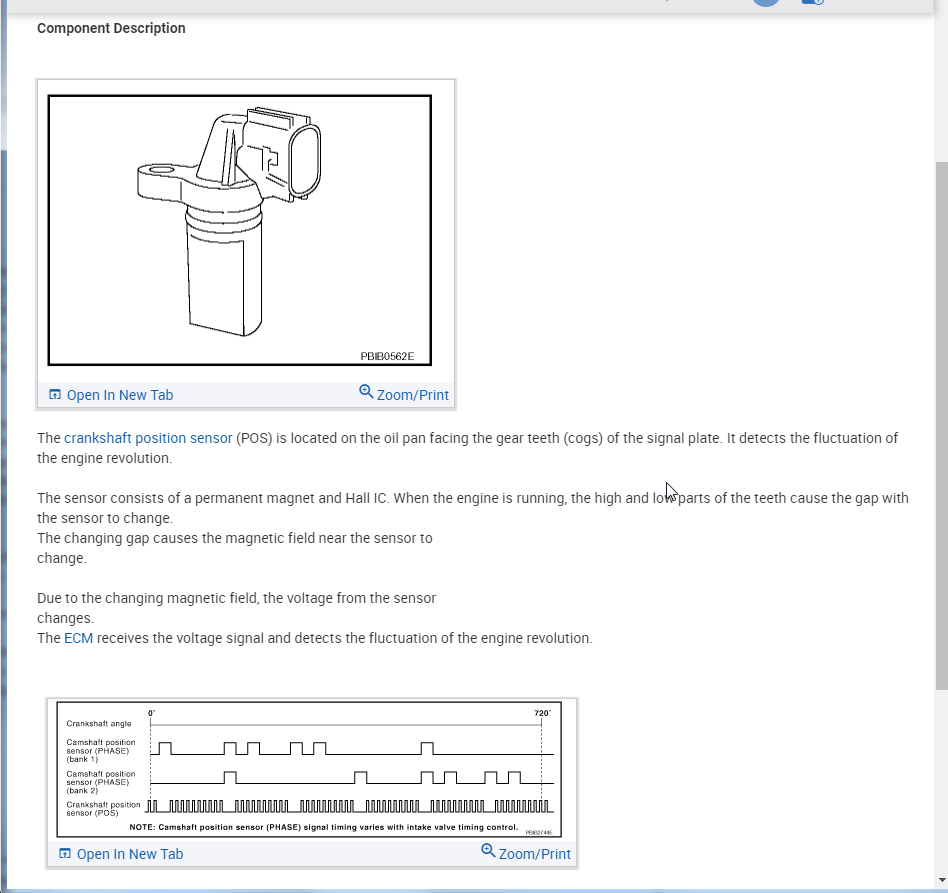

This sounds like a crank sensor issue. We need to do a couple things. First check for codes to see if there is anything else there that would point us in a different direction.
If not, when it stalls, we need to check for spark by pulling a plug and holding it against the block and crank the engine to see if there is a spark when it is cranking. If not then I would go with the crank sensor and see what happens.
