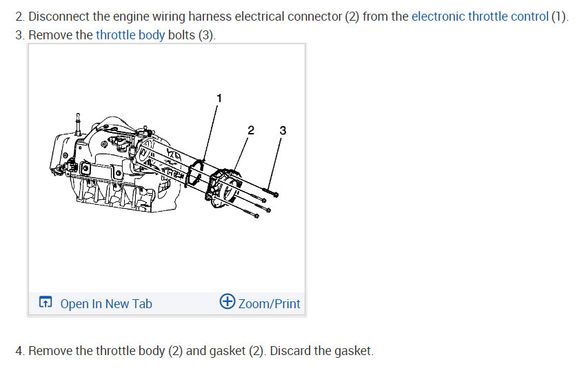

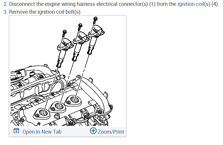

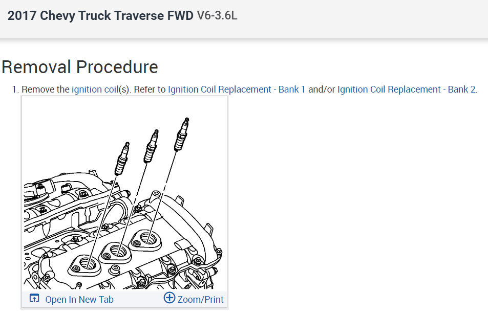

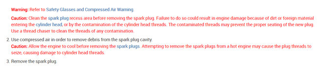

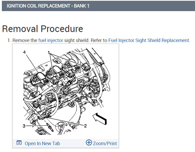

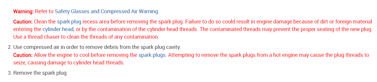

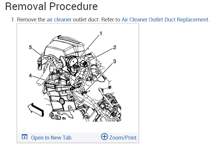

Here is how to change the spark plugs and coils out which I would do. I would also service the throttle body which needs to be done at the time of the tune up.
The spark plug is typically an ACDelco 41-114 or ACDelco 41-162.
