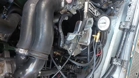

Fuel Pressure : 35 psi was 15 replaced fuel pump with New one

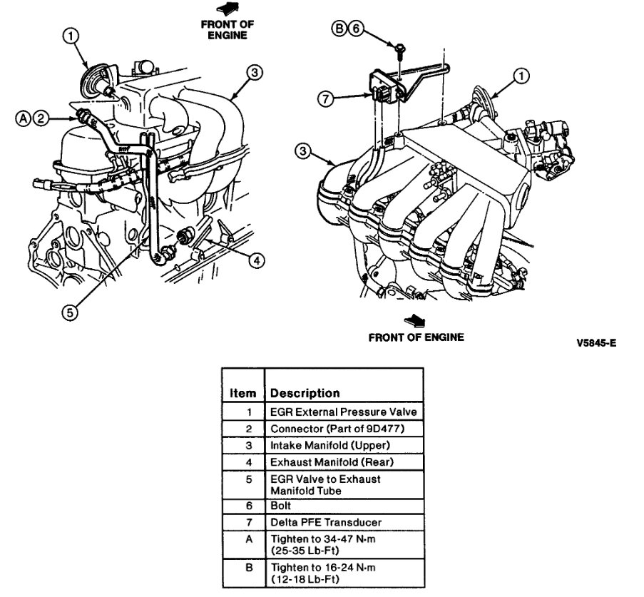

Here is the location of the EGR valve for your truck, check out the images (below). Please let us know what happens.

the EGR is brand new, and all the valves are lapd and polished all clean and i tested them for leaks no leaks is it possible that the EGR could just be faulty in general even if new? or maybe other issues? that motor is different than mine i have a 96 ford f150 5.0 v8 302.
