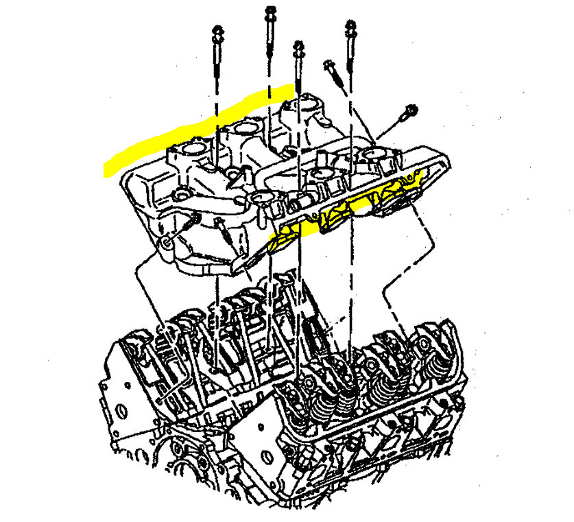

Tom,
When you check for the leak, pay special attention around the intake manifold gasket. They are known to leak. Note there is an upper and a lower intake. The only pic I could find was the intake being removed. I highlighted the areas to check.
