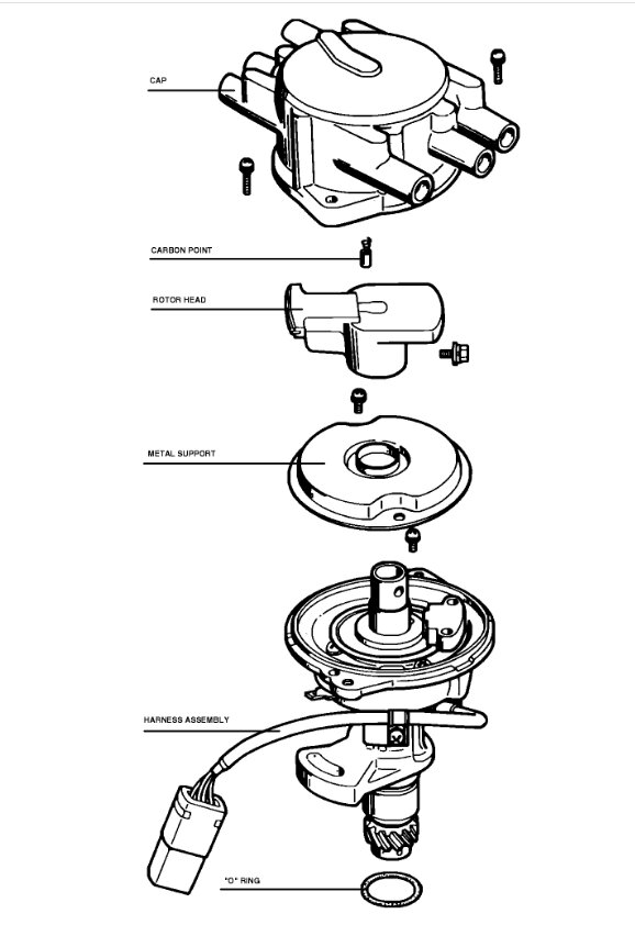

The water on your hand is normal, I would replace the distributor cap and rotor, I have seen them crossfire and cause the problem you are describing. Also, I would replace the spark plug wires as well. Check out the images (below). Please let us know what happens.
