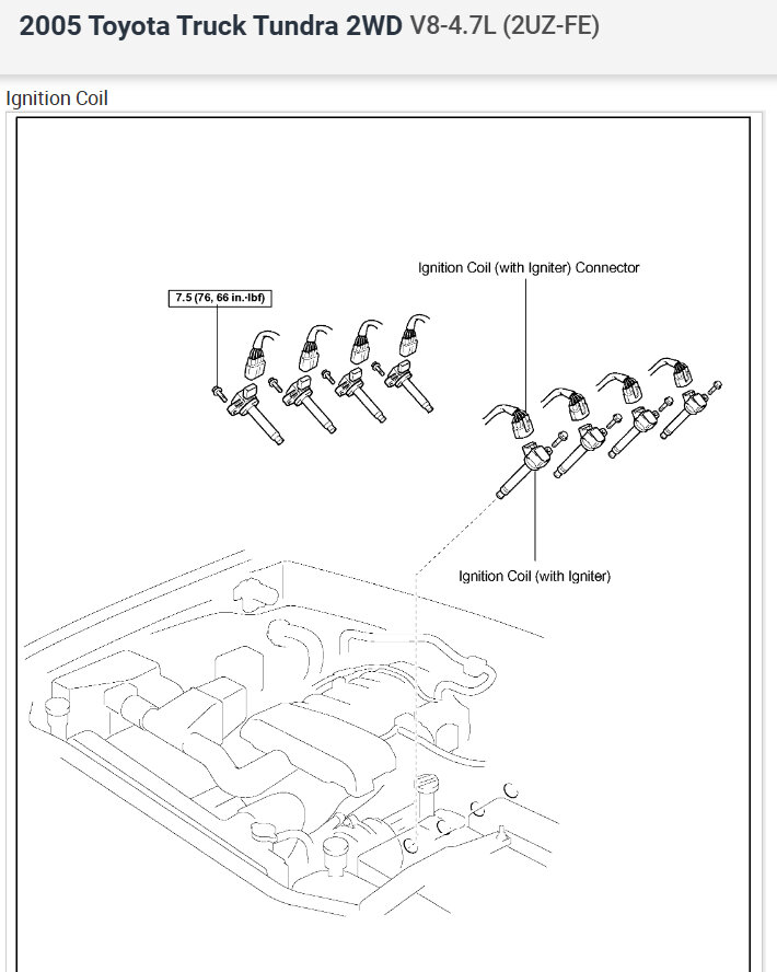

I purchased new spark plugs (NGK (4589) IFR6T-11 Laser Iridium Spark Plug) now it's throwing multiple misfire codes P0300, P0302, P0304, and P0308.
Wrong plug? Gap? Old plugs were worn and black.
