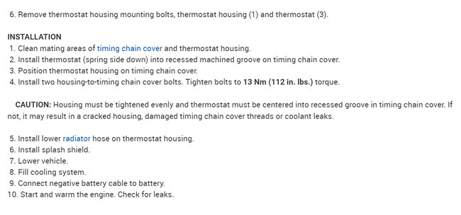

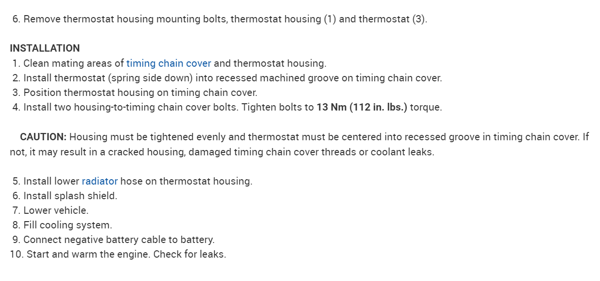

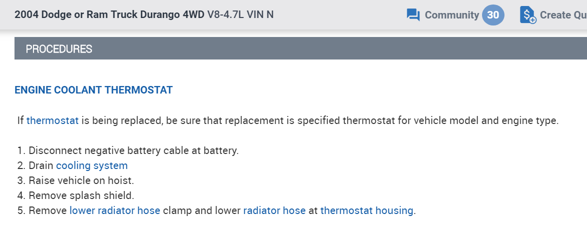

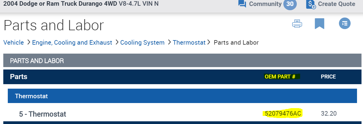

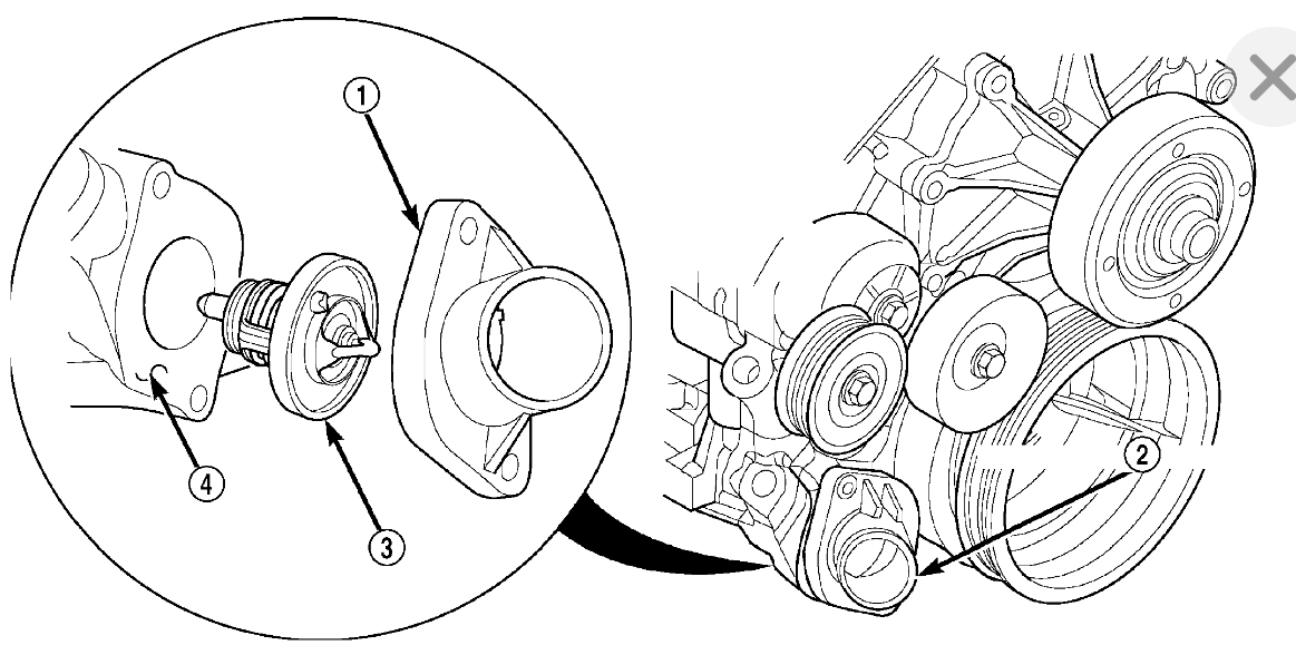

In the diagrams down below I have also included the Original Equipment Manufacturer (OEM) part number for your vehicle's thermostat as well as the directions for the removal and installation of the thermostat. Please go through these guides and get back to us with how everything turns out, or what you are able to find out.
