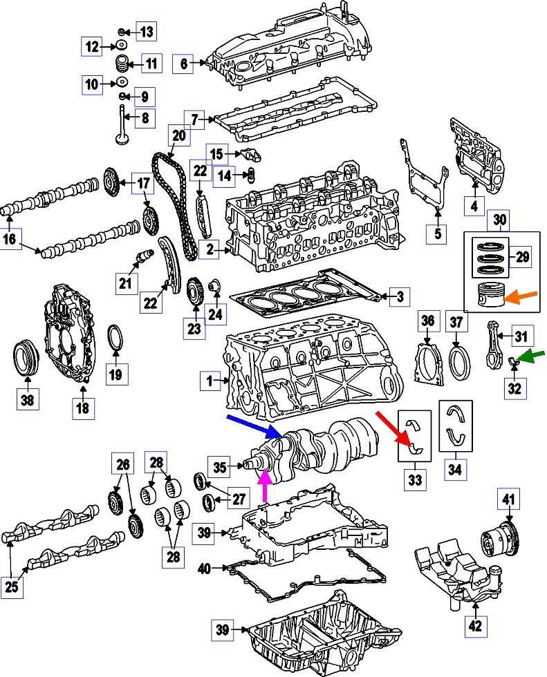

I don't see your model listed in my online service information, but I did find a 2.1L diesel engine in a model E250. I only posted this drawing to give you some reference as to what will be done with your engine. Item # 33, (red arrow), is one of the pairs of crankshaft bearings. Each pair is clamped around a crankshaft journal, (pink arrow), and the "clearance", or space between them is measured in thousandths of an inch. That's the space where pressurized oil is forced in to prevent metal-to-metal contact. Those bearings are made of three layers of metal. The first layer is very soft so particles of dirt or metal will embed in them rather than gouge and damage the highly-polished surfaces. It's that layer your dealer found to be worn away. The next layer is a darker color so it's easy to identify.
Similarly, item # 32, (green arrow), shows half of one of the four connecting rod bearings. There is also a tight clearance between those bearings and the journals they ride on. The blue arrow is pointing to one of those journals.
Item # 29 shows one piston assembly. The orange arrow is pointing to the skirt. That rides on the cylinder wall and holds the piston straight. Most often these pistons are "cam ground", meaning they're slightly oval in shape. When the engine reaches normal operating temperature, they expand nonlinearly to turn into a nice round piston that fits just right with the proper amount of clearance. Being slightly too small when they're cold, they can rock or slap causing a very slight noise that goes away after warmup. That's considered normal and is more noticeable on some models; less on others. You'll never hear that little noise over the normal rattling sound diesel engines produce.
