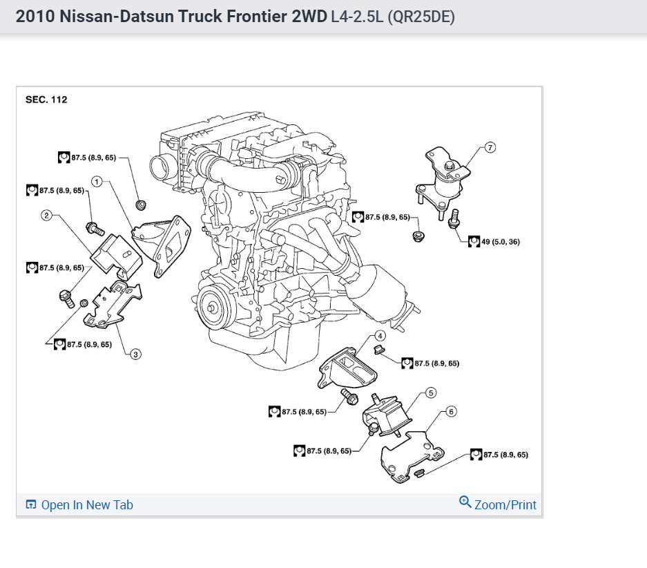

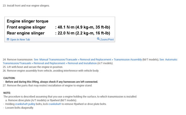

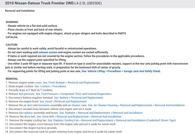

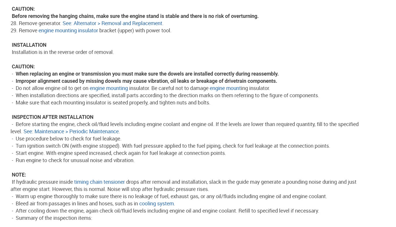

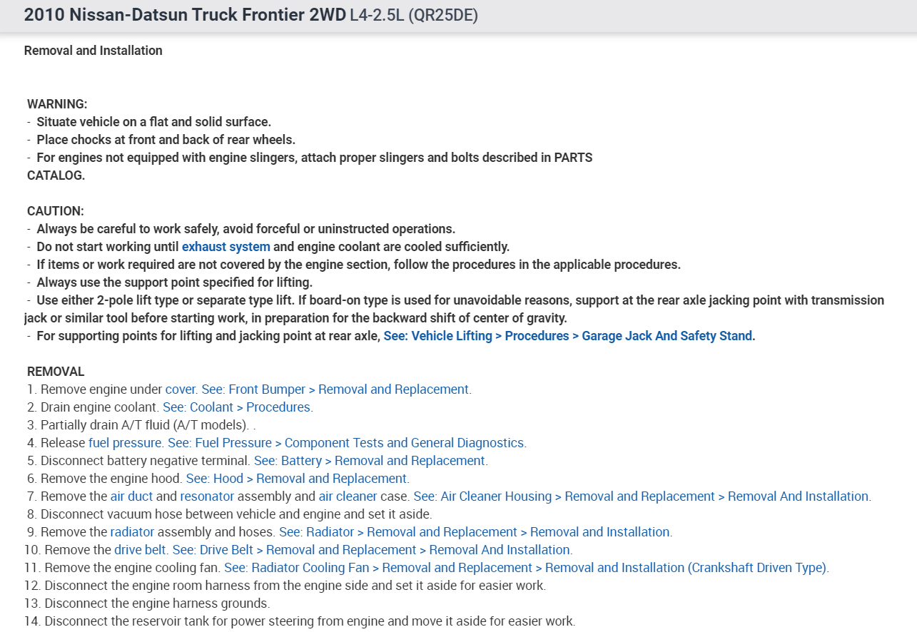

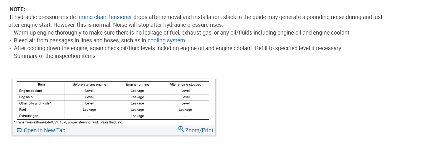

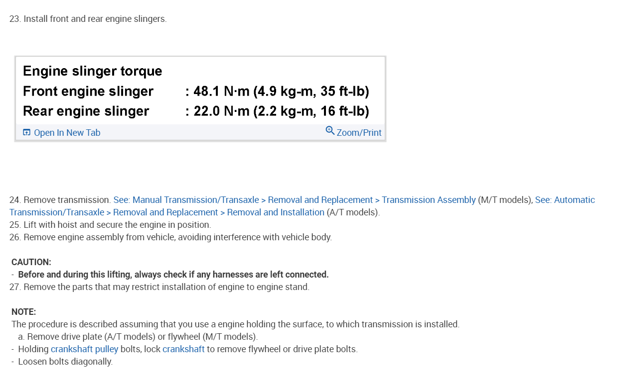

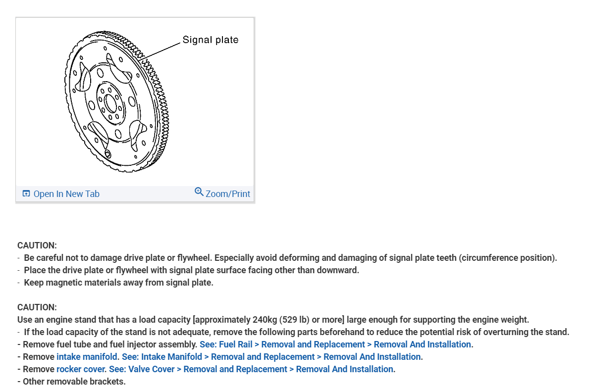

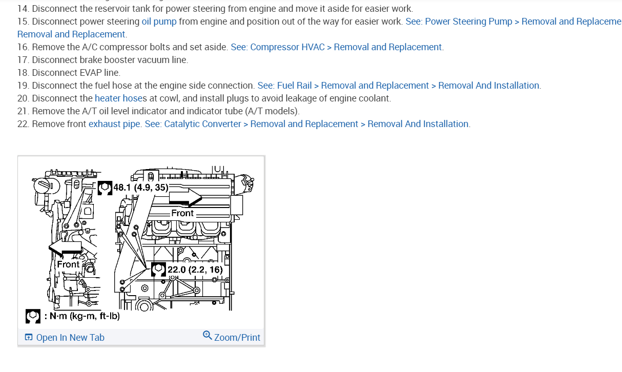

I am sorry we do not have a video, but I did find the instructions on how to do the job in the images below. Check out the images (below). Let us know what happens and please upload pictures or videos of the problem so we can see what's going on.
