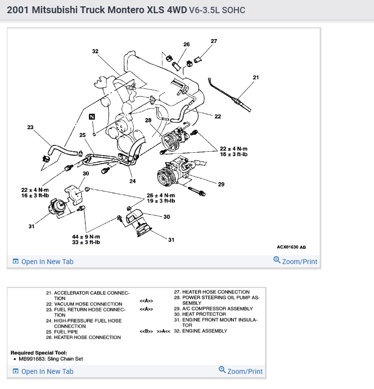

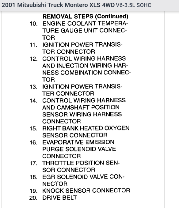

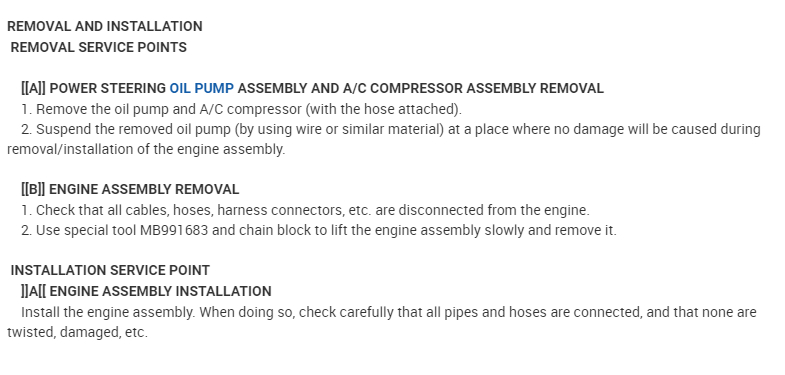

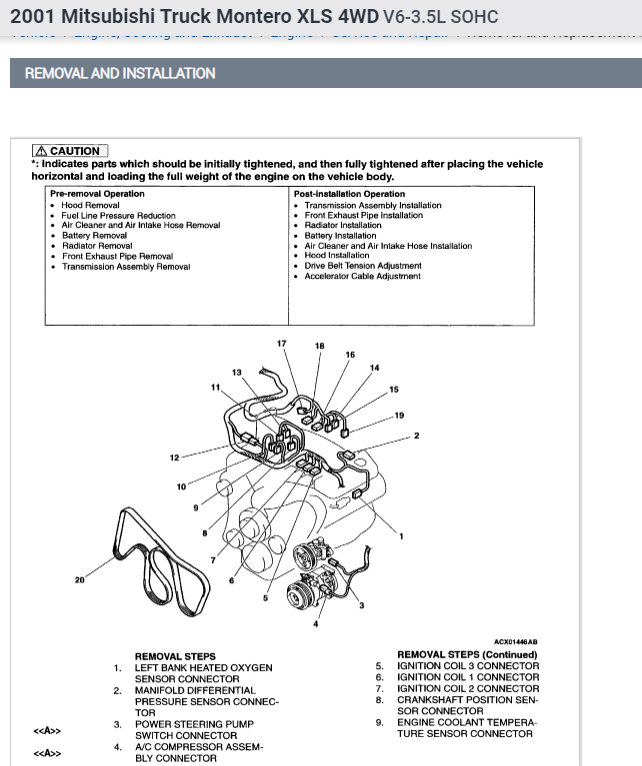

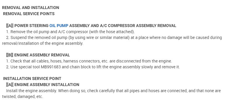

Both the 2001 and 2002 Montero uses the same 3.5L V6.
So as long as both of the vehicles have the 3.5L (not the 3.0 Montero Sport), it will work.
I have attached the engine replacement steps below for your reference.
Let me know of any questions.
Thank you.
