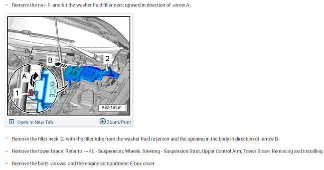

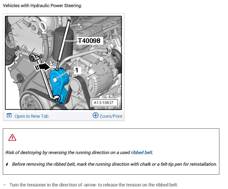

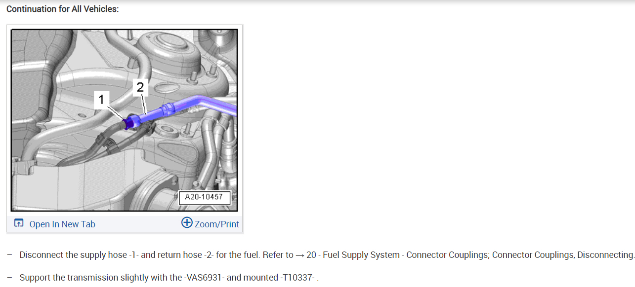

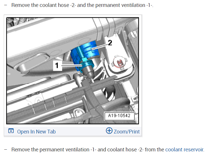

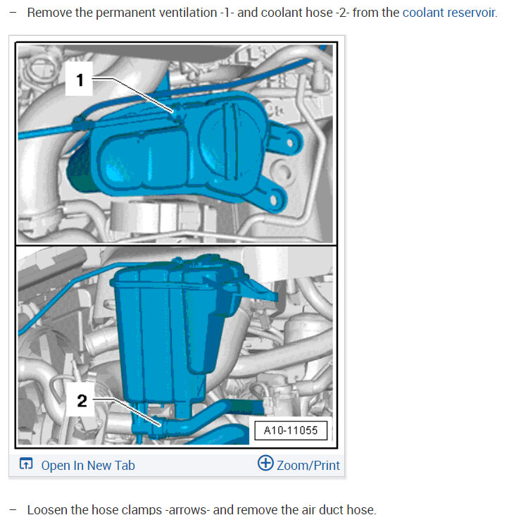

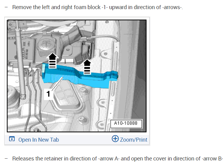

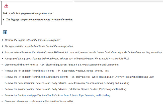

I have an engine replacement coming up soon on the vehicle listed above 3.2 and I've been searching forums and trying to figure out the most efficient/faster way to replace the engine i looked at the manual and it said out the bottom and i also saw remove the front bumper has anyone done this before?
