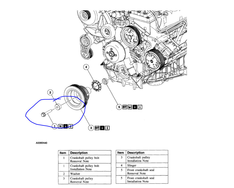

Okay I bought a stand. Everything is off except the mounts and the torque converter bolts. How do I turn the flywheel to access the bolts?

You need to turn the crankshaft with the bolt on the harmonic balancer. Turn it until each nut shows and remove the nuts. There are 4 of them to release the torque converter.

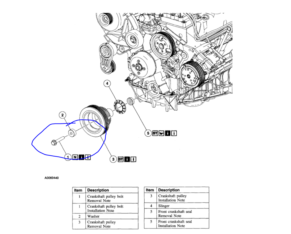

My harmonic balancer is sitting on my kitchen table. I had to take it off to take my timing cover off to fix the chain guide only to find out it's the rear chain guide.

You can reinstall the bolt to the crankshaft that holds the balancer on. Then turn the engine.
