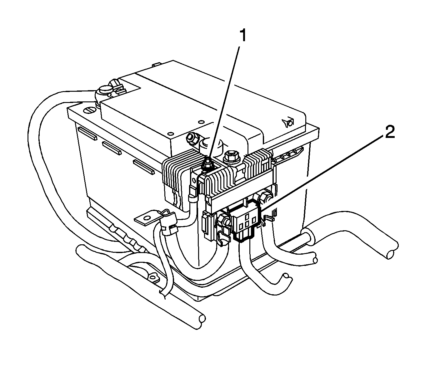

1. Remove the battery and battery tray. Refer to Battery Tray Replacement See: Battery Tray > Removal and Replacement > Battery Tray Replacement.

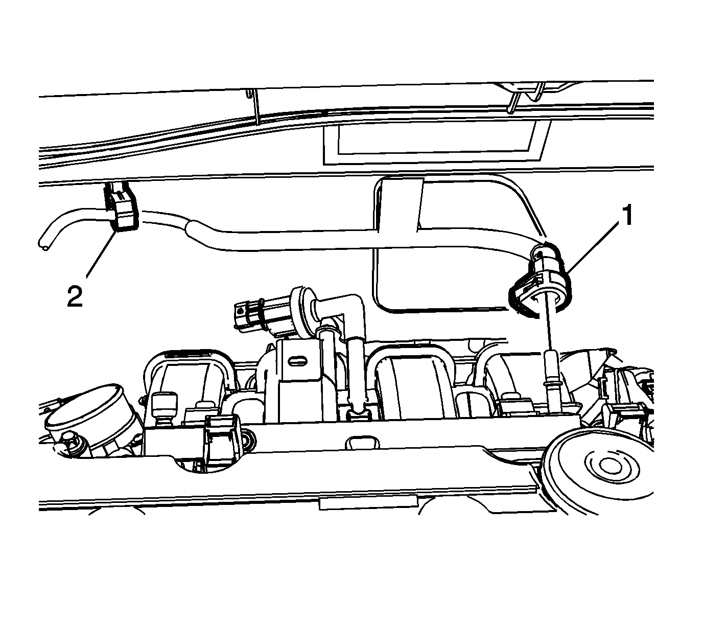

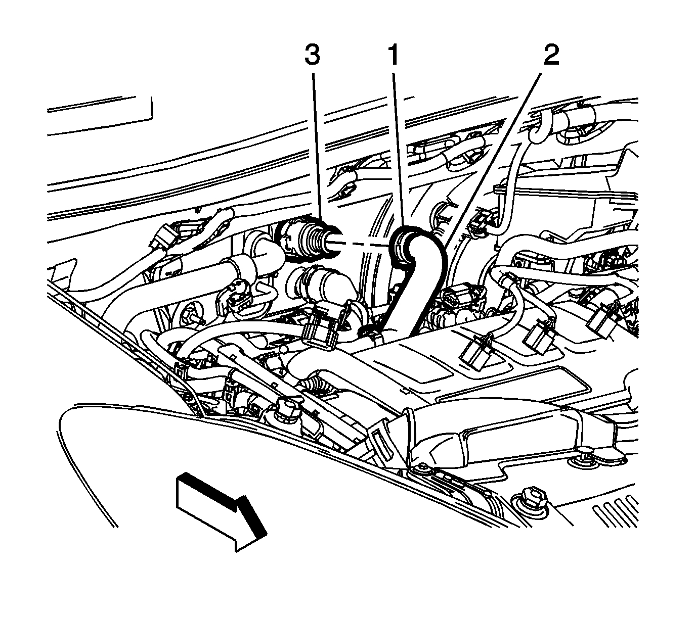

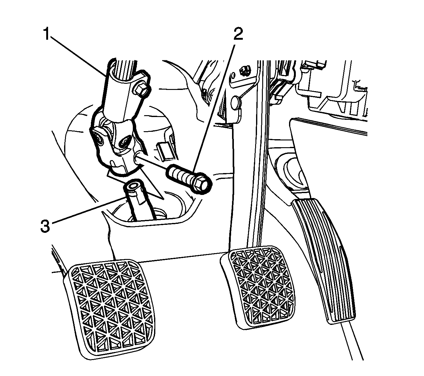

7. Remove the lower intermediate steering shaft bolt (2) and slide the shaft away from steering column. Refer to Intermediate Steering Shaft Replacement (NJ1) See: Steering Shaft > Removal and Replacement > Intermediate Steering Shaft Replacement (Non-Variable Ratio, Electric)Intermediate Steering Shaft Replacement (N40) See: Steering Shaft > Removal and Replacement > Intermediate Steering Shaft Replacement (Non-Variable Ratio).
pic 2

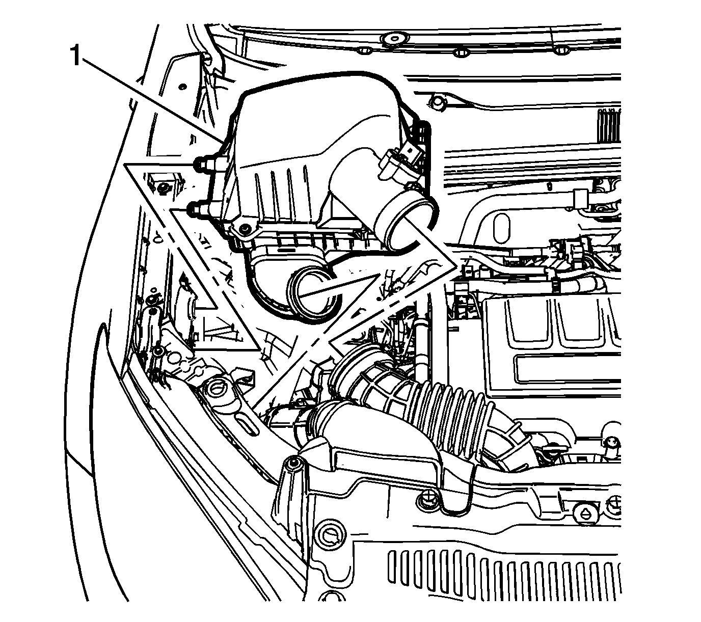

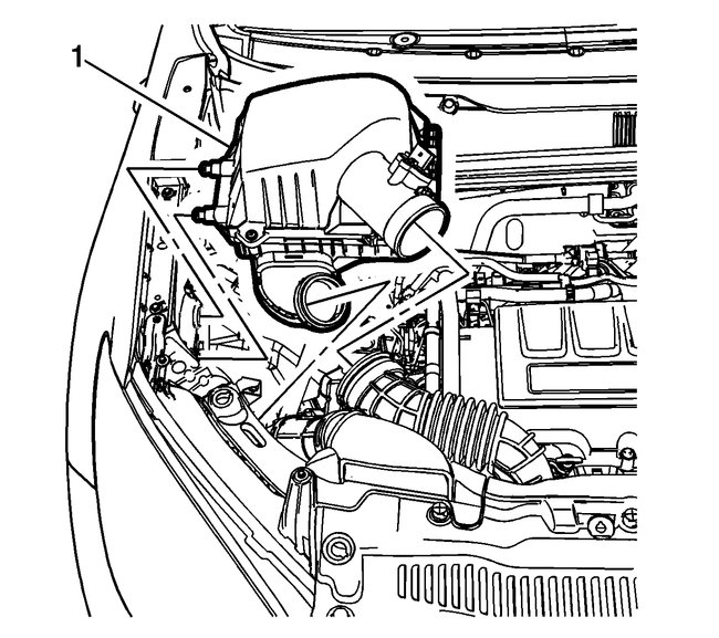

8. Remove the air cleaner assembly (1). Refer to Air Cleaner Assembly Replacement See: Air Cleaner Housing > Removal and Replacement > Air Cleaner Assembly Replacement.
pic 3

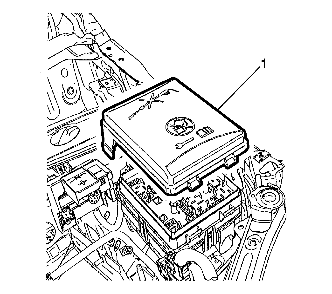

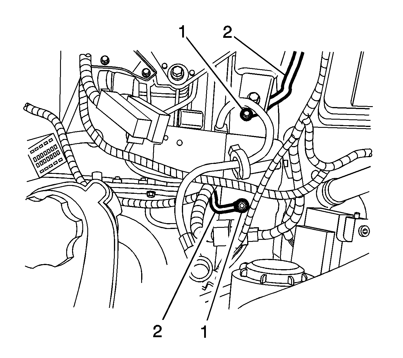

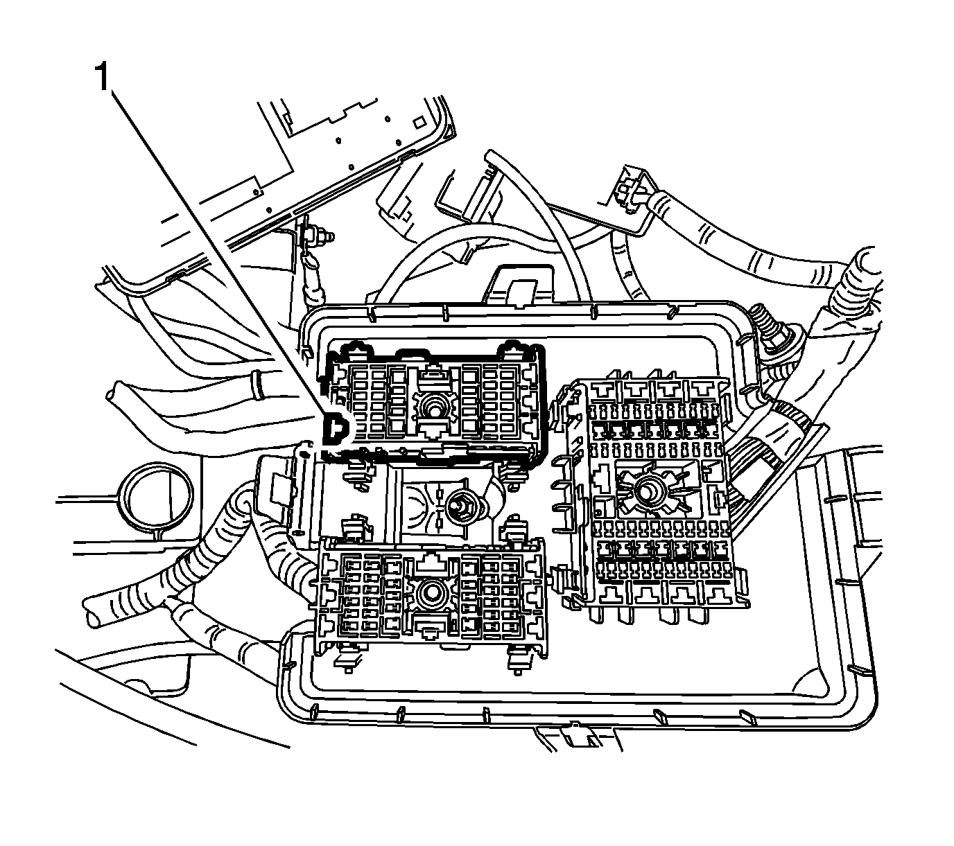

9. Remove the junction block cover (1).
pic 4

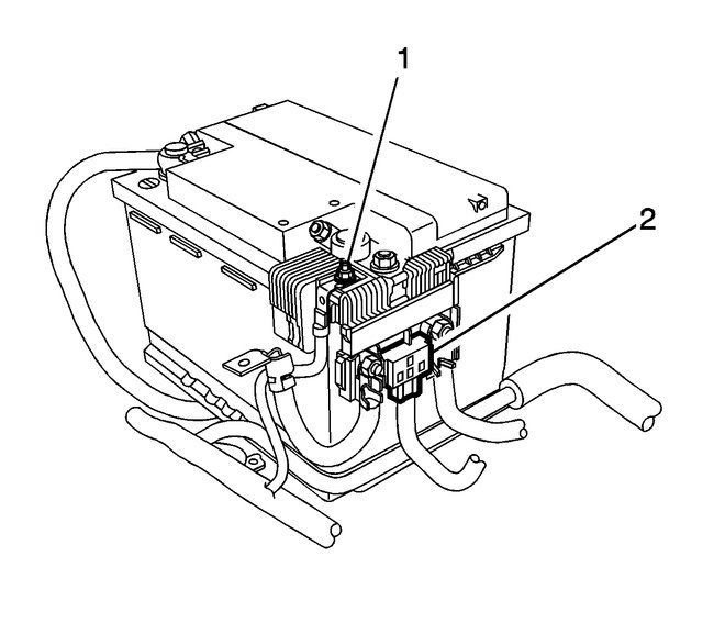

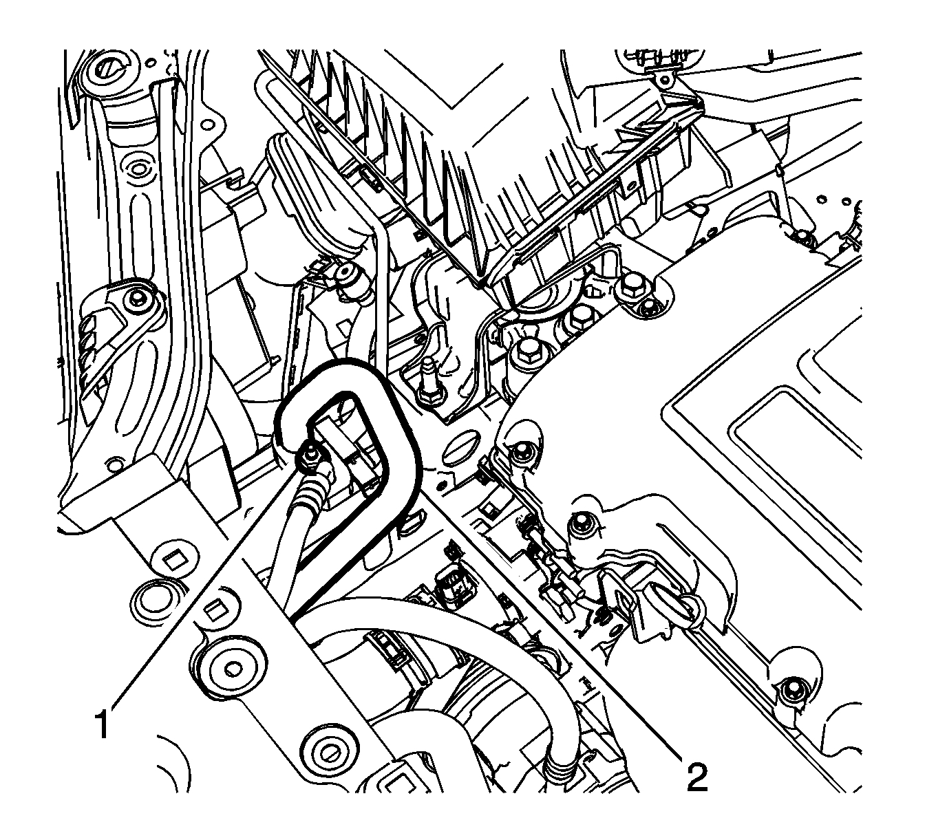

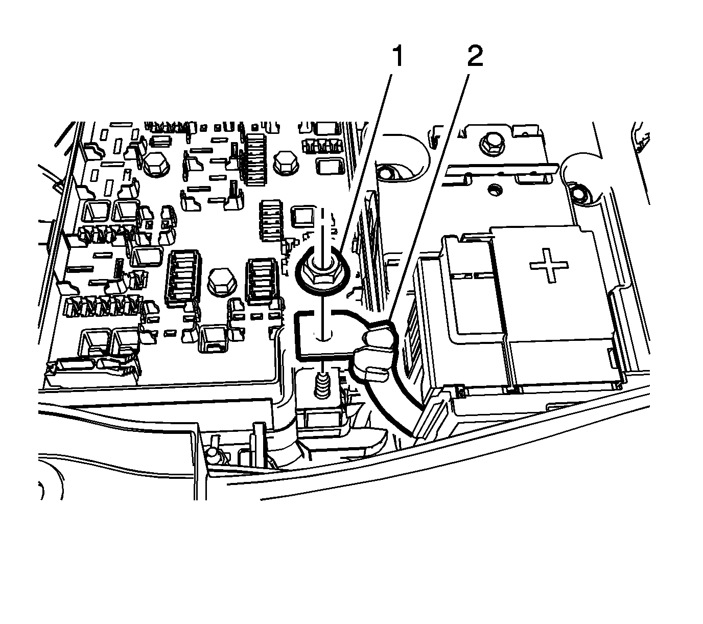

10. Remove the positive battery cable nut (1) from the junction block.
11. Remove the positive battery cable (2) from the junction block.
pic 5
12. Remove the positive cable nut (1) and battery positive cable from the battery positive cable junction block.
13. Disconnect the body wiring master harness connector (2) from the battery positive cable junction block.

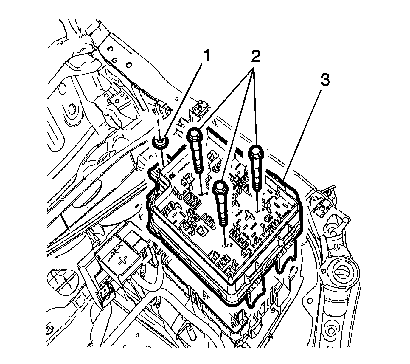

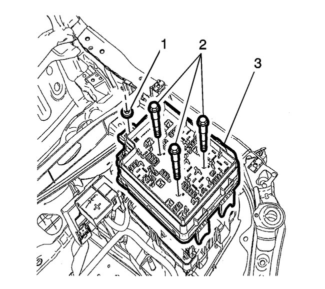

14. Remove the junction block nut (1).
15. Remove the junction block bolts (2).
16. Disconnect the wiring harness from the junction block base.
17. Remove the junction block (3) from the base.
18. Disconnect the wiring harness plug from the front compartment fuse block.

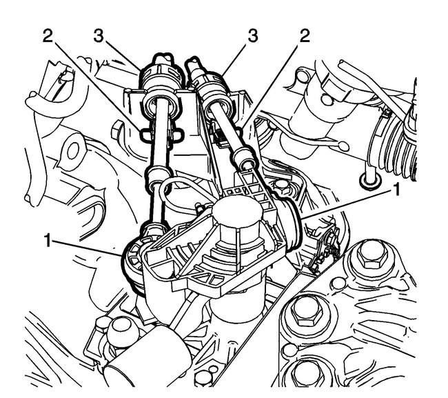

24. If equipped with an automatic transmission, disconnect the transmission range selector lever cable terminal (1) from the transmission manual shift lever pin.
25. Remove the transmission range selector lever cable (2) from the cable bracket.

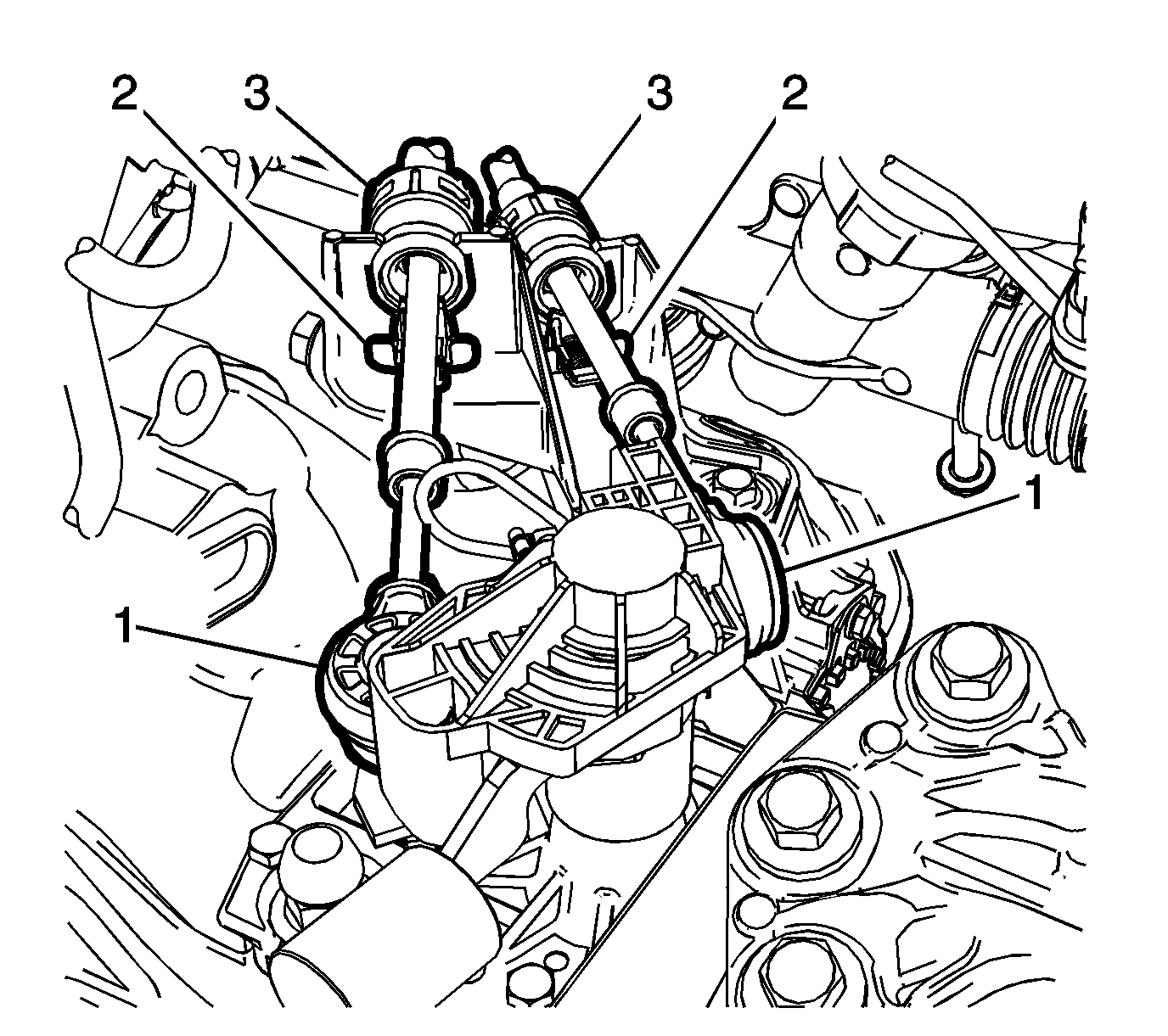

26. If equipped with manual transmission, disconnect the shift lever and selector lever cable end (1) from the transmission shift lever and selector lever.
27. Pull the cable retainers (2) to release the shift lever and selector lever cable from the shift lever and selector lever cable bracket.
28. Disconnect the shift lever and selector lever cable from the shift lever and selector lever cable bracket.
pic 12

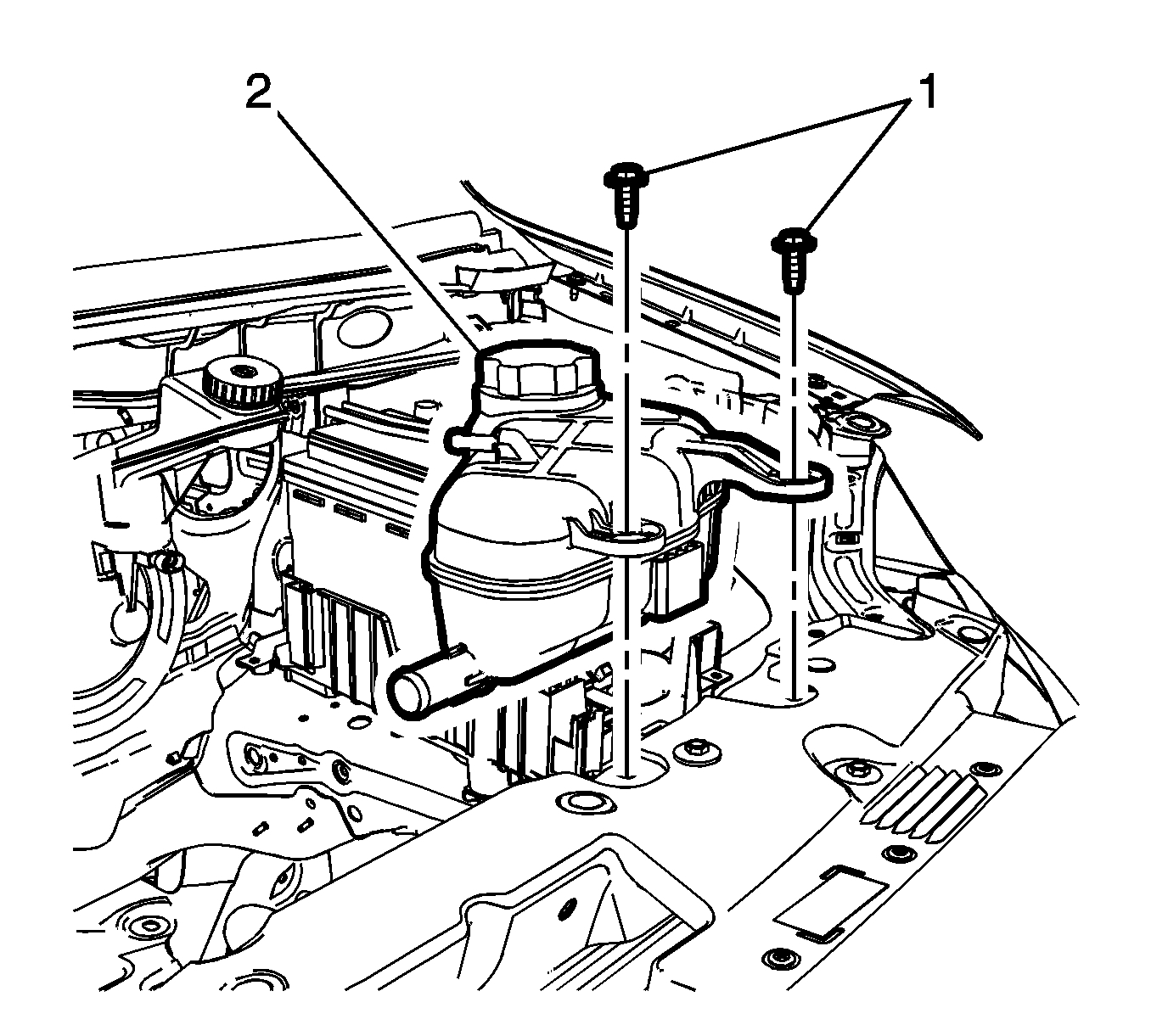

29. Remove the radiator surge tank (2) and position aside. Refer to Radiator Surge Tank Replacement (LUV, 2H0, LUJ) See: Coolant Reservoir > Removal and Replacement > Radiator Surge Tank Replacement.

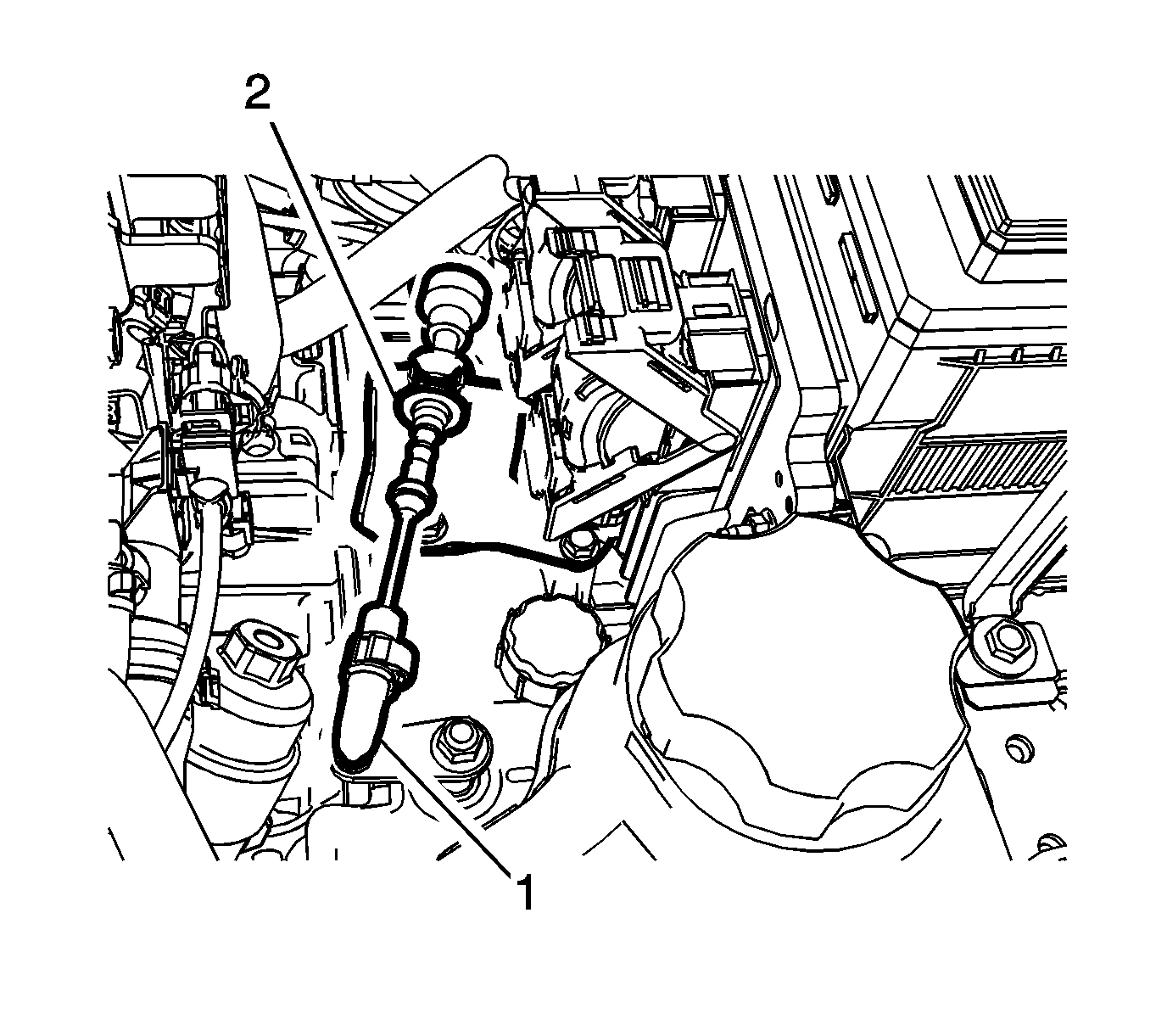

31. Remove air conditioning compressor and condenser hose nut (1).
32. Remove air conditioning compressor and condenser hose (2) from refrigerant hose.
pic 14

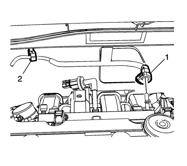

33. Disconnect the fuel feed pipe. Refer to Plastic Collar Quick Connect Fitting Service See: Coolant Line/Hose > Procedures > Plastic Collar Quick Connect Fitting Service.

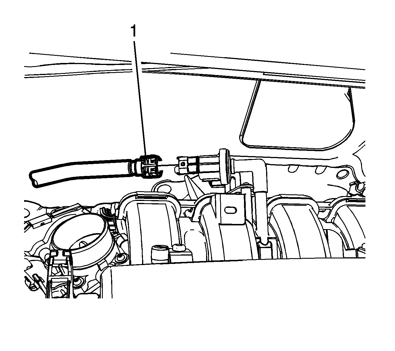

34. Disconnect the evaporative emission pipe (1). Refer to Plastic Collar Quick Connect Fitting Service See: Coolant Line/Hose > Procedures > Plastic Collar Quick Connect Fitting Service.
pic 16

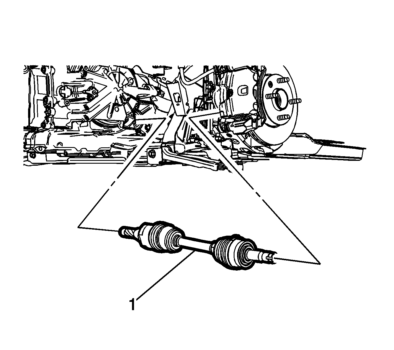

35. Remove the wheel drive shafts. Refer to Front Wheel Drive Shaft Replacement - Left Side See: Axle Shaft Assembly > Removal and Replacement > Front Wheel Drive Shaft Replacement - Left Side and Front Wheel Drive Shaft Replacement - Right Side See: Axle Shaft Assembly > Removal and Replacement > Front Wheel Drive Shaft Replacement - Right Side.

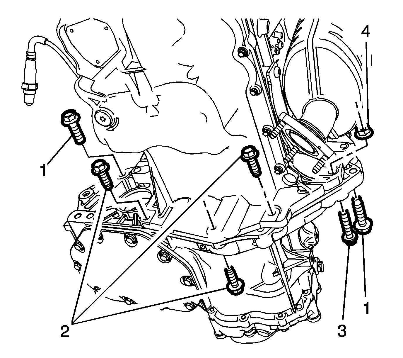

37. If equipped with an automatic transmission, remove the lower transmission nut (1) and the lower transmission bolts (2, 3, 4).
pic 18
38. If equipped with manual transmission, remove the lower transmission bolt (3) and nut (4).
39. Remove the lower transmission bolts (1, 2).
pic 19

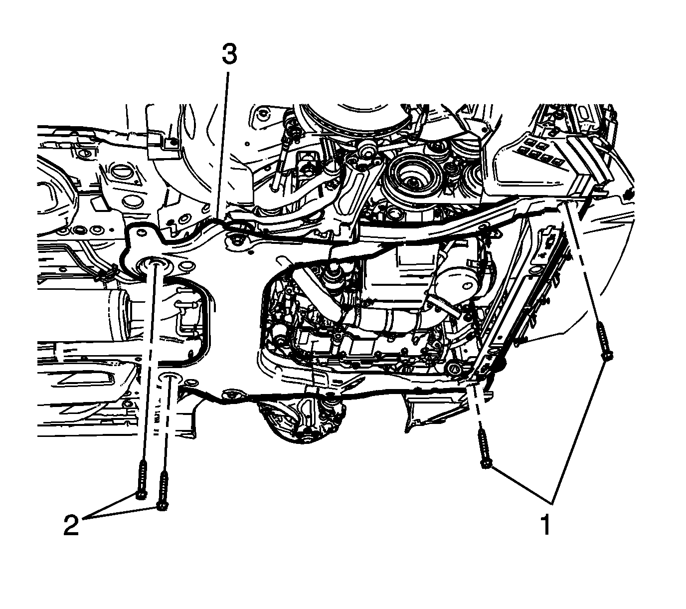

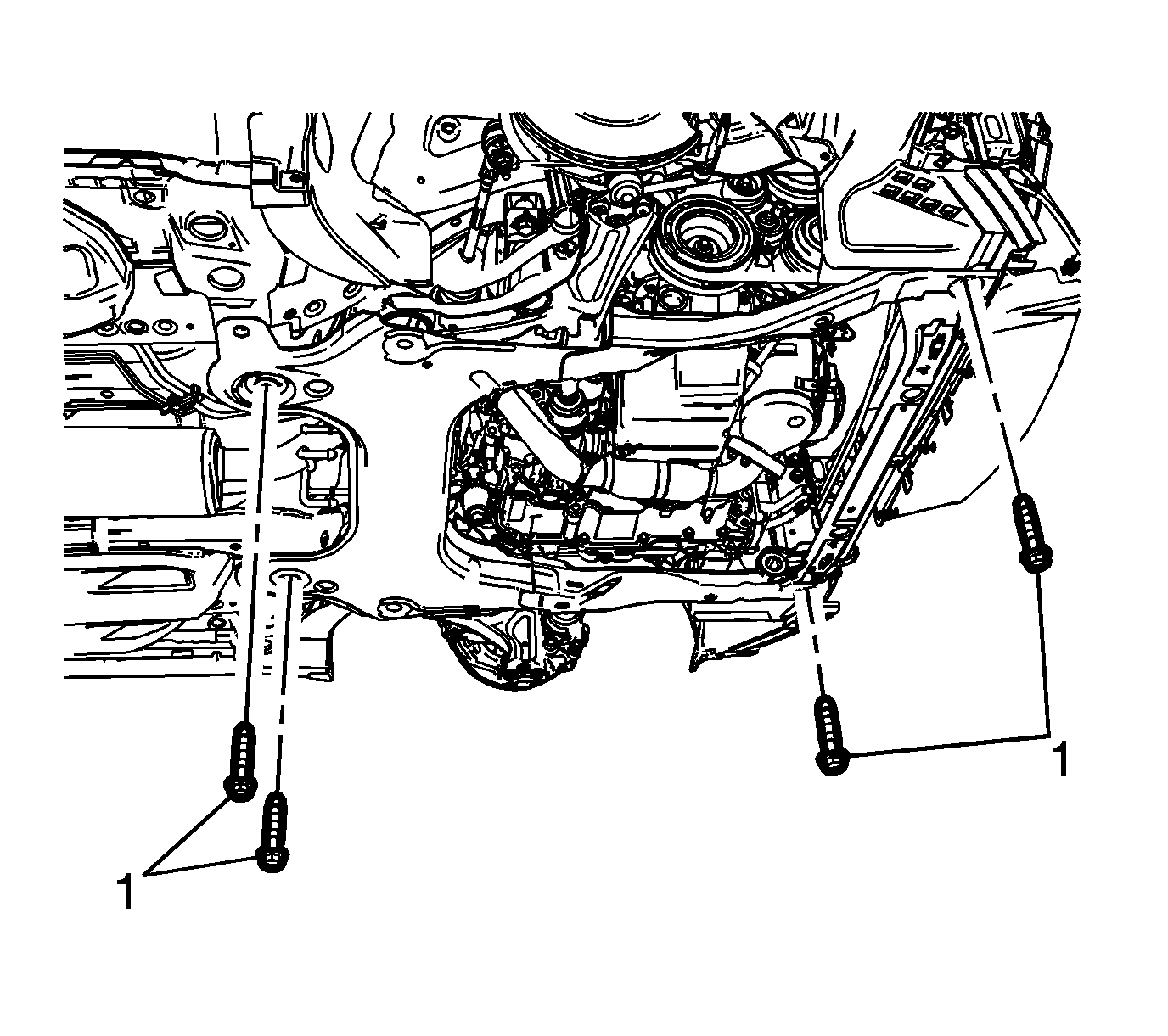

40. Remove the frame front bolts (1).
41. Position the lift table under the powertrain and support with blocks of wood.

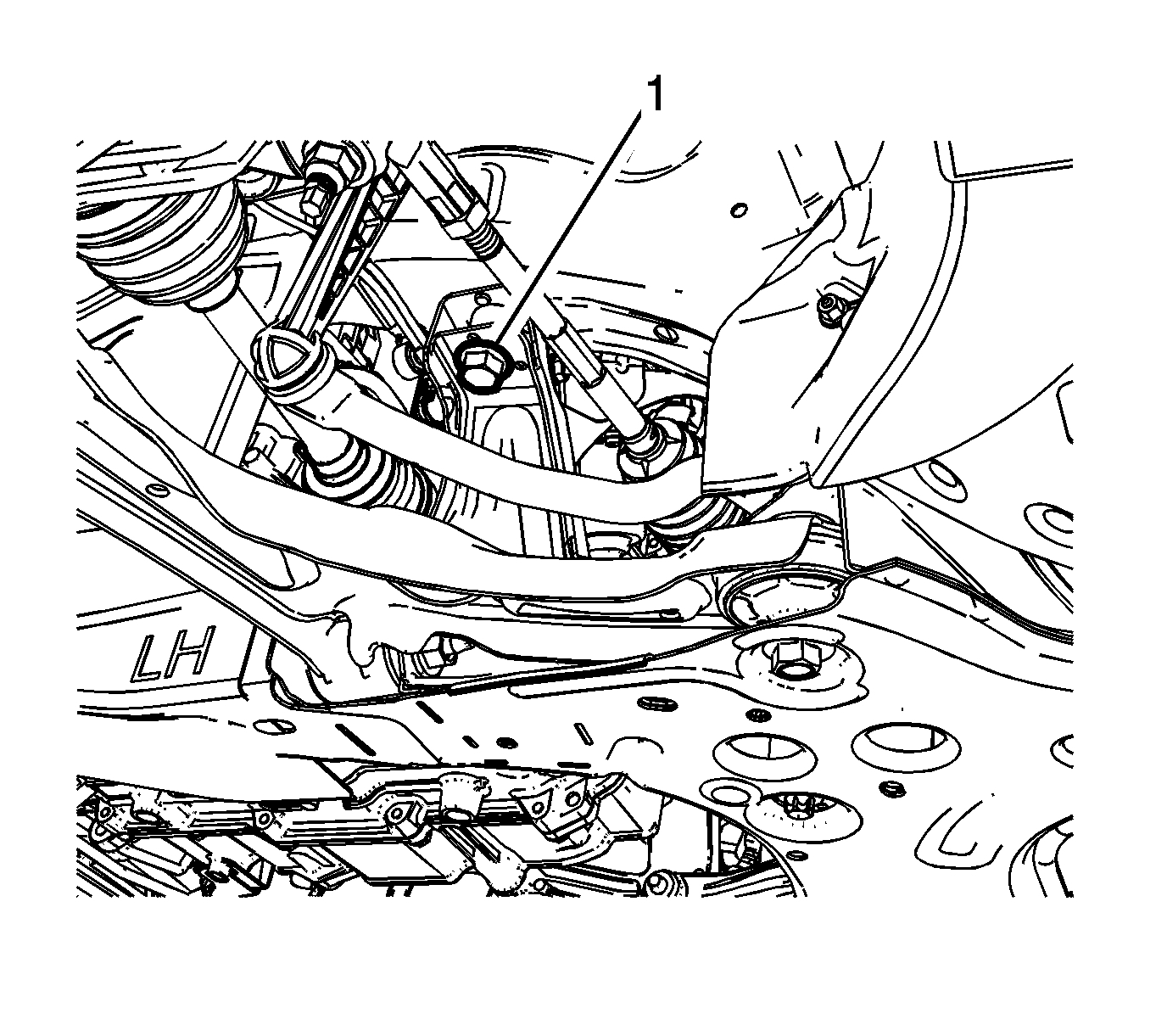

42. Remove the upper frame suspension retaining bolts (1) on both sides.

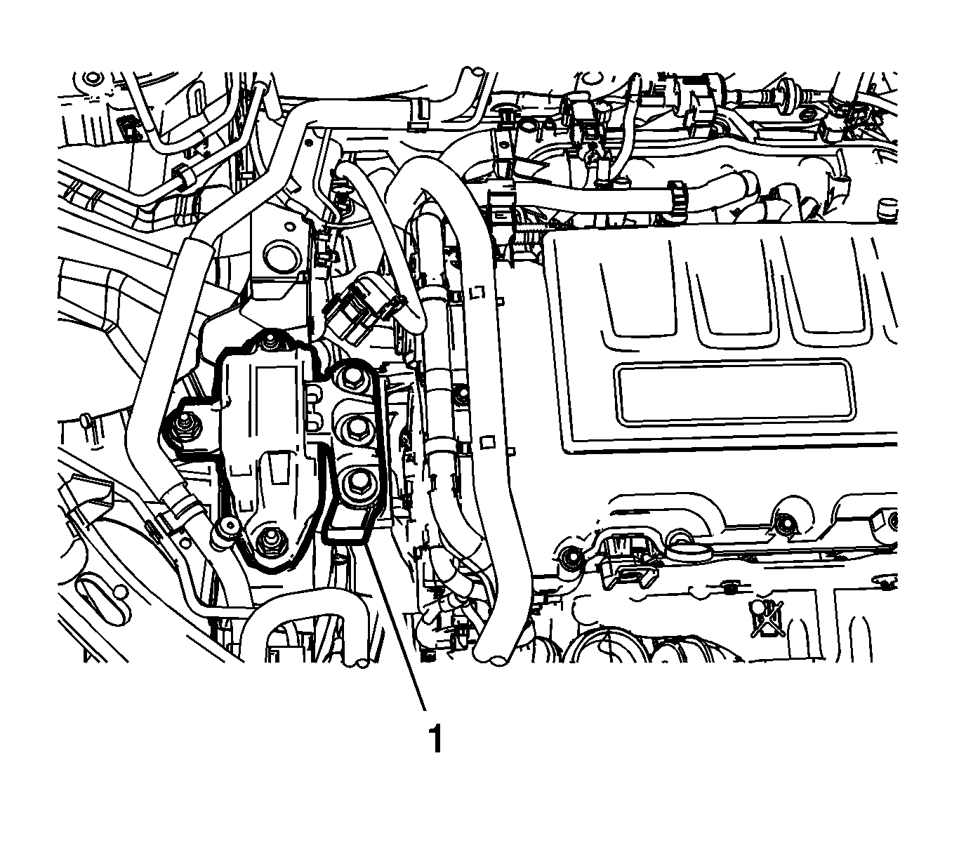

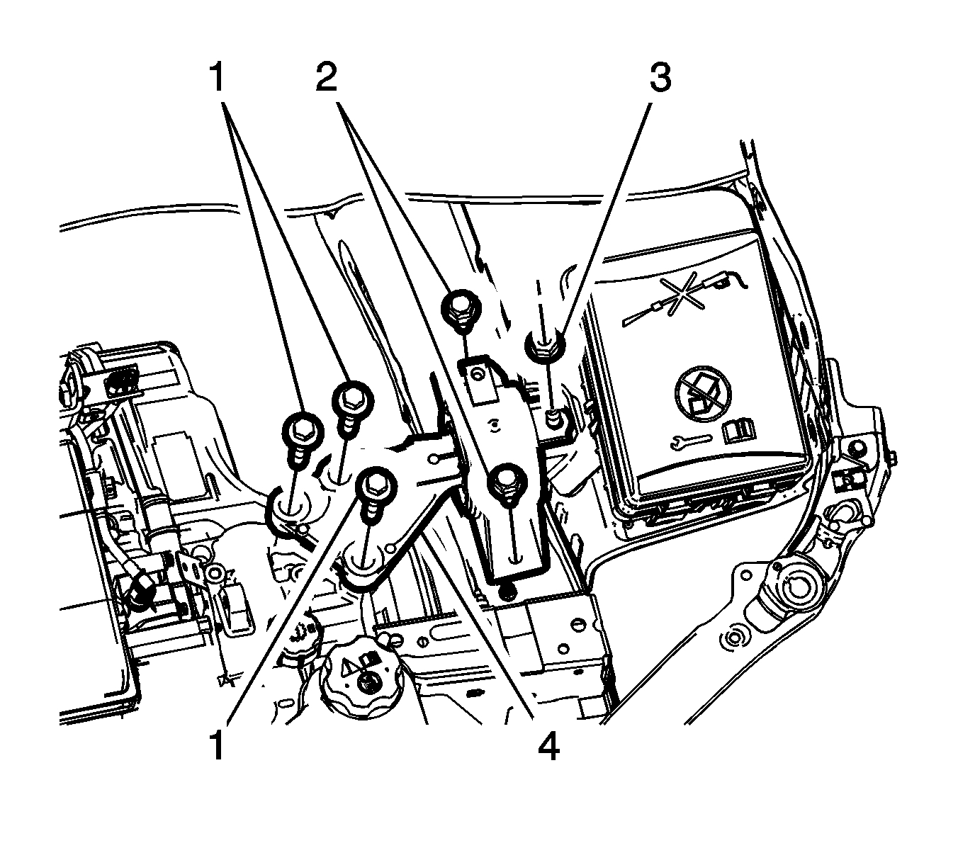

43. Remove the right side engine mount (1). Refer to Engine Mount Replacement - Right Side See: Engine Mount > Removal and Replacement > Engine Mount Replacement - Right Side.

44. Remove and DISCARD the transmission mount bolts (1) - left side. Refer to Transmission Mount Replacement - Left Side See: Automatic Transmission/Transaxle > Removal and Replacement > Transmission Mount Replacement - Left Side.

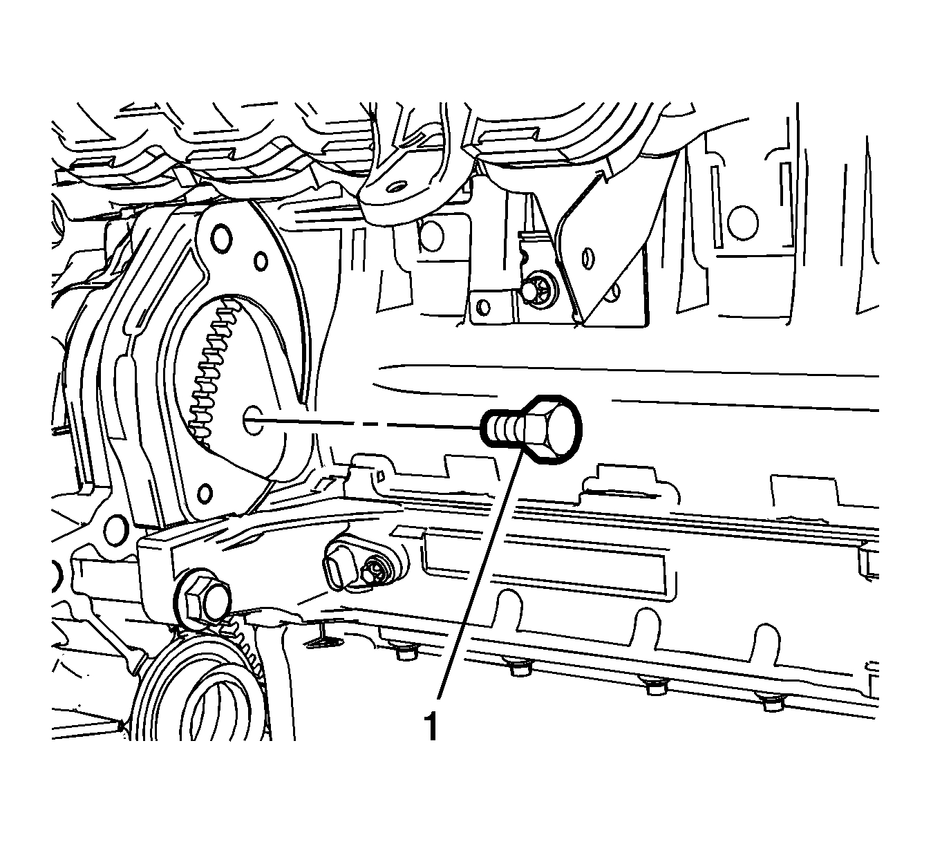

48. Mark the relationship of the flex plate to the torque converter for reassembly.

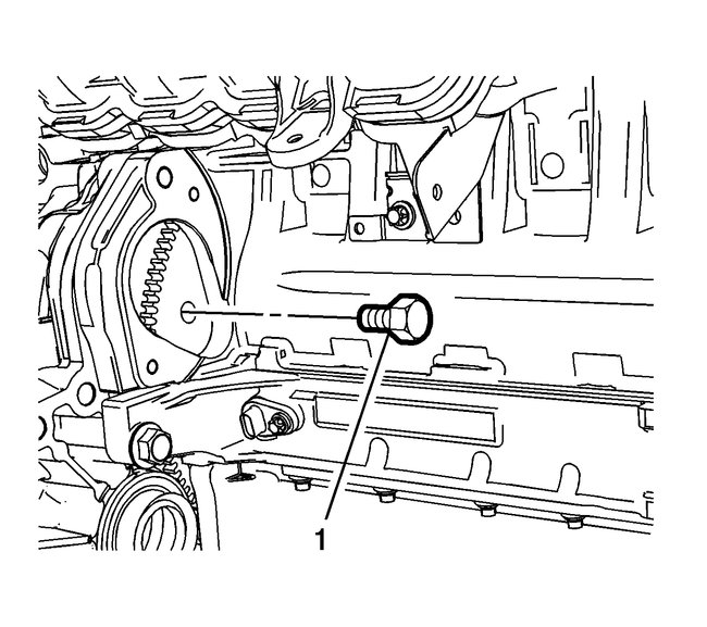

49. Remove and DISCARD the flex plate to torque converter bolts (1).
pic 24

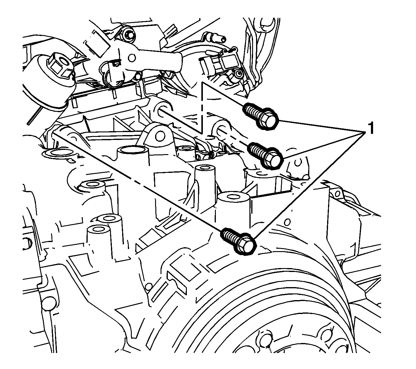

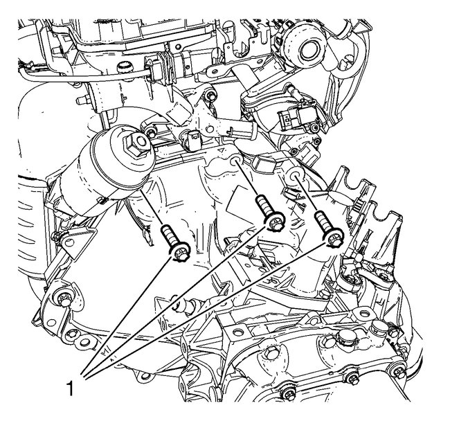

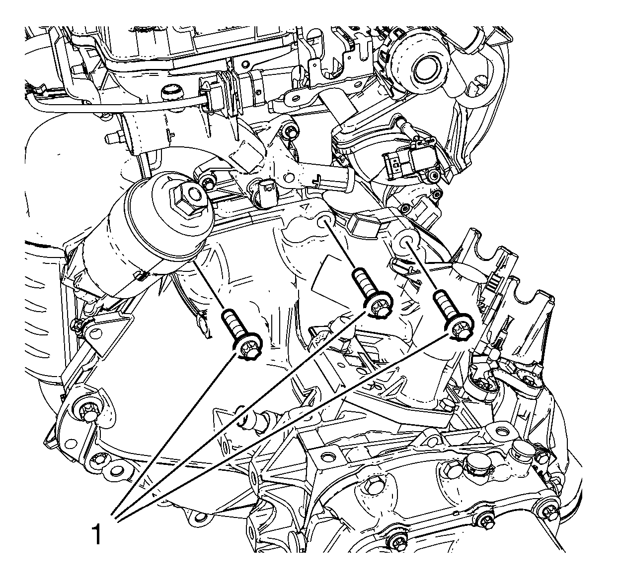

50. If equipped with an automatic transmission, remove the upper transmission to engine bolts (1) and separate the engine and transmission.
pic 25
51. If equipped with manual transmission, remove the upper transmission to engine bolts (1). And separate the engine and transmission.

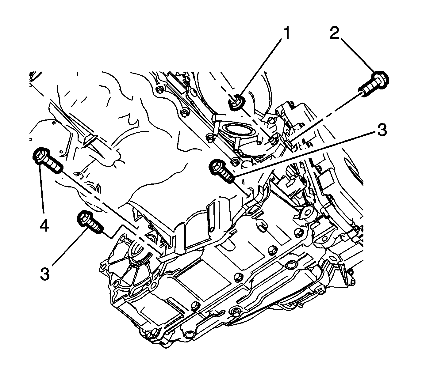

1. Install the transmission to the engine.
pic 26
