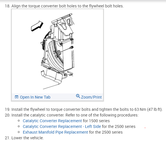

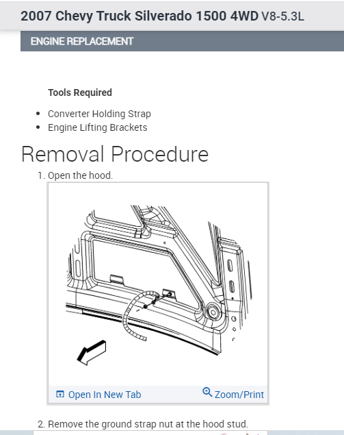

Engine overfill oil entered air intake manifold and into firing combustion chamber, so I think I’m just going to replace the entire engine, assembled heads and all. But what are some parts I’ll need for the lc9? And should I replace the flex plate put anger?
