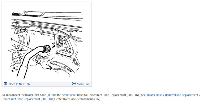

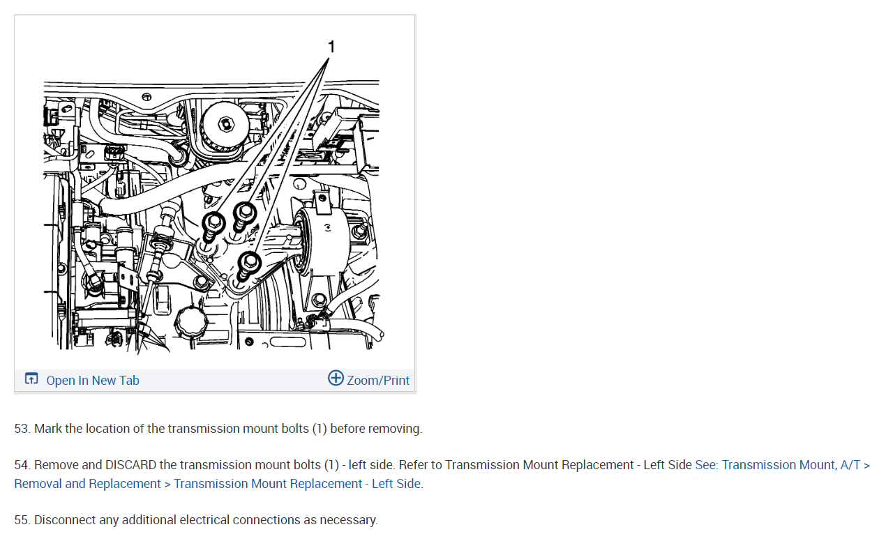

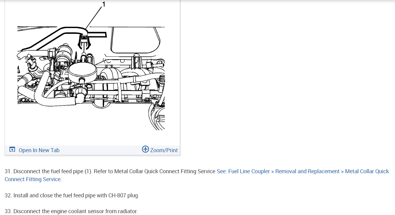

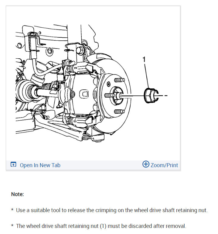

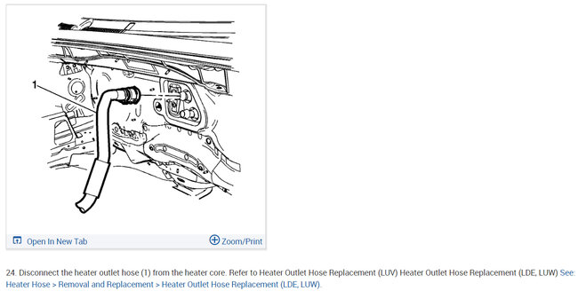

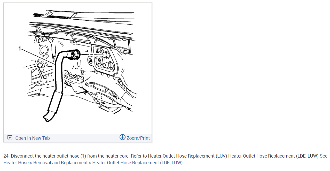

Is there a way to remove it through the top? I’ve seen a few done that way. what do I need to remove to do that and torque specs?
Aug 7, 2024 at 8:54 PM

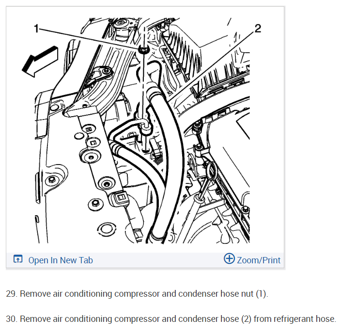

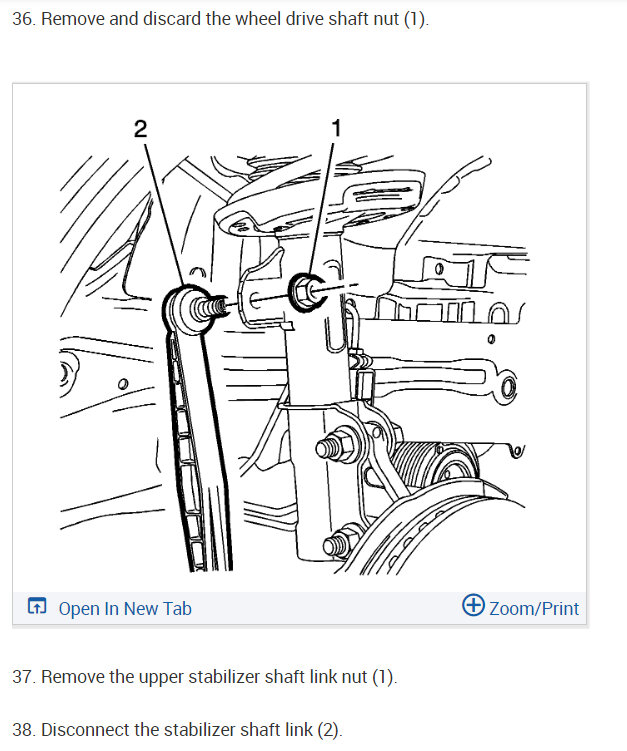

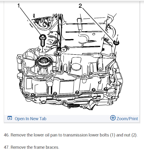

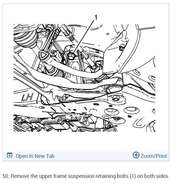

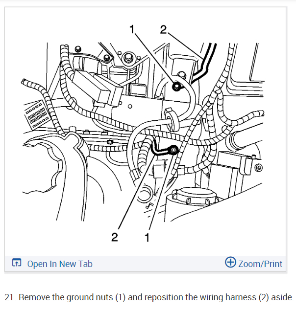

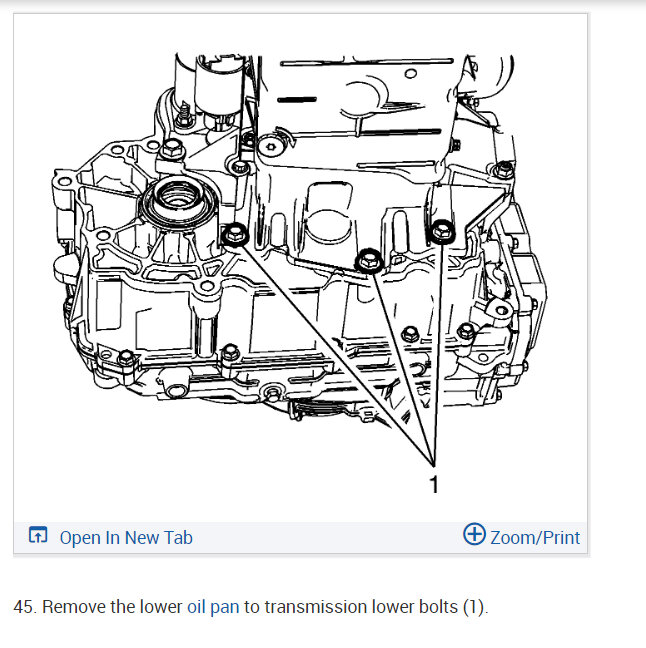

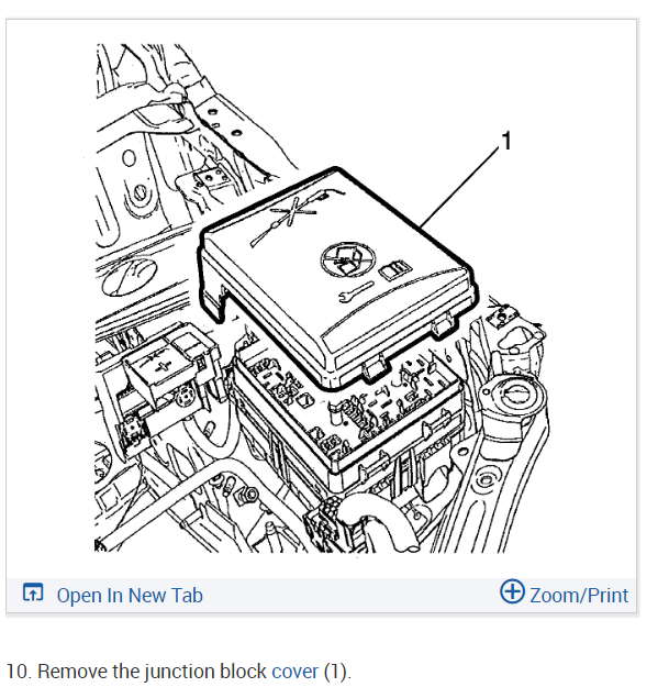

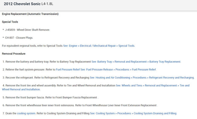

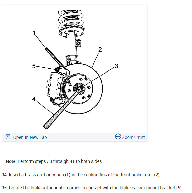

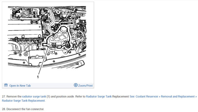

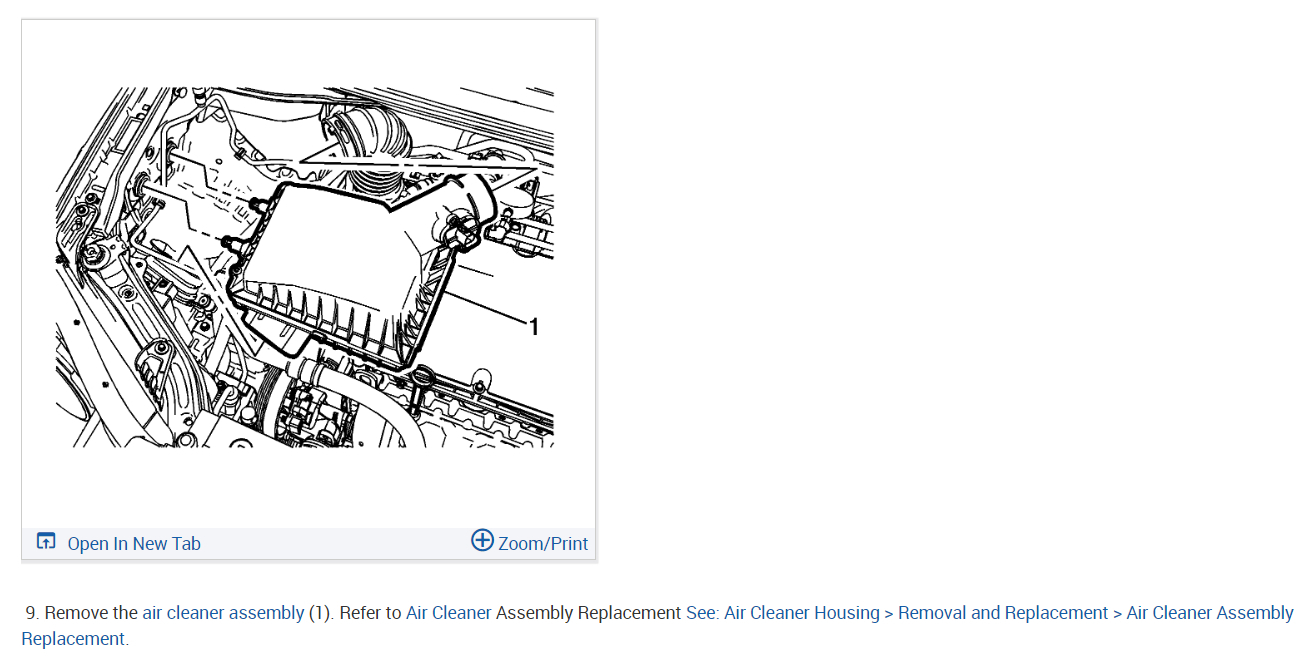

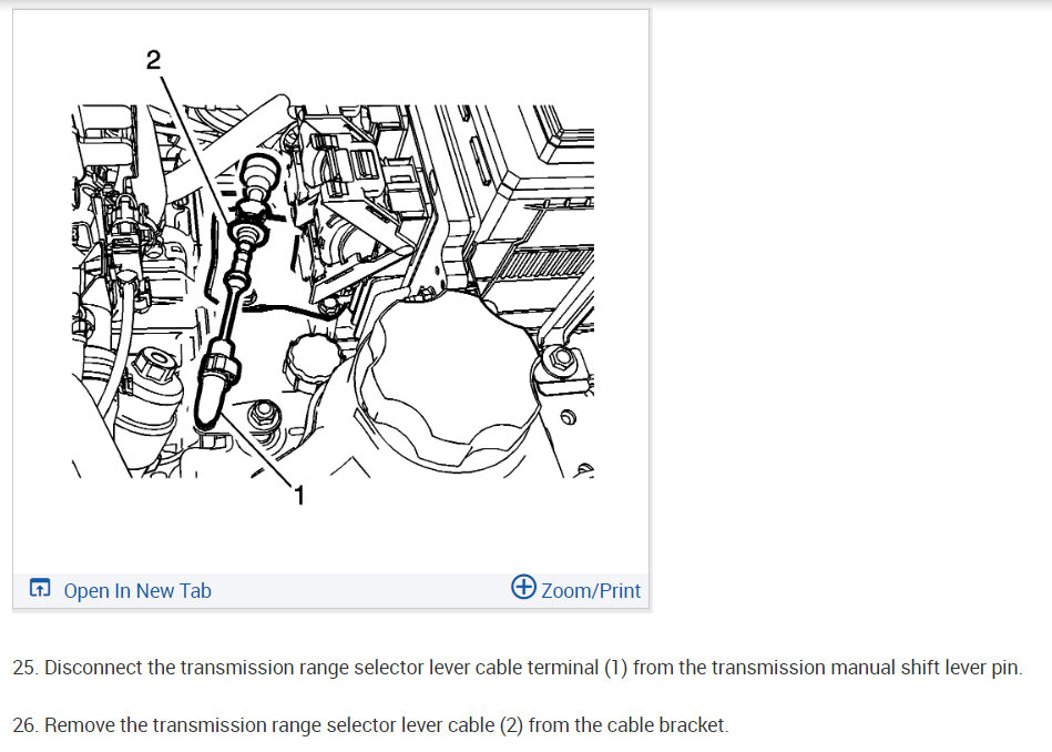

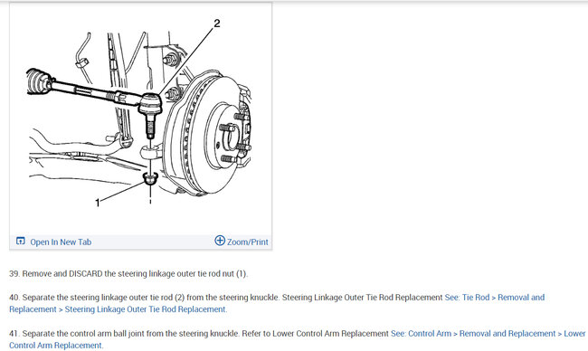

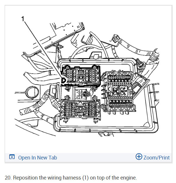

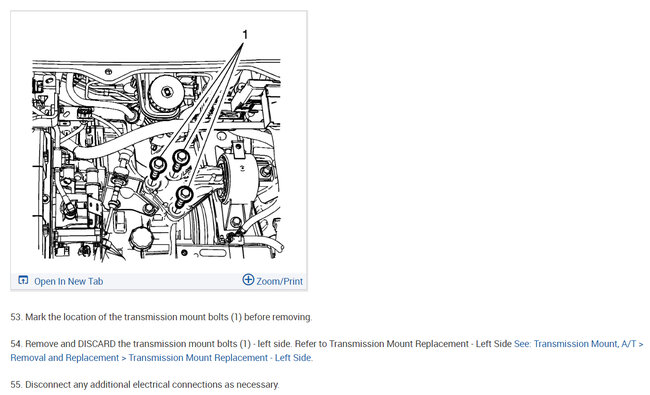

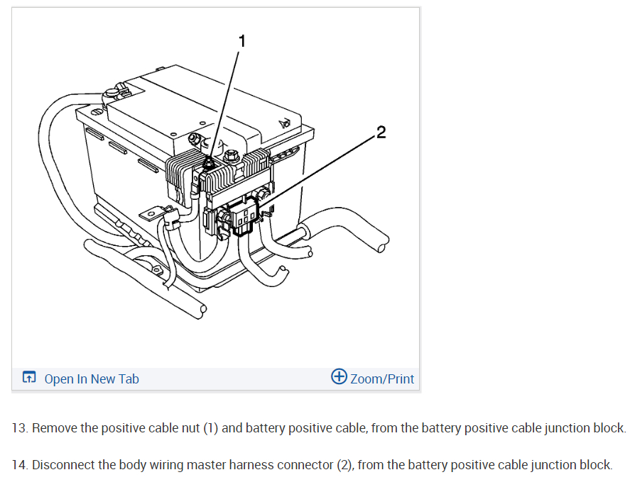

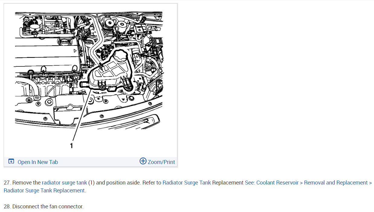

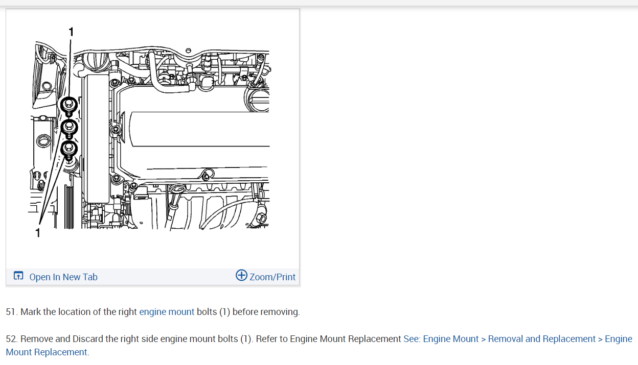

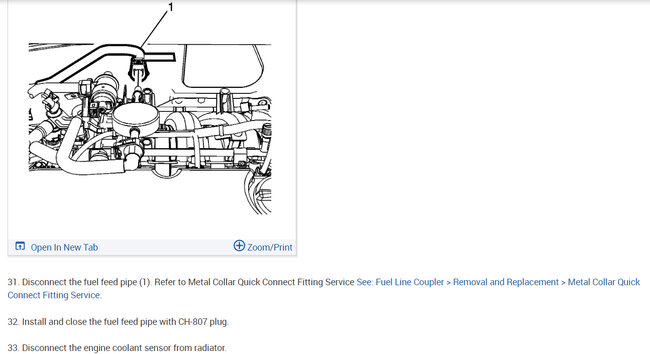

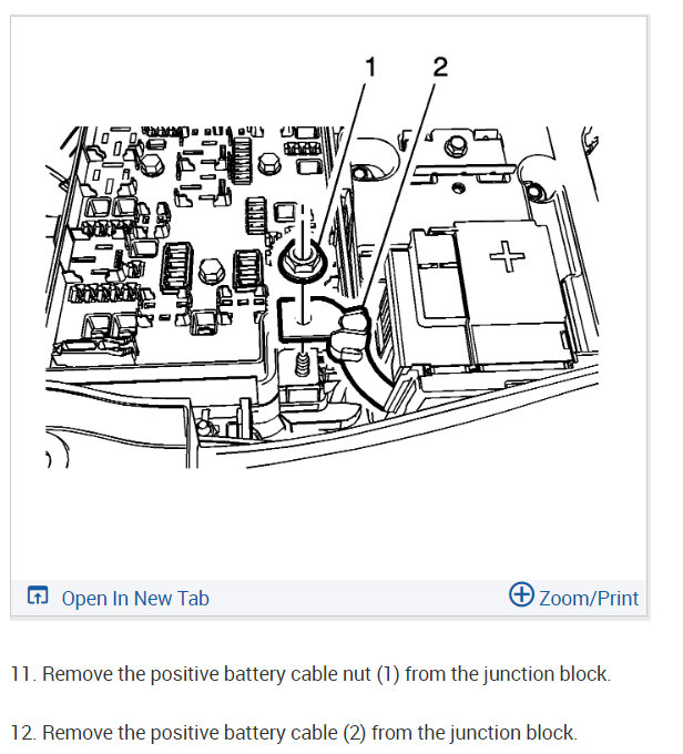

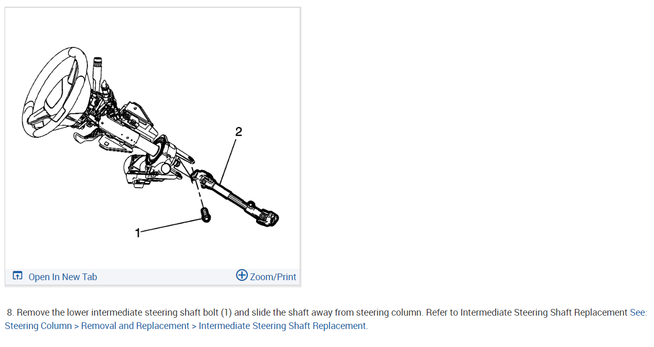

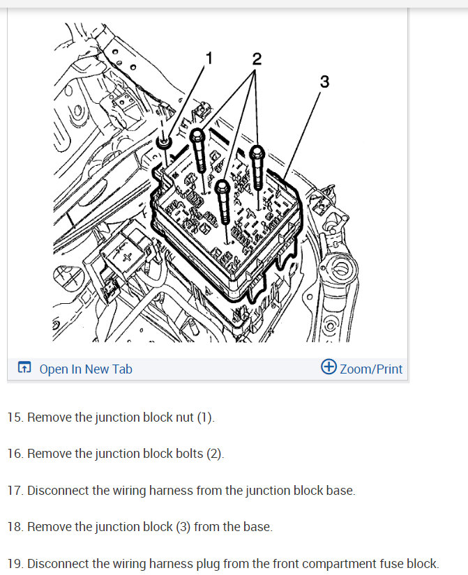

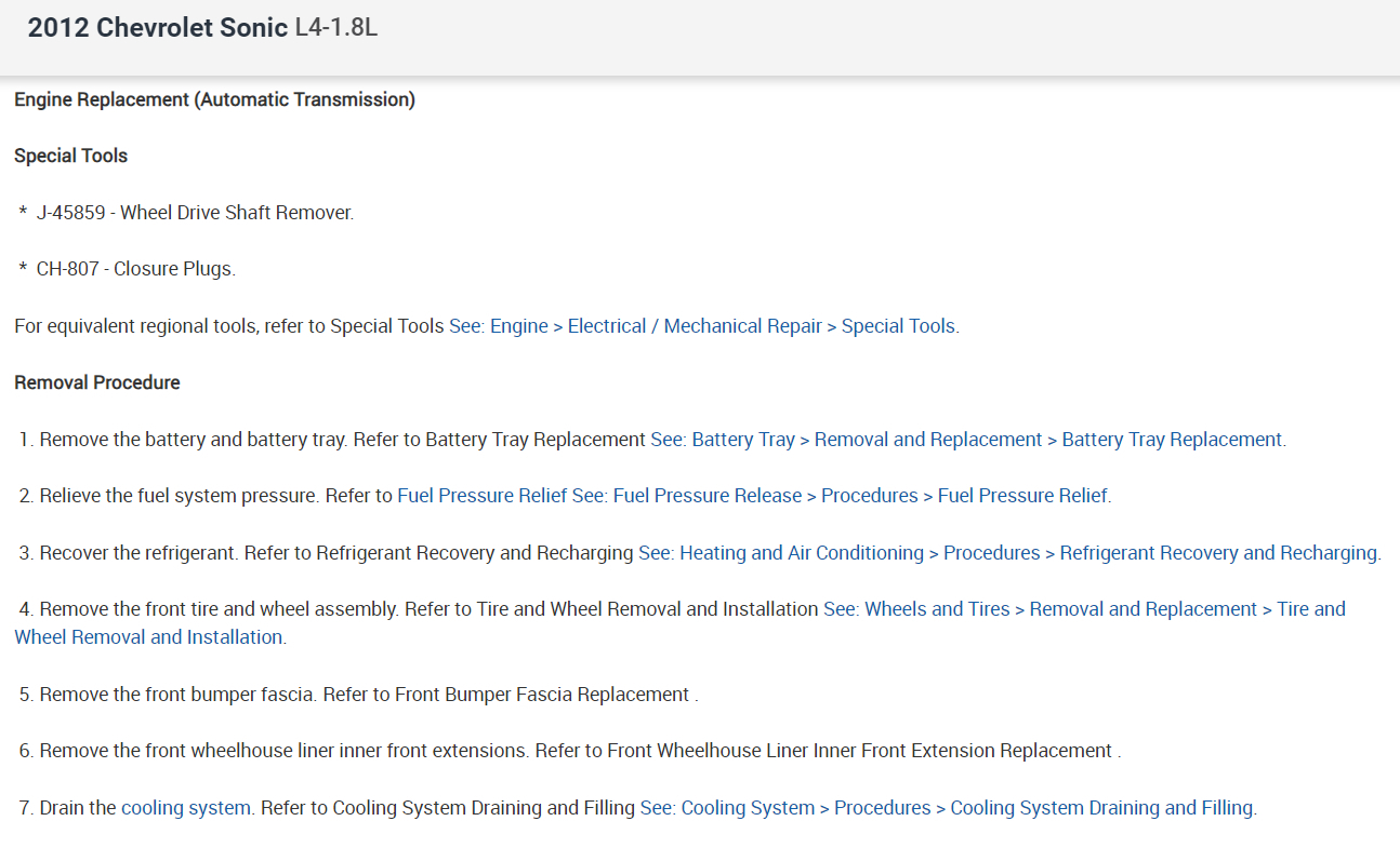

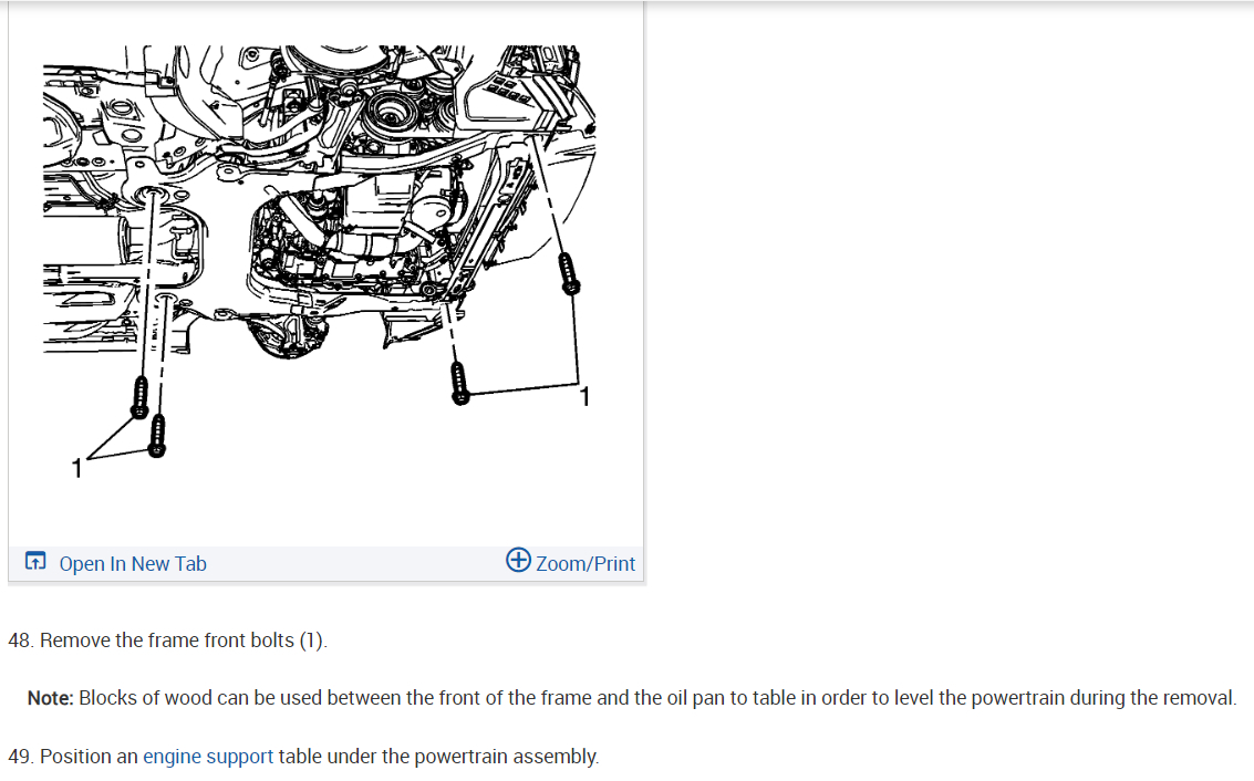

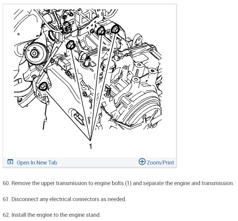

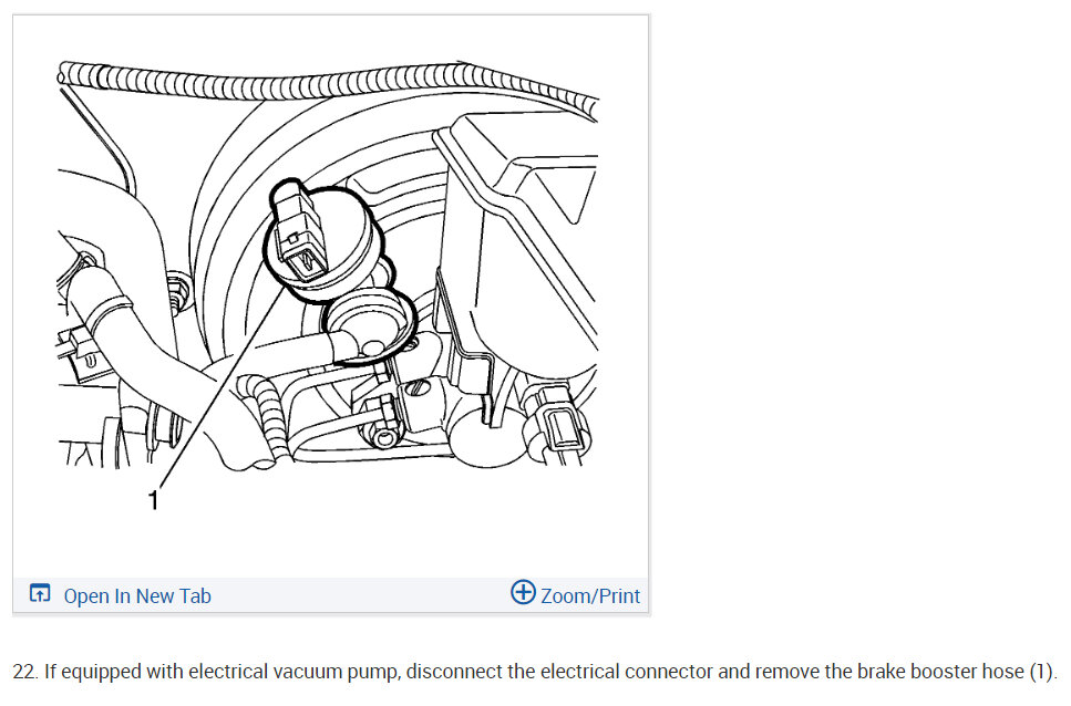

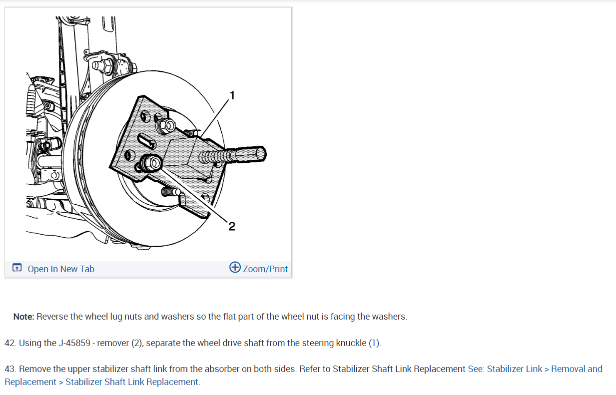

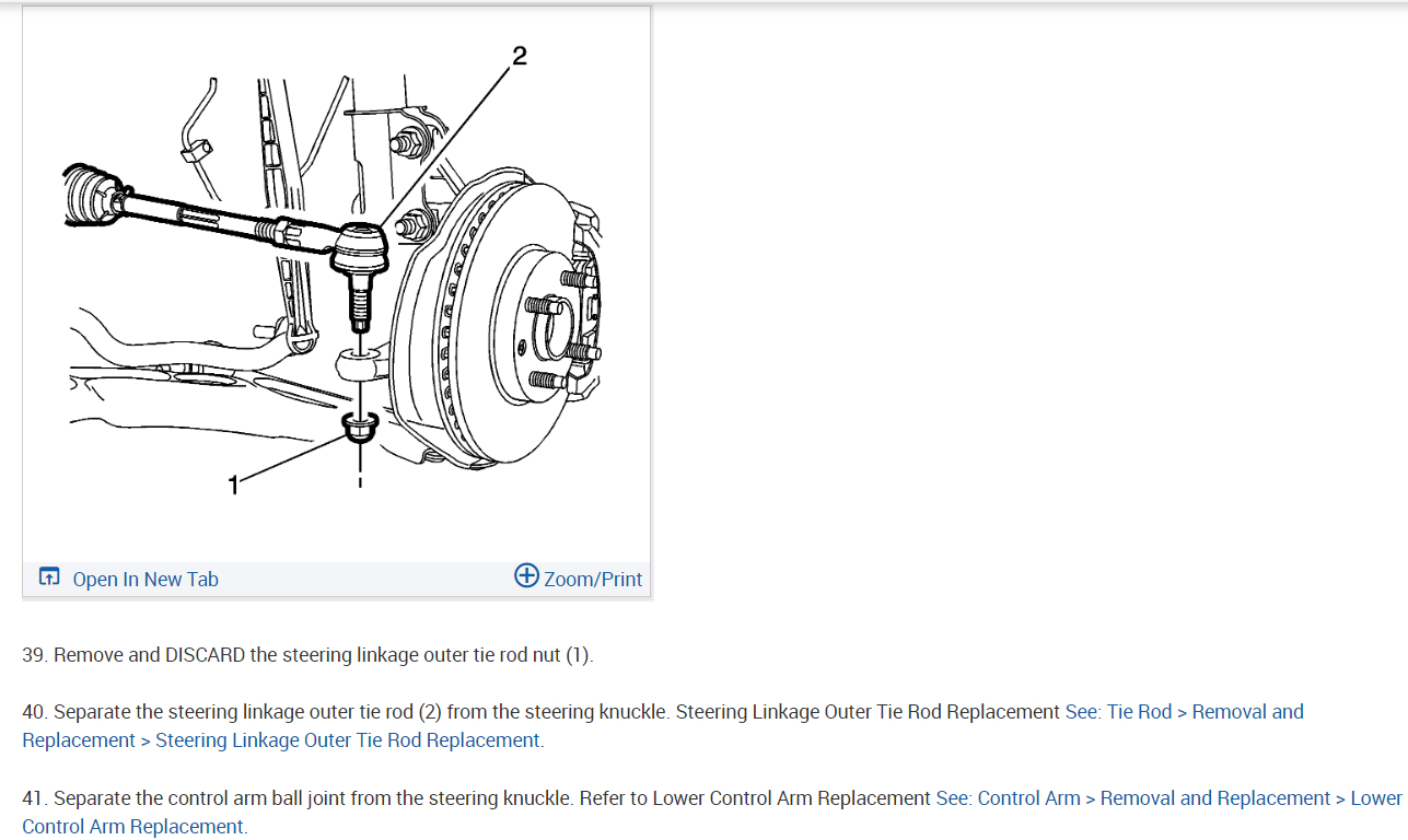

I am sure you might be able to take the engine out from the top, but they recommend the subframe be removed with the transmission. Since I don't know anyone that has done this I can say for sure. Start by draining the coolant and removing the battery. I would remove the hood as well. One problem I can see is there might not be enough room to separate the engine from the transmission while it is inside the car. Here is how the book says it should be done. Check out the images (below). Please upload pictures or videos in your response of any problems so we can see what to help you with.

How many bell housing bolts? I know there’s a few on top easy to get to.
Aug 9, 2024 at 7:41 PM
It looks like 4 on top and 3 across the bottom.

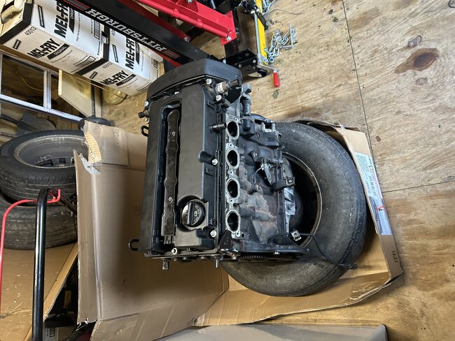

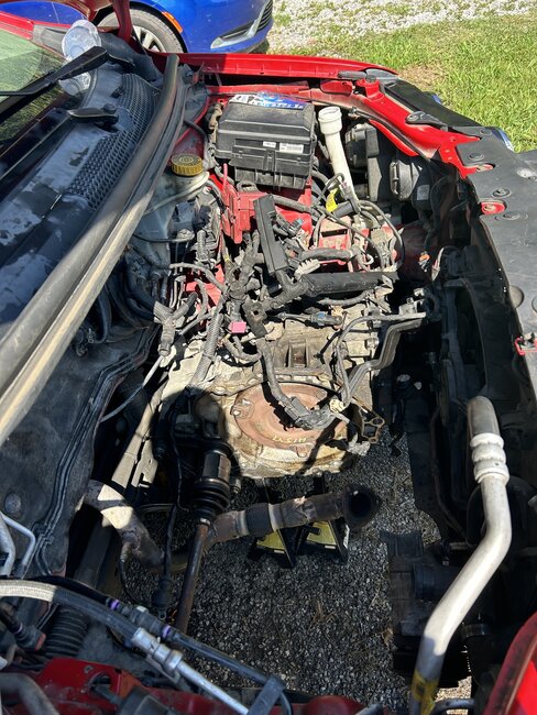

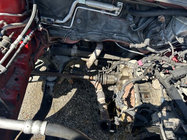

CORY2427
  • 293 POSTS
Here are some pics.
Aug 12, 2024 at 9:20 AM
That's what I am talking about! Nice work :)
