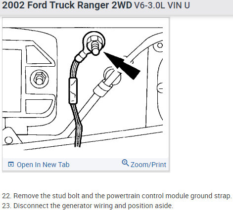

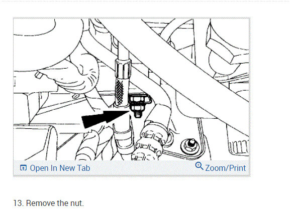

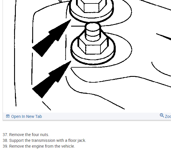

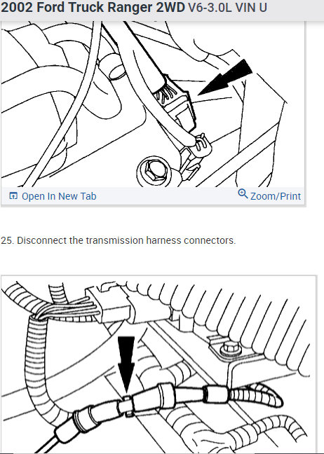

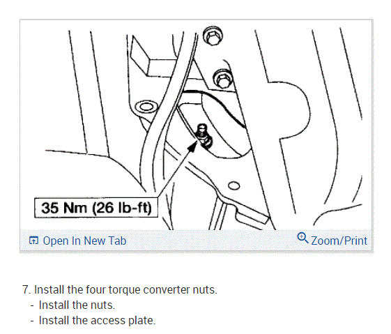

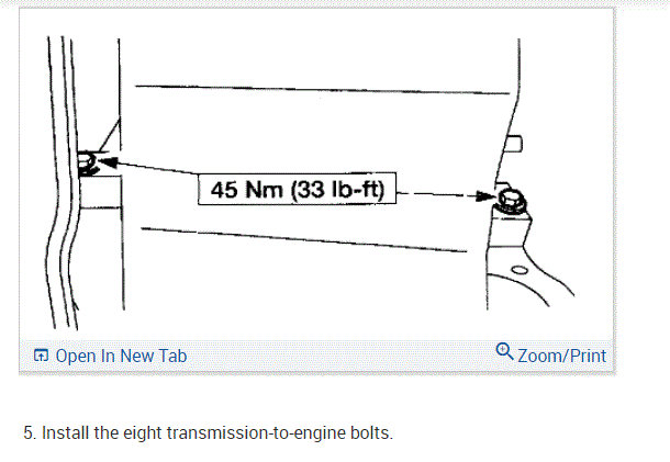

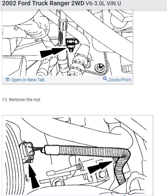

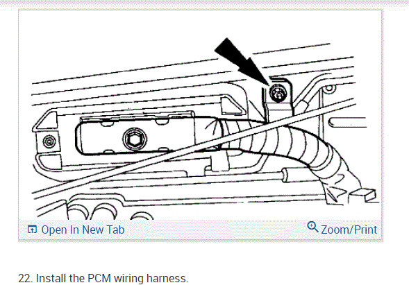

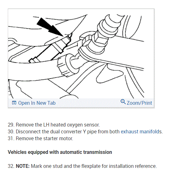

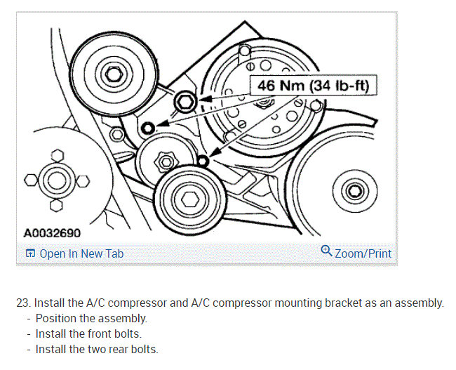

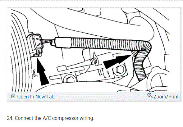

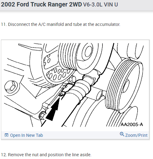

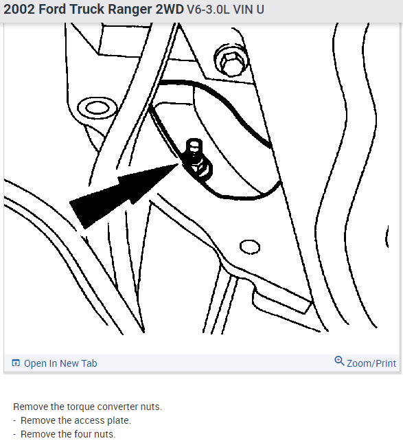

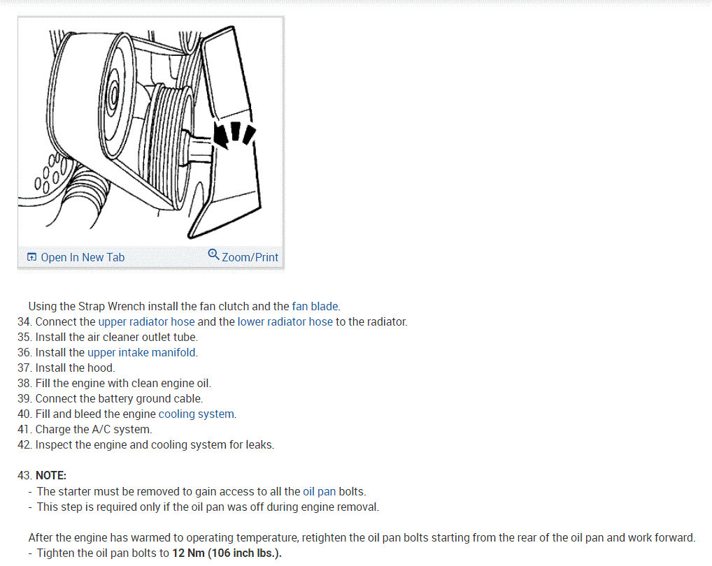

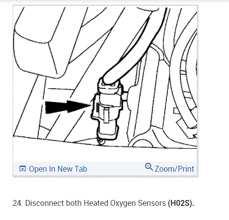

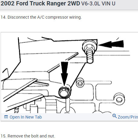

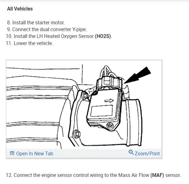

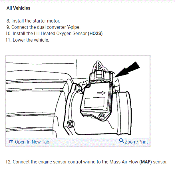

I don't have a video specific to this vehicle, but I do have step-by-step instructions. Also, here is a video showing how an engine is removed. It is on a different type of vehicle, but the procedure is very similar and below I have the directions for your vehicle.
https://youtu.be/zy1CozLgWUQ

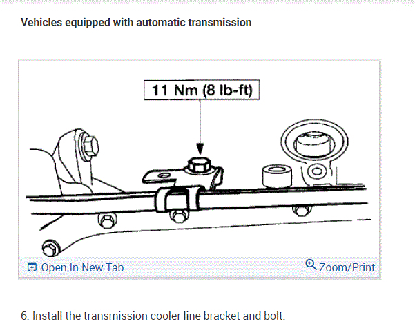

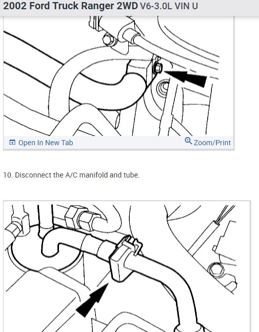

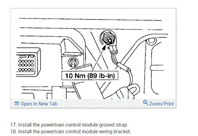

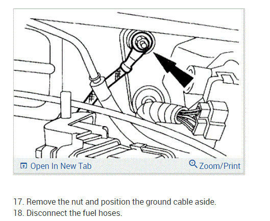

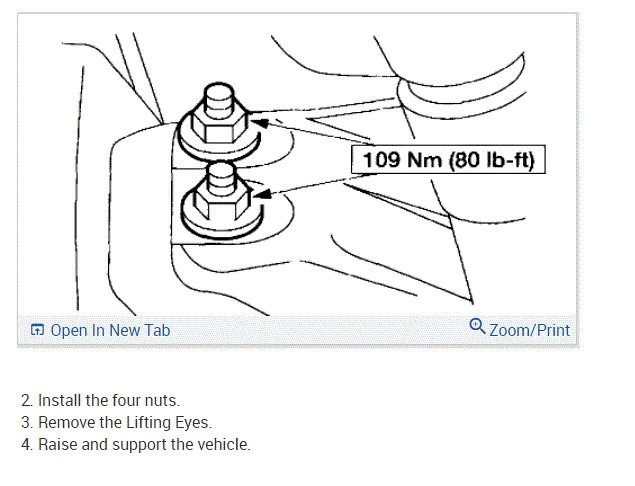

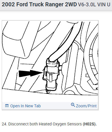

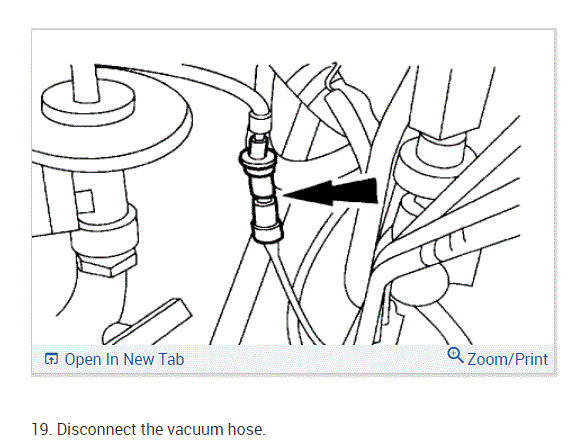

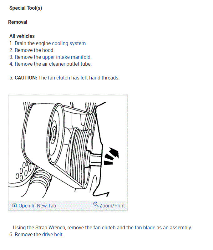

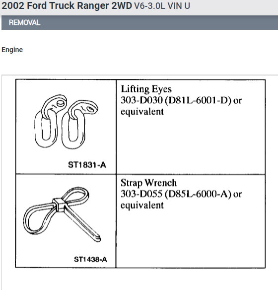

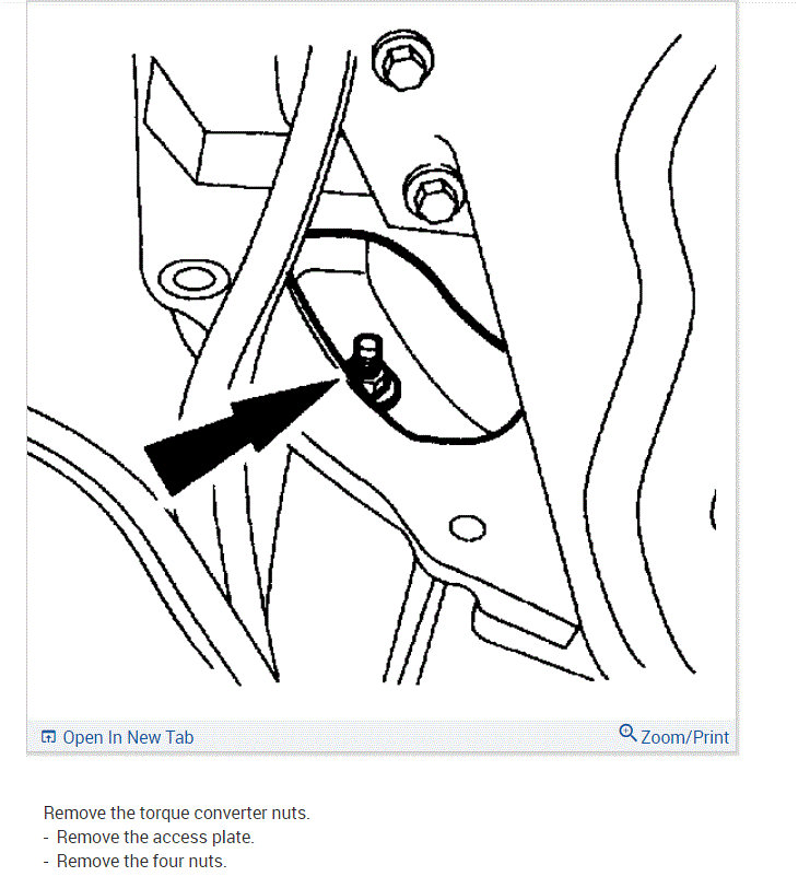

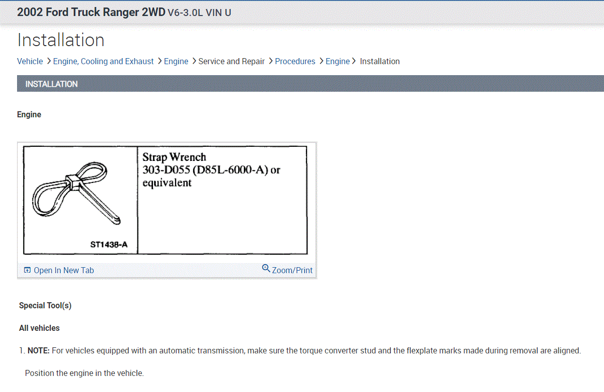

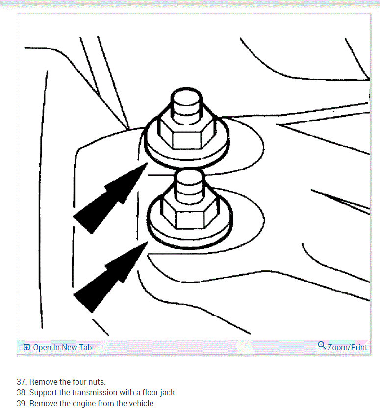

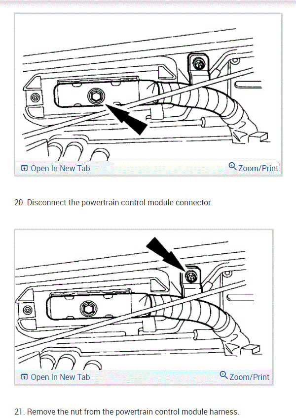

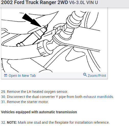

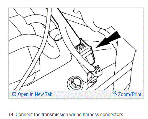

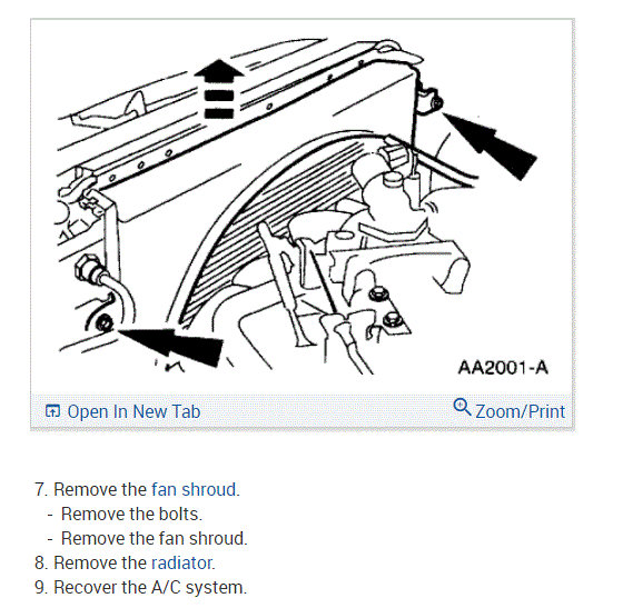

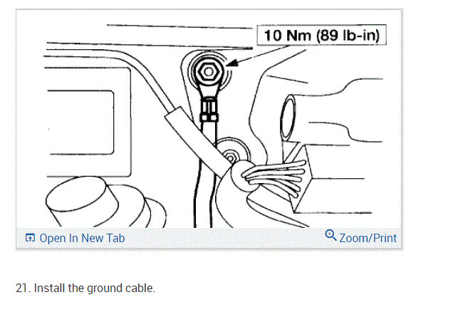

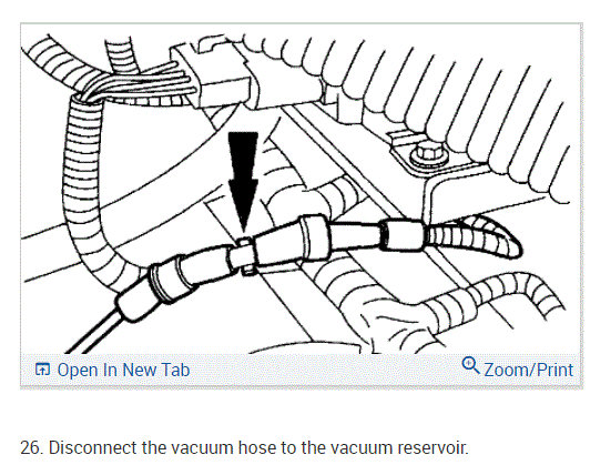

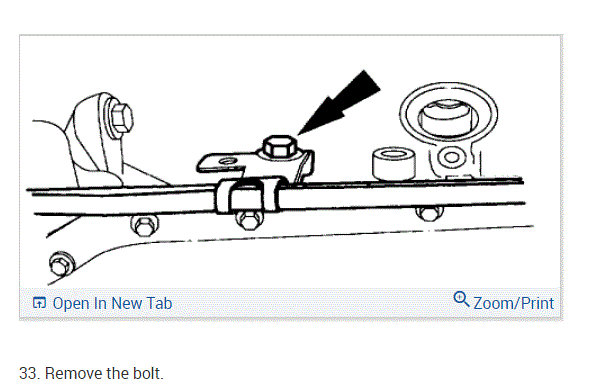

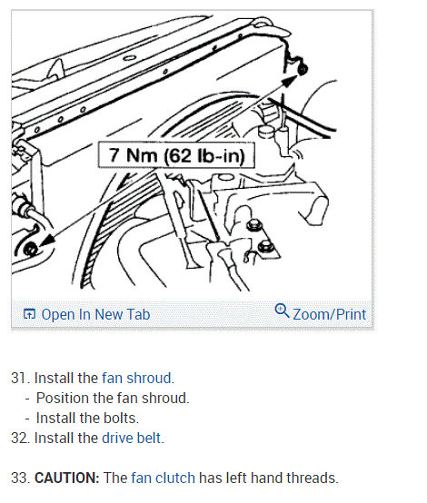

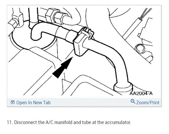

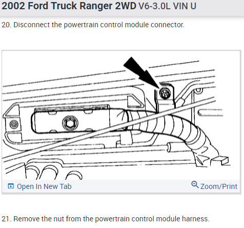

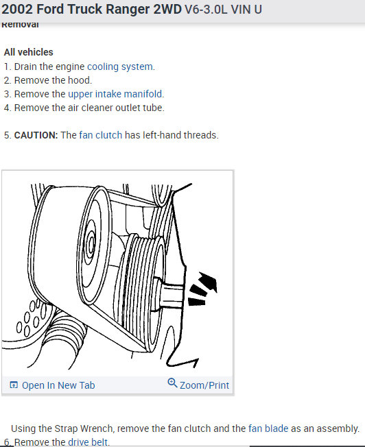

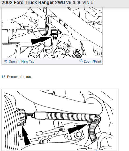

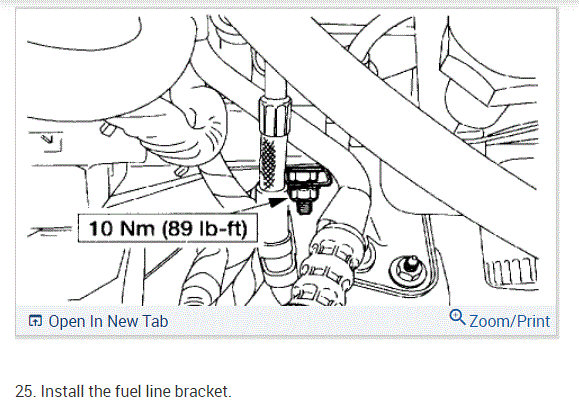

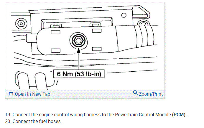

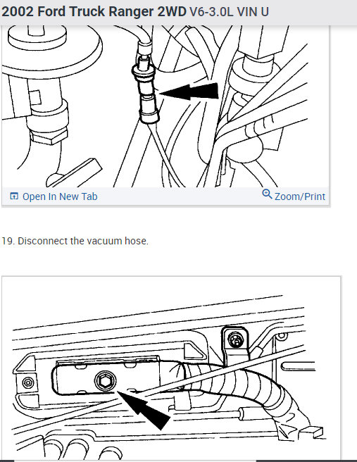

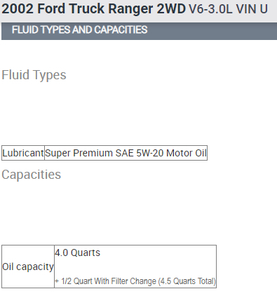

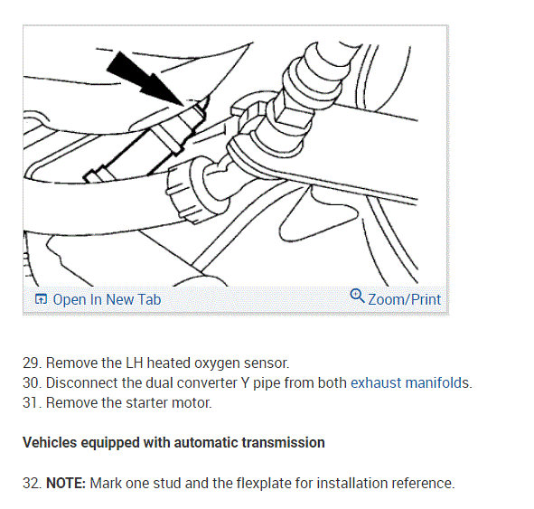

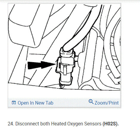

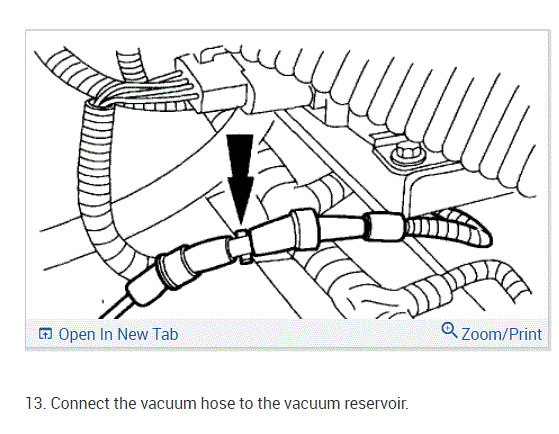

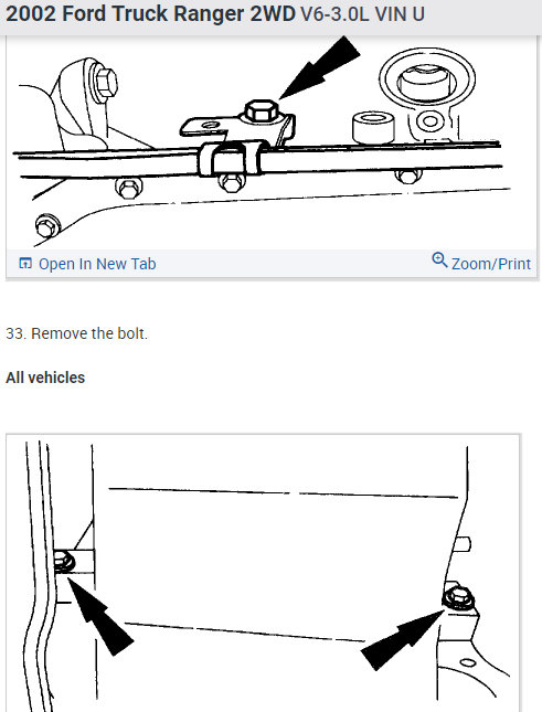

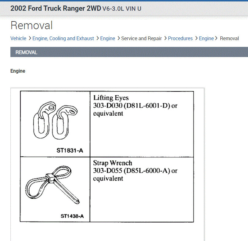

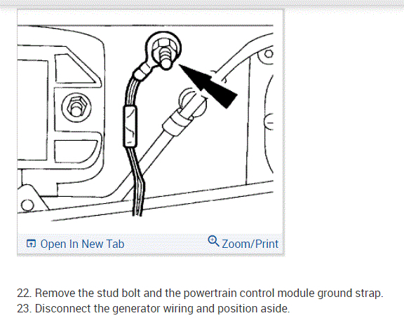

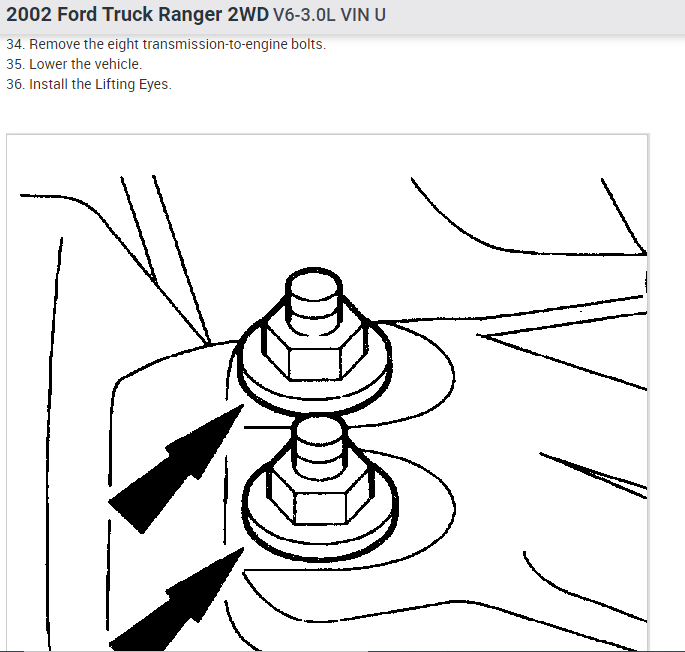

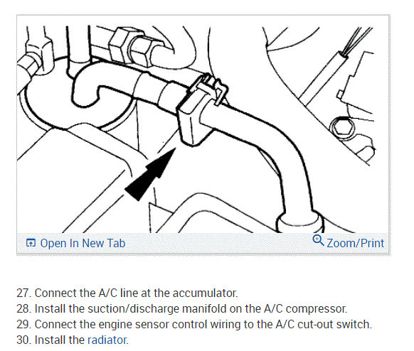

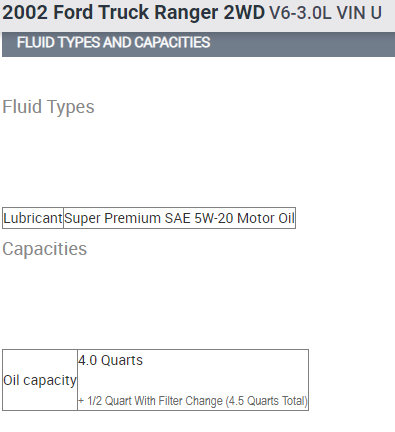

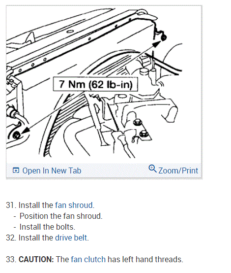

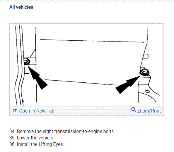

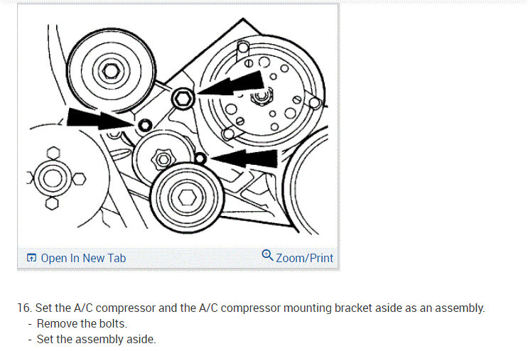

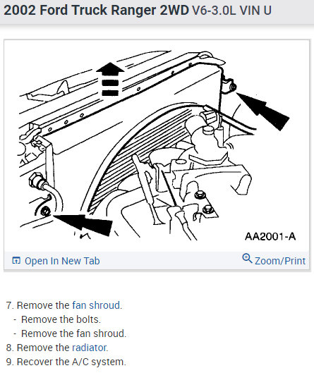

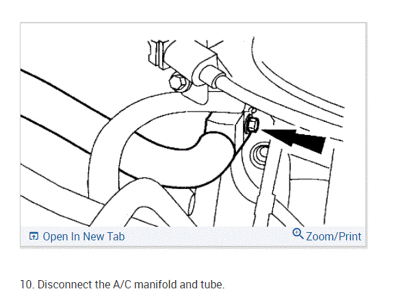

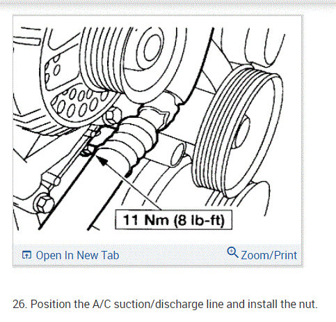

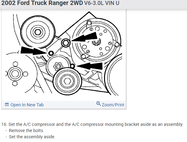

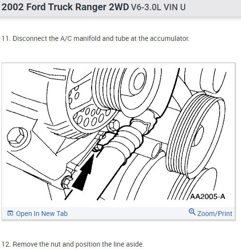

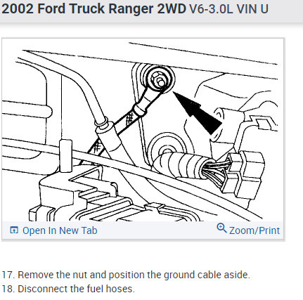

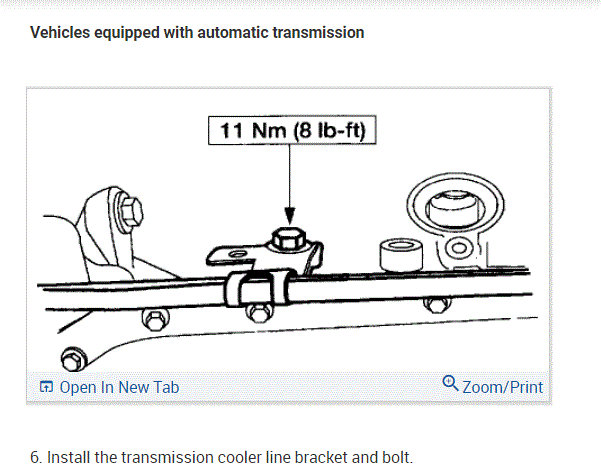

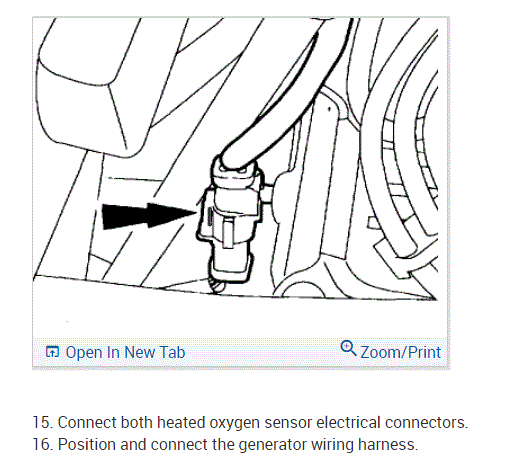

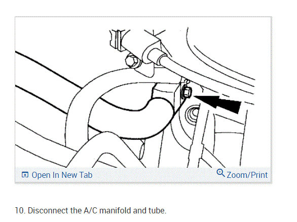

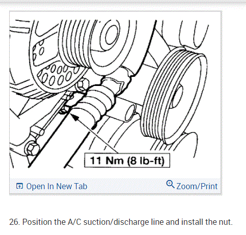

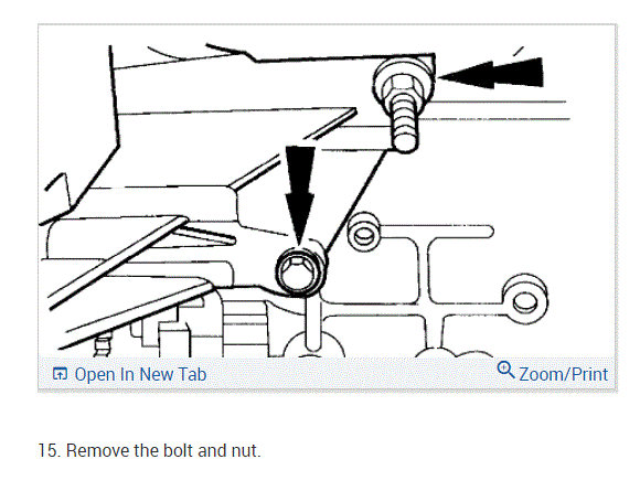

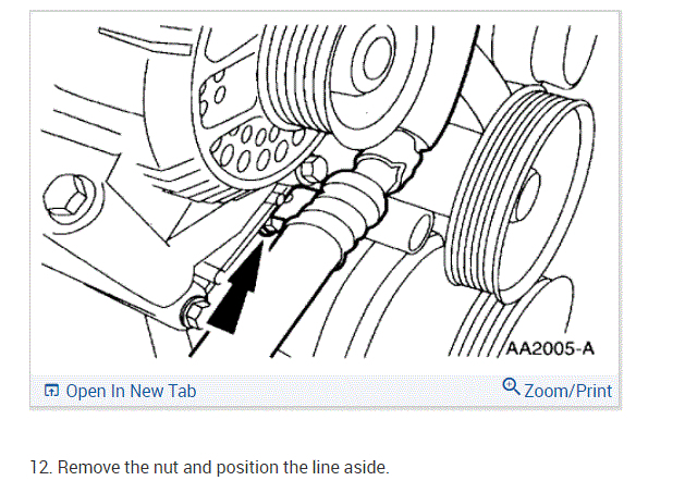

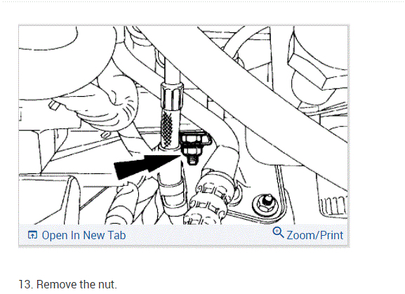

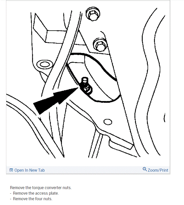

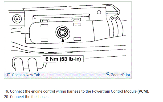

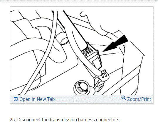

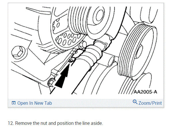

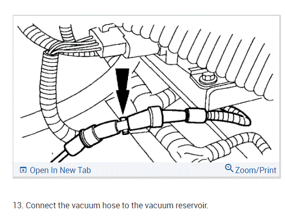

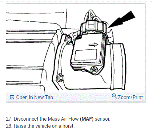

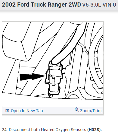

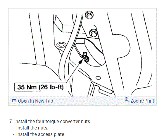

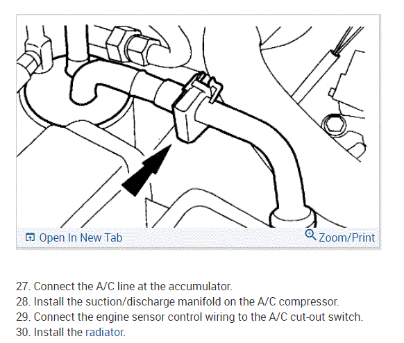

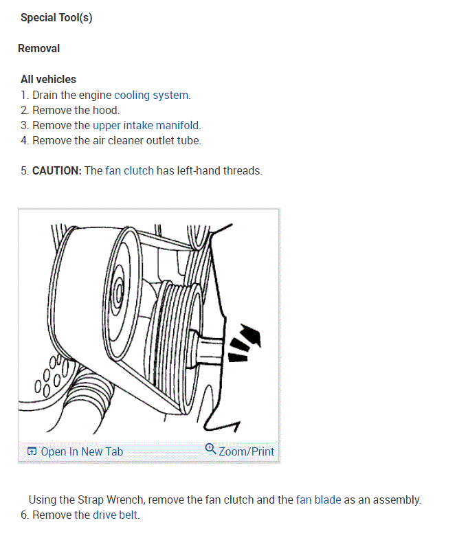

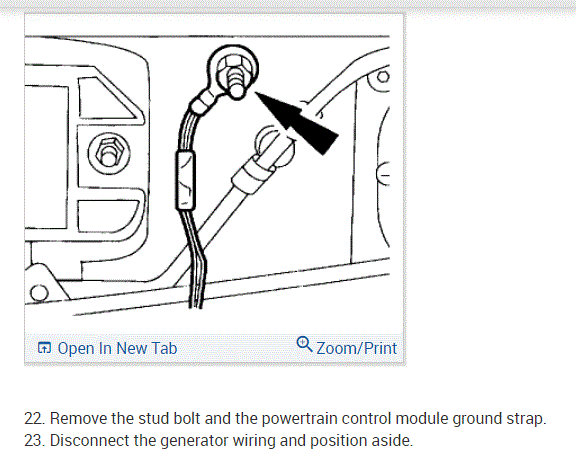

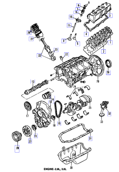

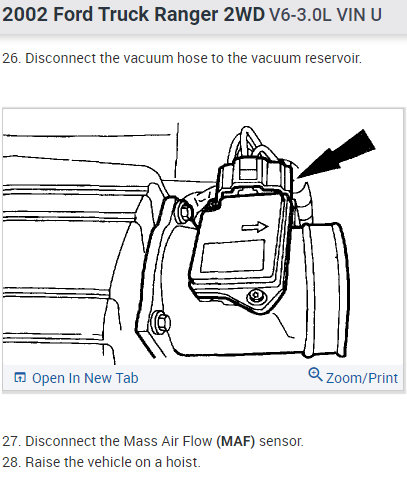

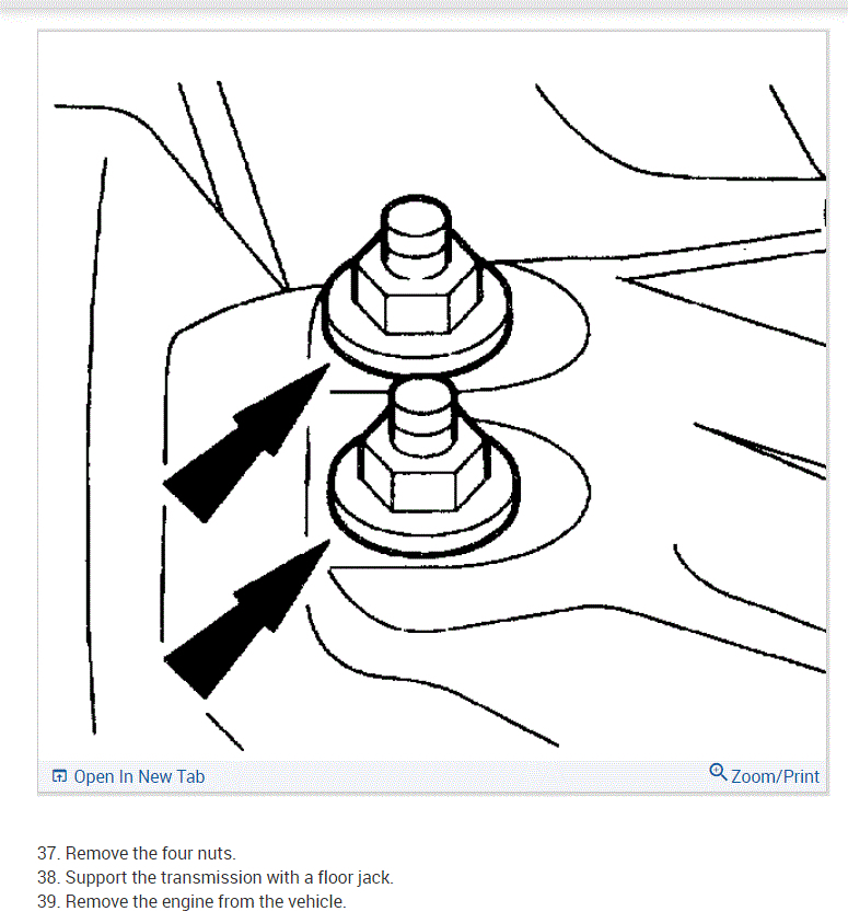

If you look at the attachments below, it explains how to remove and replace the engine. If you run into trouble, let me know and I'll try my best to help or answer questions.
See pics below.
