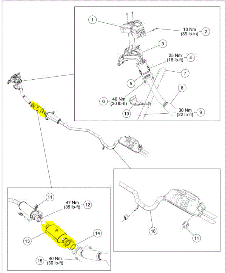

Can you tell where the rattle is coming from? If you hear a rattling sound, I'm questioning if the catalytic converter has come loose internally. If it moves to the right position, it can block airflow and cause this.
First, take a look through this link. It explains the common symptoms of a faulty catalytic converter.
https://www.2carpros.com/articles/bad-catalytic-converter-symptoms
Here is what I would like you to do. Take a rubber mallet and tap on the exhaust around the catalytic converter to see if you can reproduce the noise.
I attached a pic of the exhaust system below. I highlighted the catalytic converter.
Let me know what you find and if the check engine light stays on while the engine is running.
