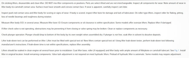

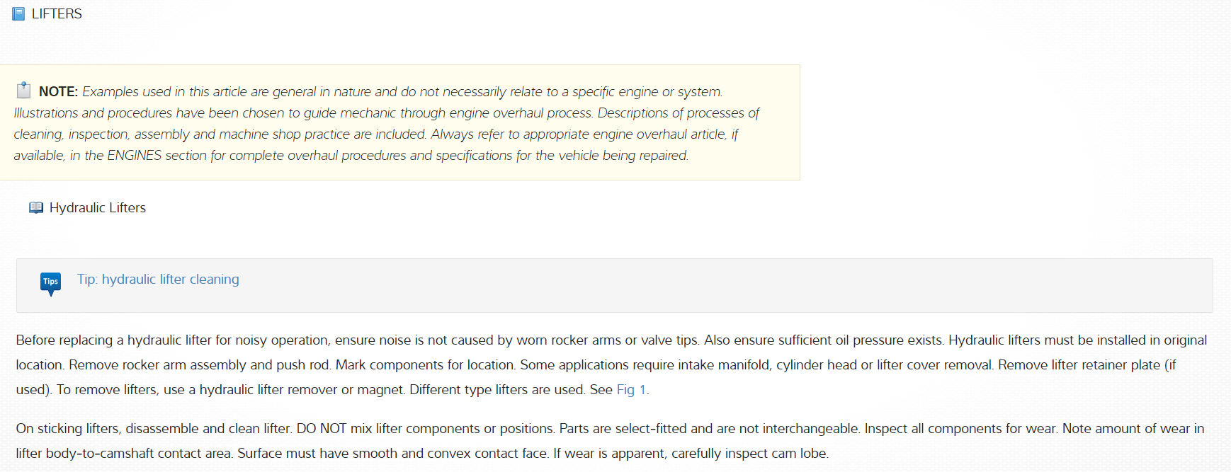

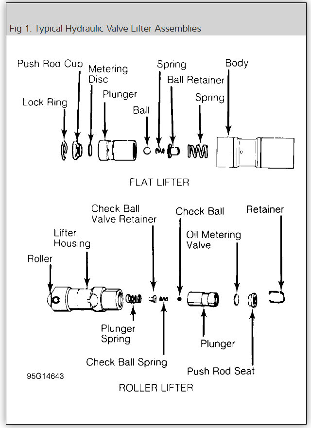

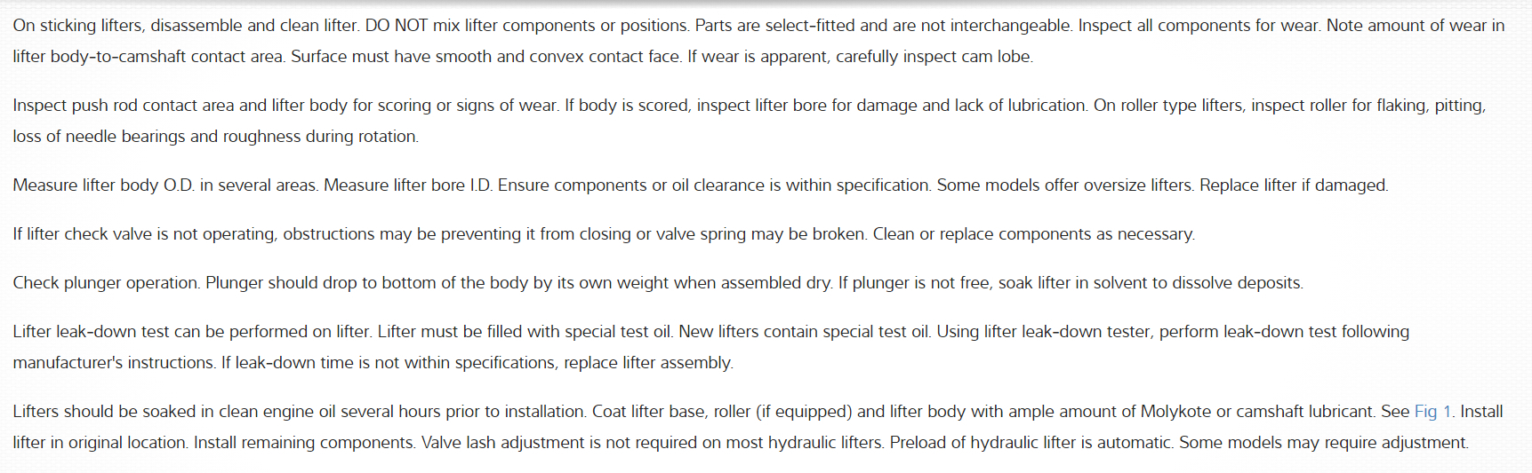

This could be a problem with your lifters. I have included some information for you in the diagrams below. Go through it and let us know what you find out.
Thanks,
Alex
