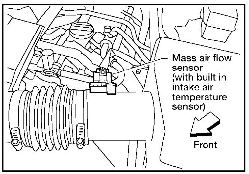

It looks like you have two or three problems, the first is the MAF sensor needs to be replaced, or you have a crack or the air intake tube is disconnected between the MAF sensor and throttle body.
This guide can help:
P1805 Brake Switch or Step Motor Circuit (often Transmission-related)
P0102 Mass Air Flow (MAF) Sensor Circuit Low Input
P0113 Intake Air Temperature (IAT) Sensor 1 Circuit High Input
P0011 Intake Valve Timing (VVT) Over-Advanced (Bank 1)
If the intake tube is good, I would replace the MAF sensor and then clear the codes, please start new threads for the P1805 and P0011 codes separately. Here is the sensor in question. Check out the images (below). Let us know how it goes.

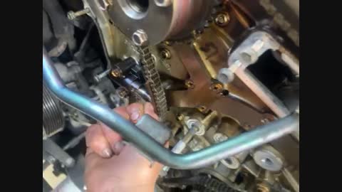

Here’s a video.

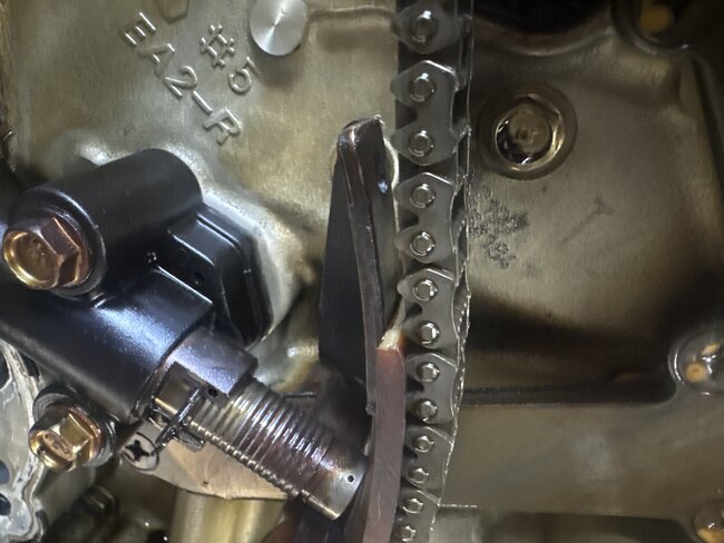

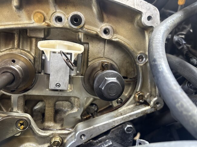

And here’s a picture of one of the broken guides.

The chain turns the camshafts, but the chain skips every other rotation around the top right cam phaser because the primary tensioner is bad. So, I’m assuming that’s why my reader picked up the advanced intake timing code.
Apr 29, 2025 at 7:41 AM
Yep, good find on the timing chain issue, I don't like hearing that the chain skips though, you could have bent valves, also can I ask which phone you used to upload the video? It does not work, and I want to tell the webmaster of the site. When you get the timing chain back together, crank the engine over to see if you have compression or not.

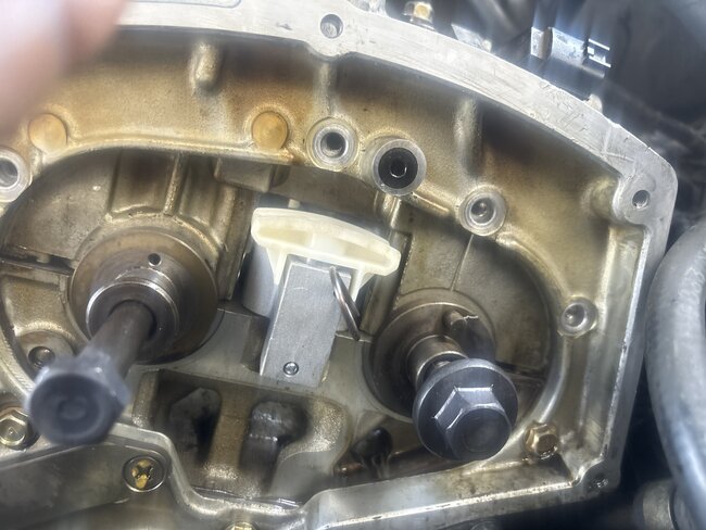

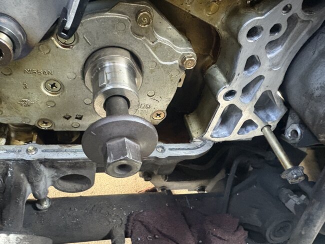

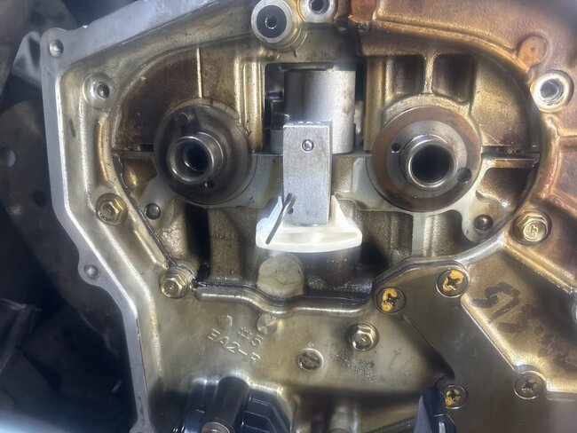

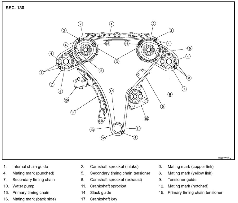

The passenger side cam timing mark is off from the other side and the crank. The two on the driver's side are on their marks and so is the crank. The passenger side, not so much. The first pic is passenger side. Second is crank and third is driver side. I used my borescope to check valves, and they seem fine from what I can see.
Apr 29, 2025 at 5:45 PM
New video format thanks. That is good news that the valves are okay. Here is how to time the engine crankshaft and camshafts. Check out the images (below). Let us know how it goes.

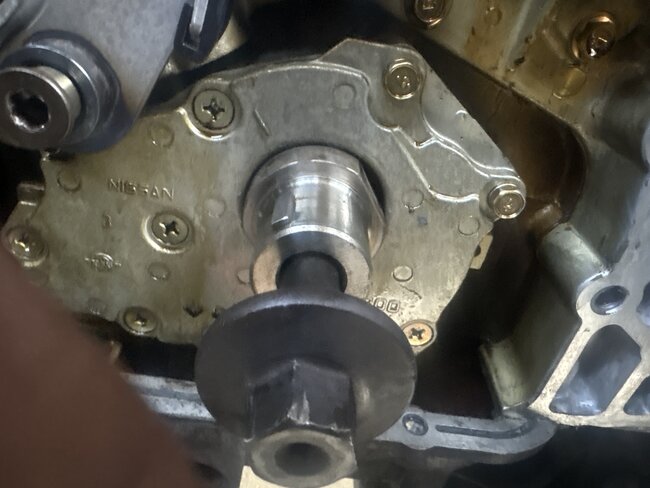

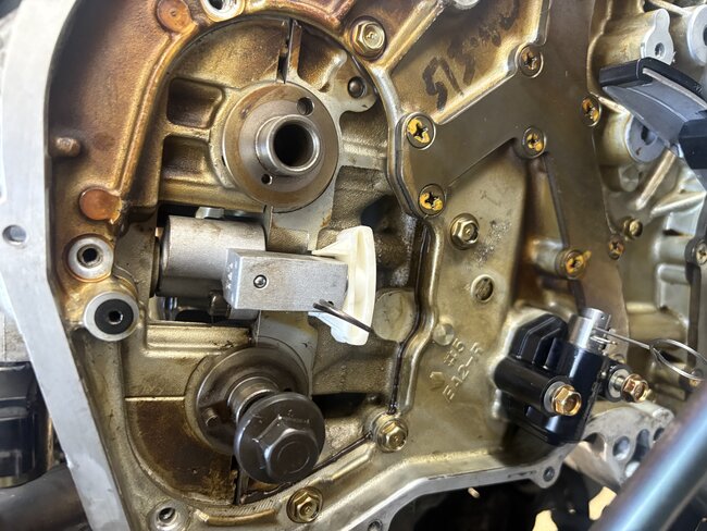

First pic is driver side. Both in time. Second pic is crankshaft, in time. Third pic is passenger side cams where the tensioner that was on the chain guide failed. Left one slightly out of time but the right one is the one I’m talking about. This is what it looks like with the caps being able to go down flush with the head. If I were to take the caps off and move it to match the timing marks, I wouldn’t be able to push the cams back on because of the way the cam lobes end up positioned when I move it.
May 2, 2025 at 4:33 PM
I would try moving the crankshaft off of TDC about 15 degrees and then try rotating the camshafts, they should be safe at this point, then when the camshafts are on the marks move the crankshaft back to TDC. The camshafts should turn freely except for the pressure of the valve springs.
