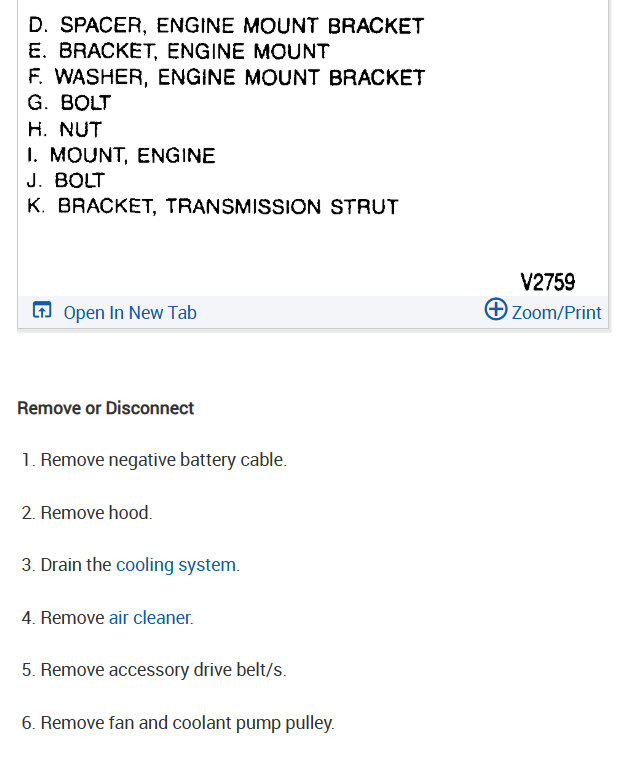

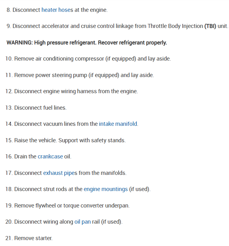

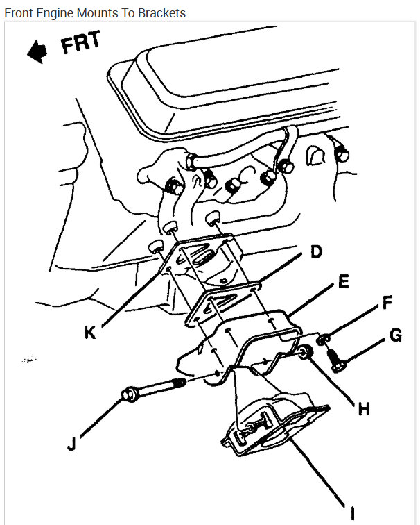

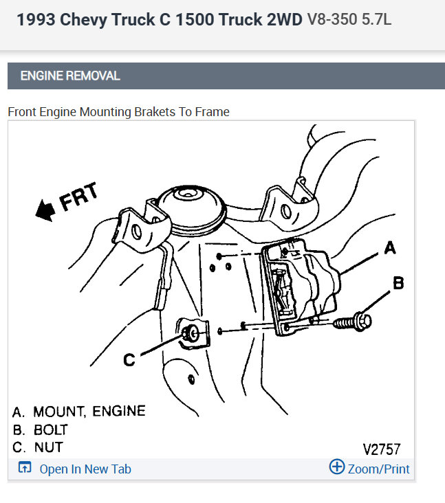

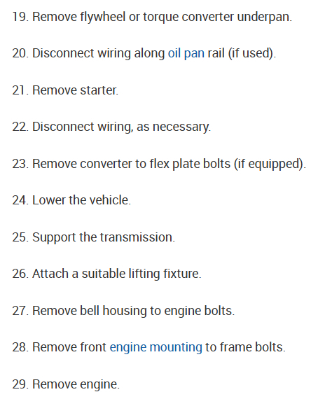

Sure we can help you, drain the coolant and engine oil, you will need an engine hoist which you can rent. If it has A/C you will need to watch this video to help you:
https://www.youtube.com/watch?v=4EqdrBVb0sY
Also here is a video of the job being done on a similar truck which will help with the steps as well:
https://youtu.be/zy1CozLgWUQ?si=PGBiNqNcWovUORTH
Here are the instructions for your truck. Check out the images (below). Please upload pictures or videos in your response of any problems so we can see what to help you with.
