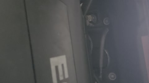

Here are a few videos of the noises:
Aug 12, 2019 at 6:42 AM
