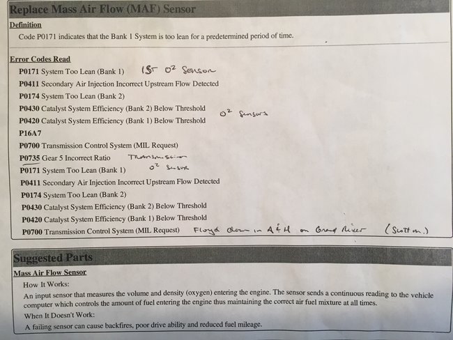

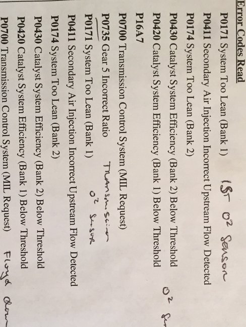

When I accelerate, especially trying to enter a highway, the care will just shut off. I pull over and once I turn it off and on, it restarts immediately. I have replaced the spark plugs, all the oxygen sensors, the air intake boot, and checked the fuel pump. Any other suggestions would be greatly appreciated. Thank you
