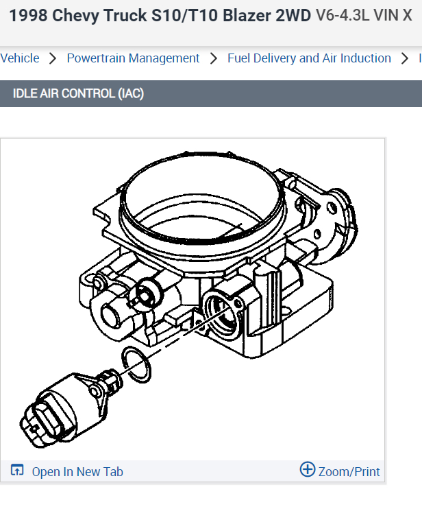

It seems like you may have two problems but let's handle the stalling in this thread. I would first replace the IAC valve which should helps with the stalling. Here is a guide to go over as well and I have included two guides that can help as well.
https://www.2carpros.com/articles/stall-at-idle
And this guide can help get any codes that can lead us to the problem:
Check out the images (below). Please upload pictures or videos in your response of any problems so we can see what to help you with. I would service (clean) the throttle bore and IAC passages as well.
