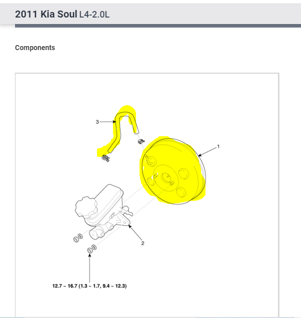

The idea that it hiccups when you press the brake makes me think there is an engine vacuum leak. When you press the brake, the vacuum booster is depleted, and additional vacuum is needed. You shouldn't feel that. If you do, that is where I would start checking.
Take a look at this link. It explains how to test for a leak.
Also, I attached a pic below and highlighted the vacuum brake booster and the vacuum supply hose. Check around there for leaks. It is located under the hood behind the brake master cylinder. Also, make sure the vacuum hose is tight at both ends and there is no evidence of dry rot.
Let me know what you find.
See pic below.

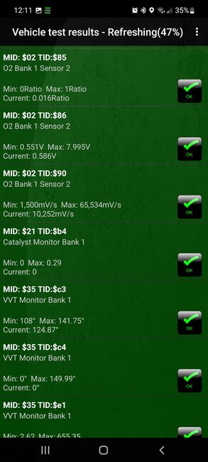

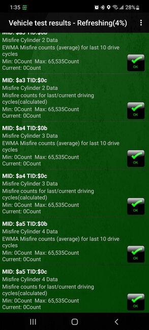

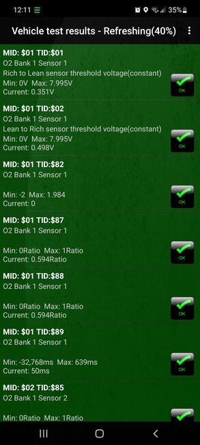

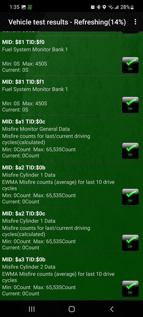

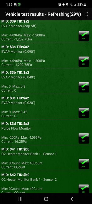

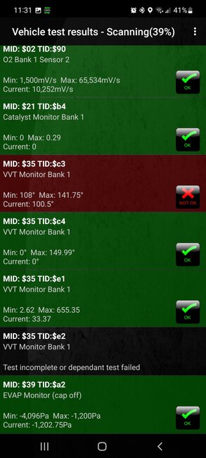

This is what i found using bafx.
There are no codes.
After using expensive gas for a couple months, engine transmission has become little smoother and brake (hiccup? pounding? feels like loose screw on rotor?) has reduced

should i be worried about whining noise or VVT monitor bank 1?

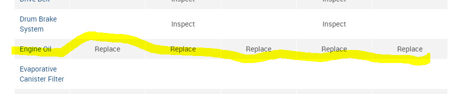

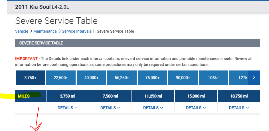

The idea that you drove that far on an oil change (10K miles), that is extreme the manufacturer is recommending every 4,000 miles. Am I correct in what I read?
Let me know. Also, see pics below for service table information.
See pics below.

On the obd2 I get VVT bank 1 fail
Should I be worried about it?
What does it mean?
