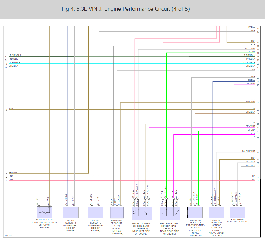

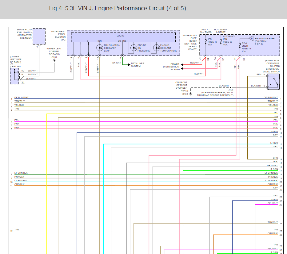

Truck went into engine power reduced while driving down the road. Truck cranks and runs, but no throttle. Changed throttle body, no help. changed accelerator sensor, no help.
Thanks for any ideas.
