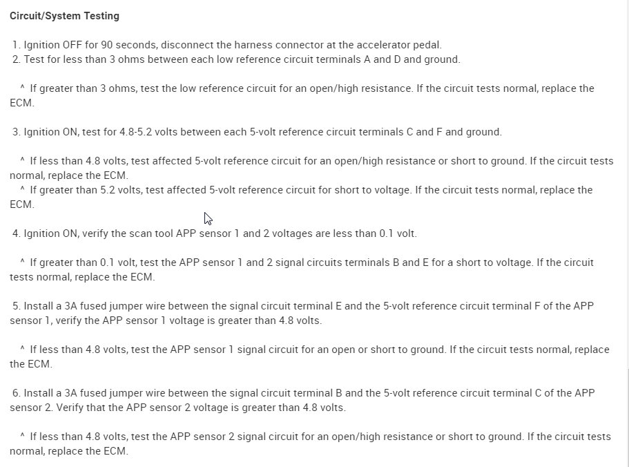

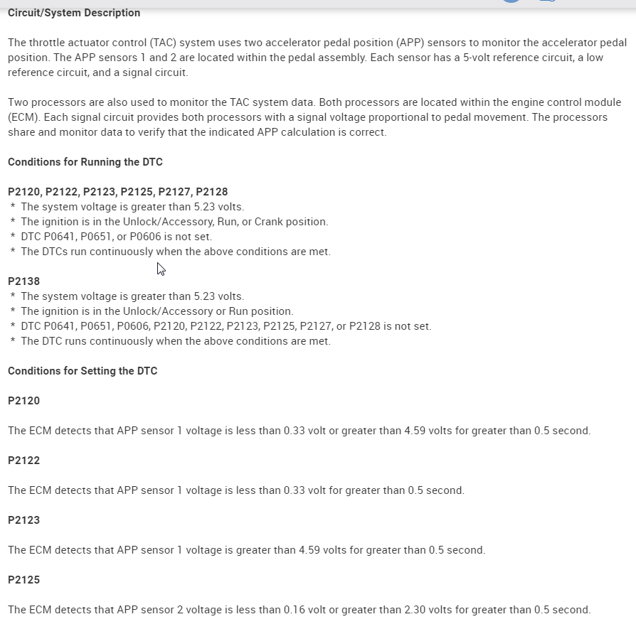

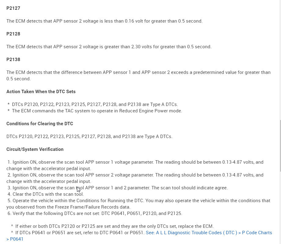

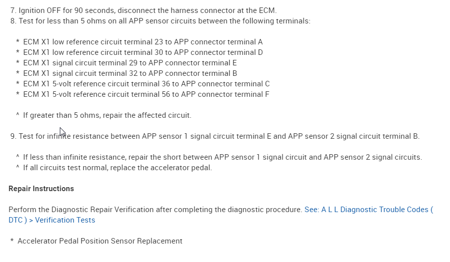

Had the throttle body replaced when code came up 2135. Same messages appeared three days later, now p2122 and p2138. Is it the pedal and how can i be sure this is the final fix?
