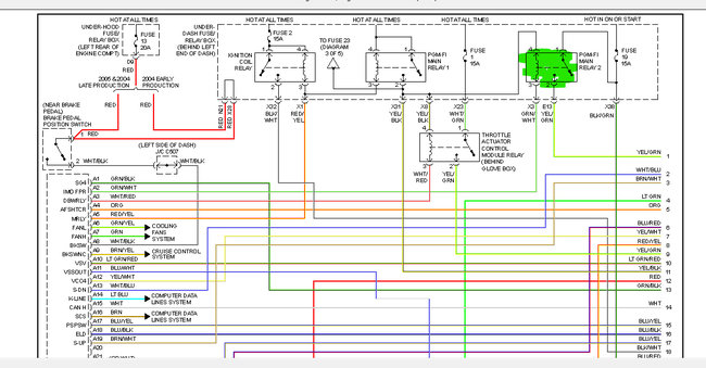

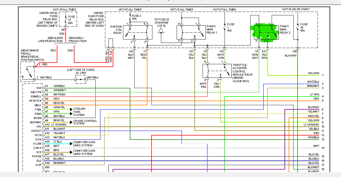

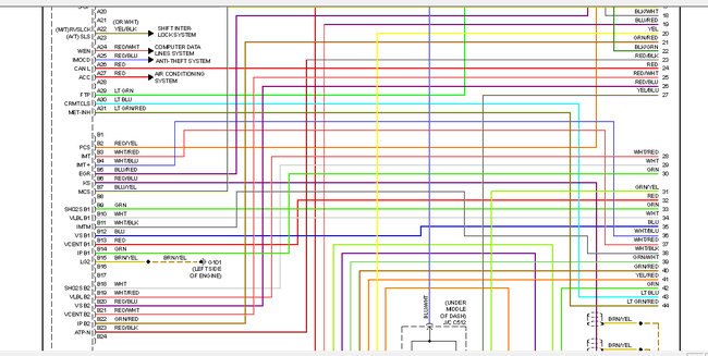

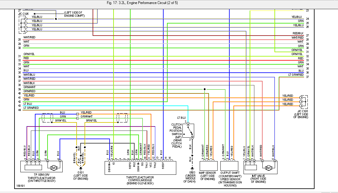

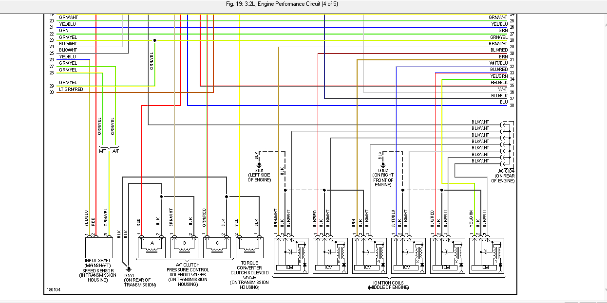

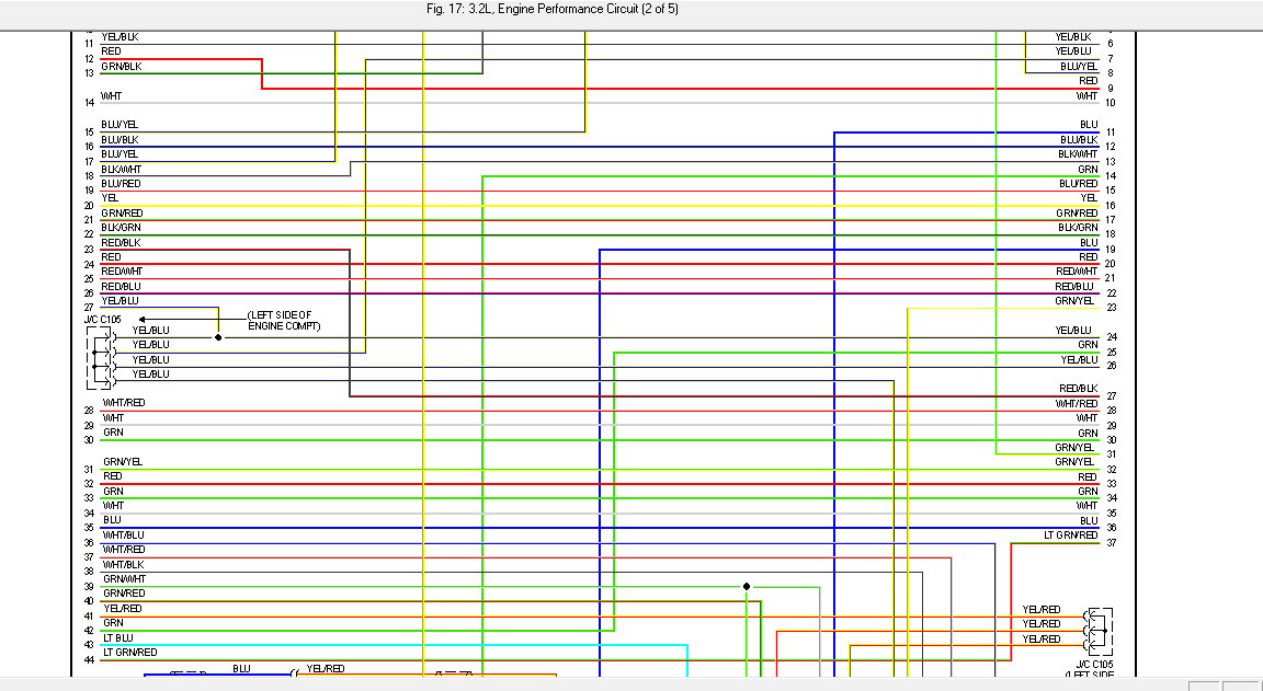

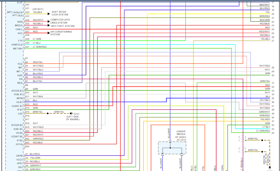

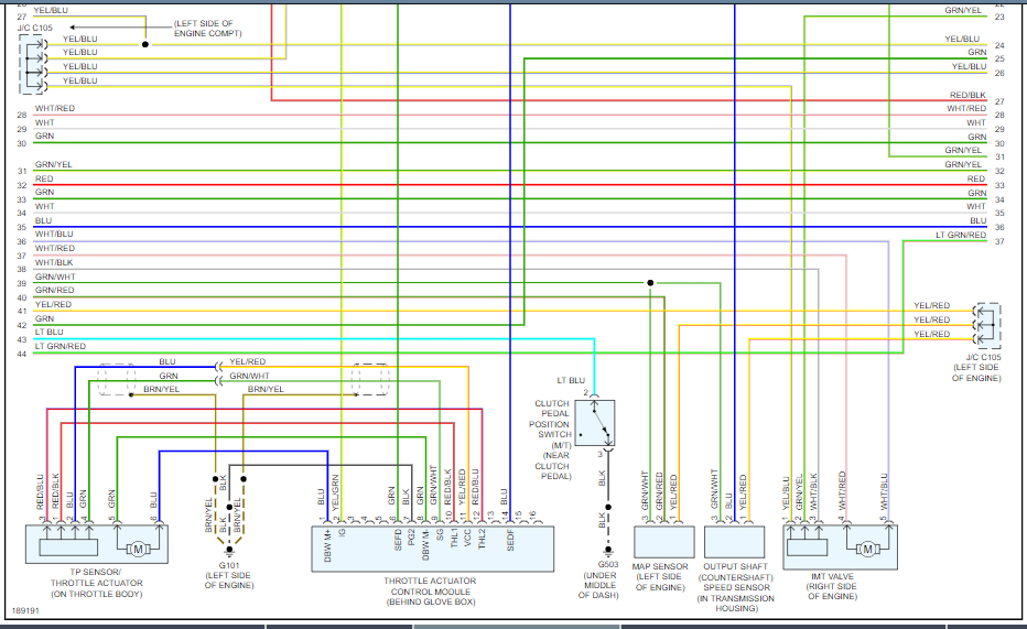

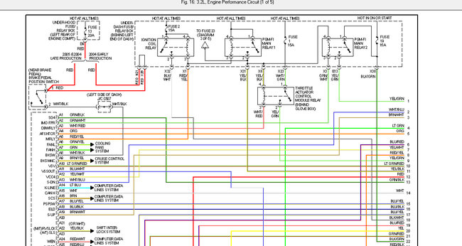

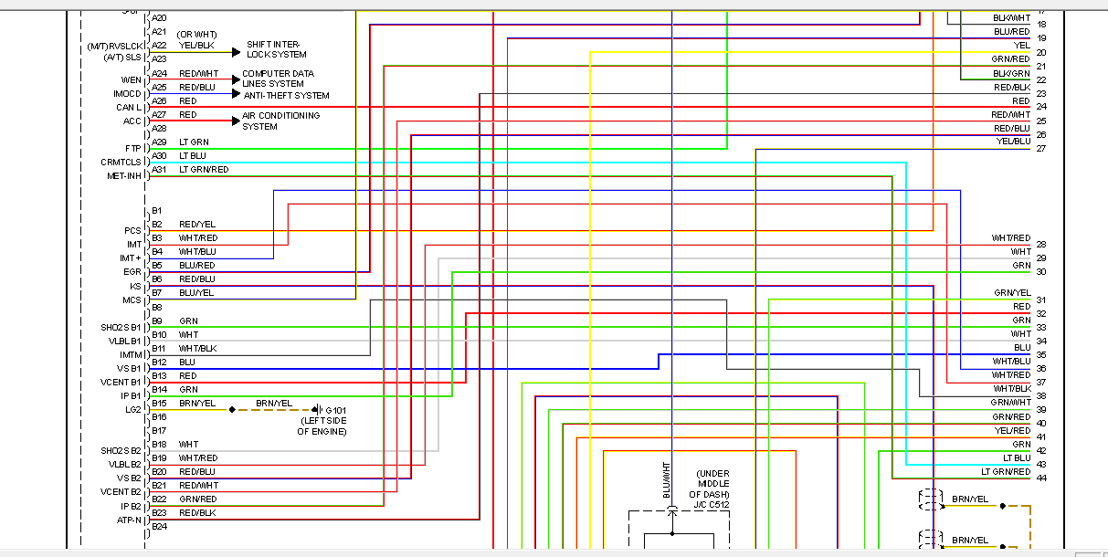

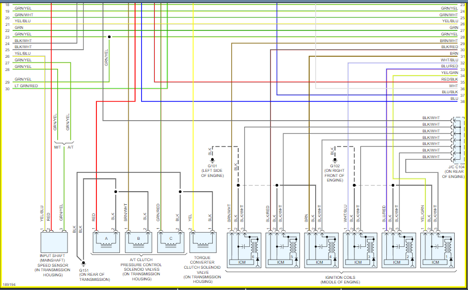

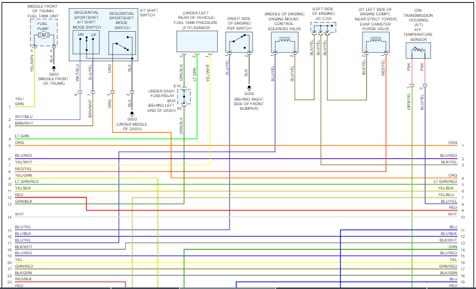

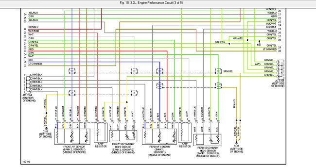

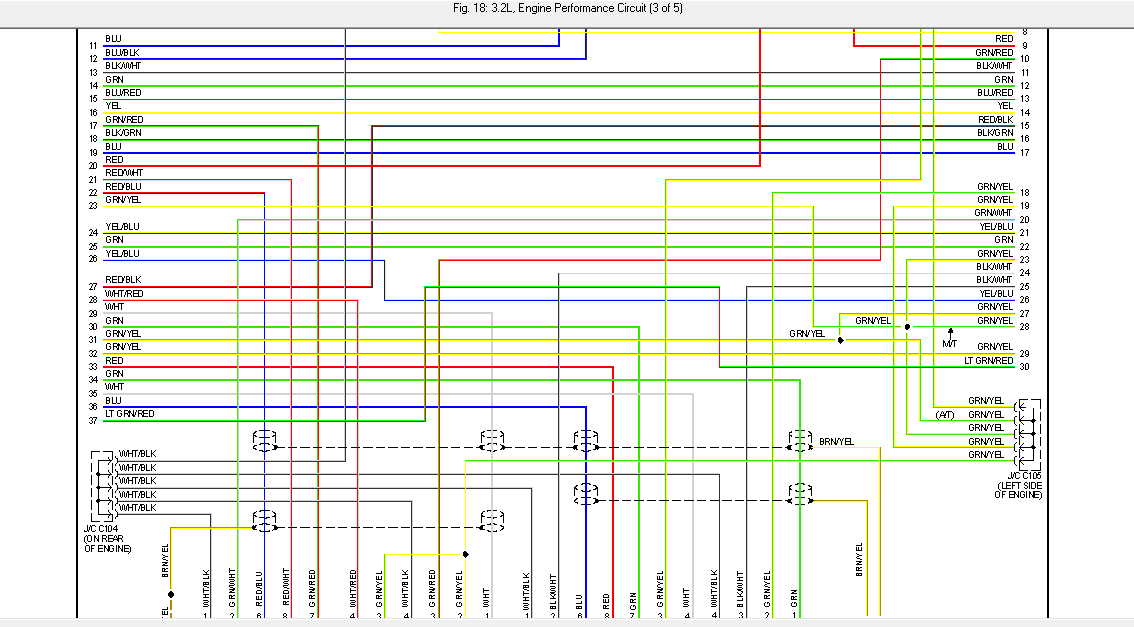

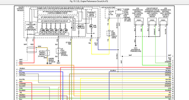

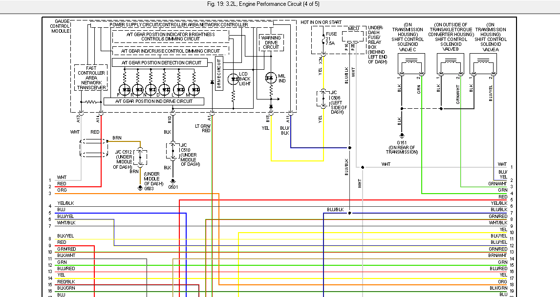

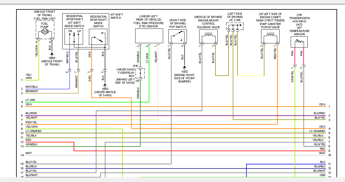

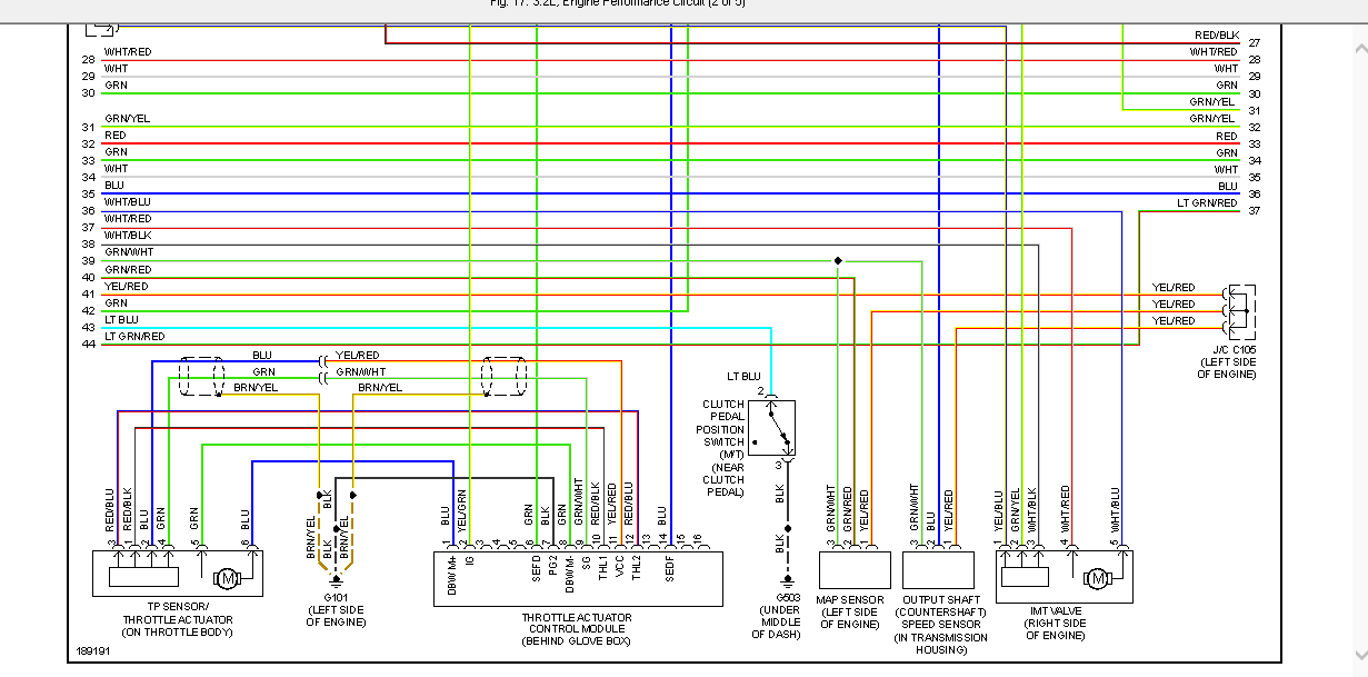

I've attached the ECM-PCM wiring diagram you requested below for your vehicle. I've cut each picture into 3 pieces so you can view larger. Let us know if the security reset works and get back to us. Hope this helps and thanks for using 2CarPros.

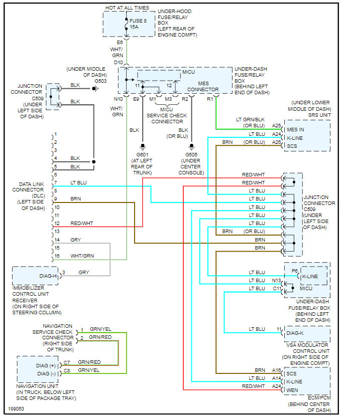

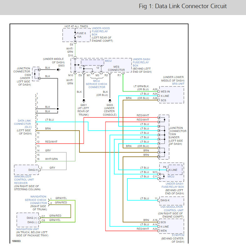

Another question that i have is, should pin 16 of the data link connector have 12 volts at all time (regardless of whether or not the immobilizer is activated)?

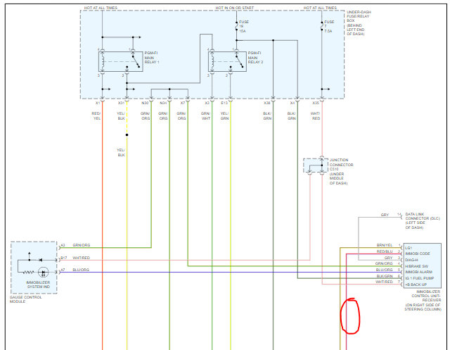

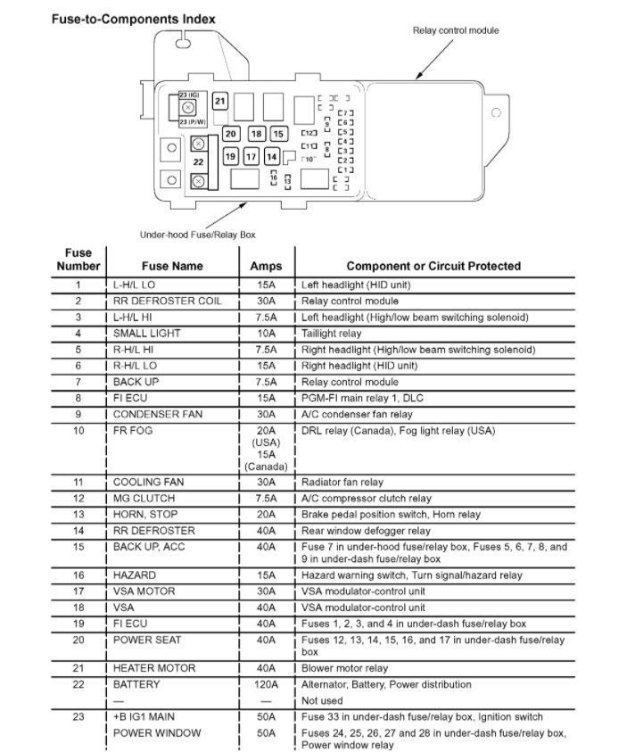

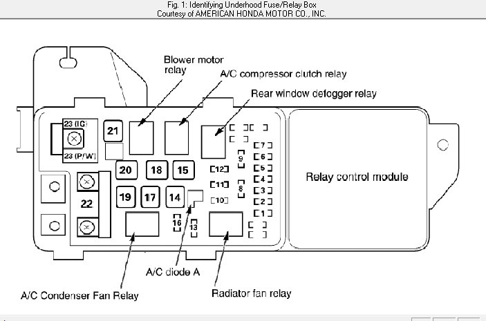

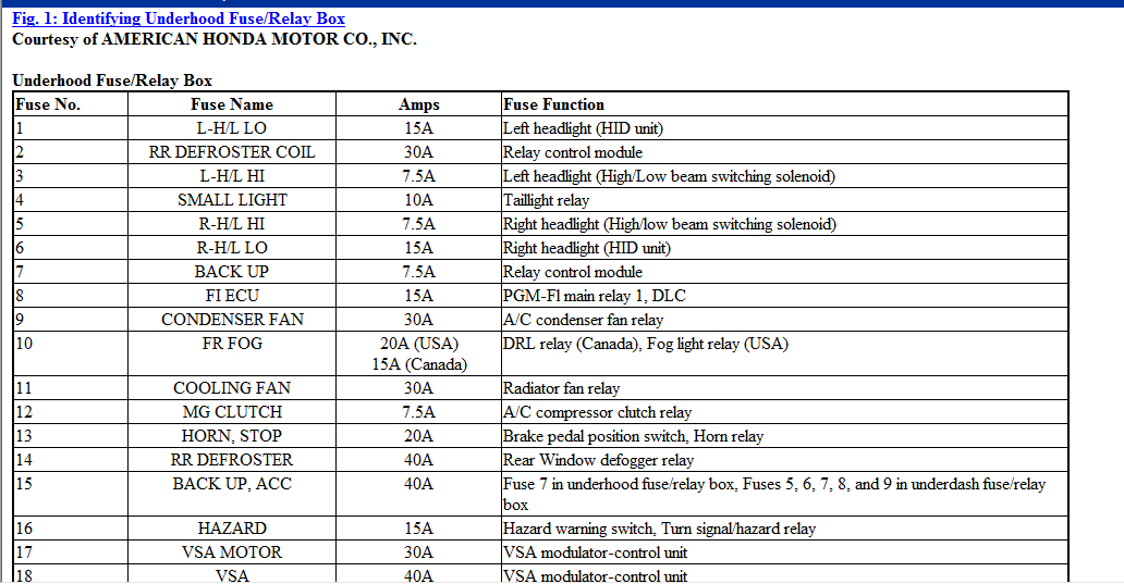

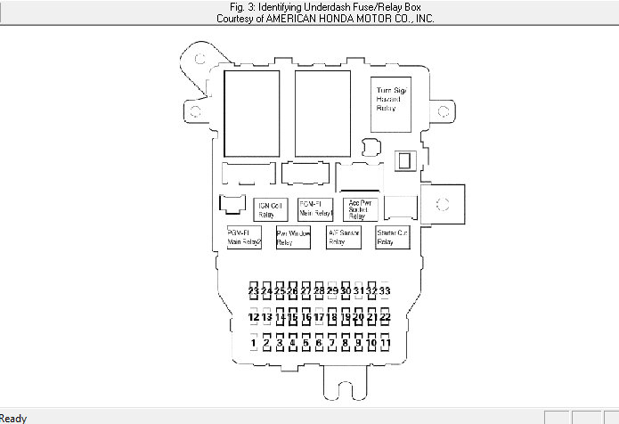

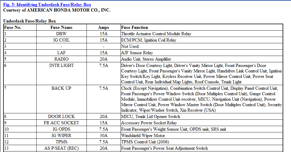

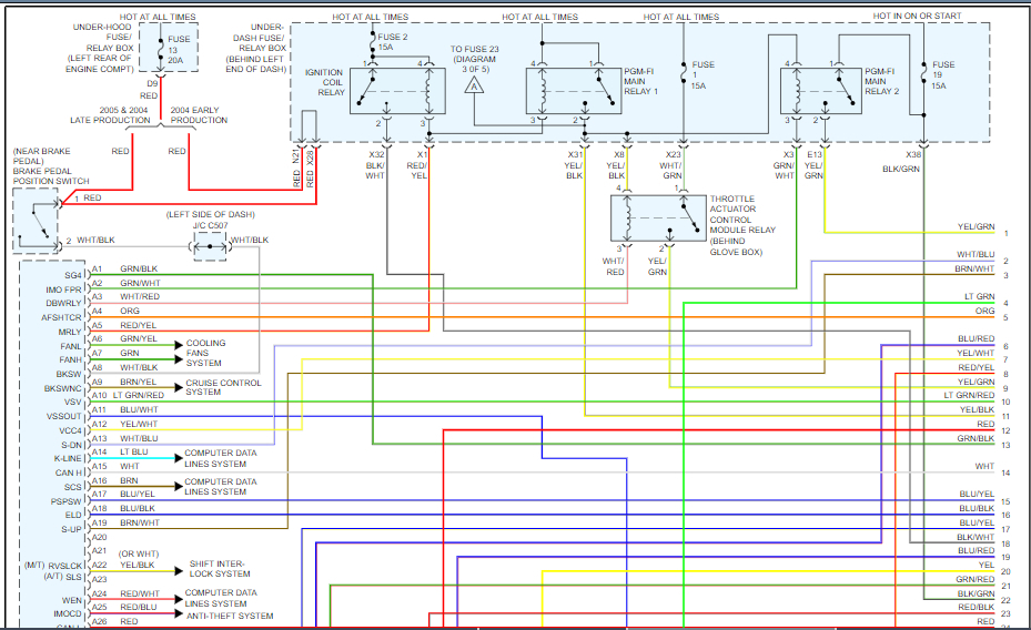

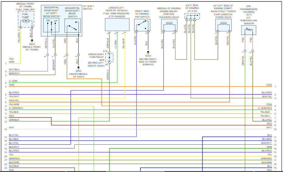

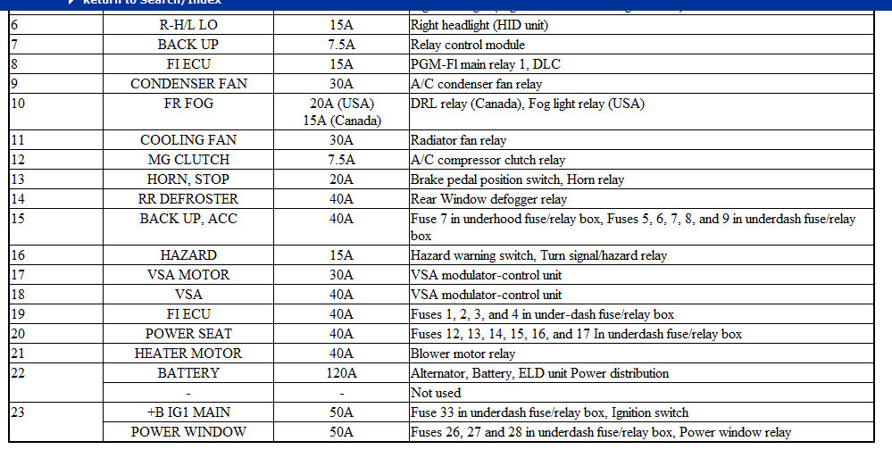

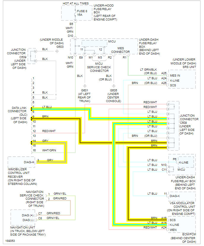

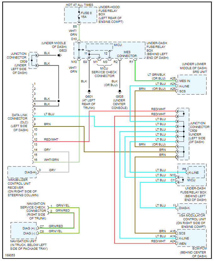

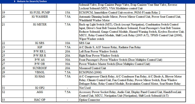

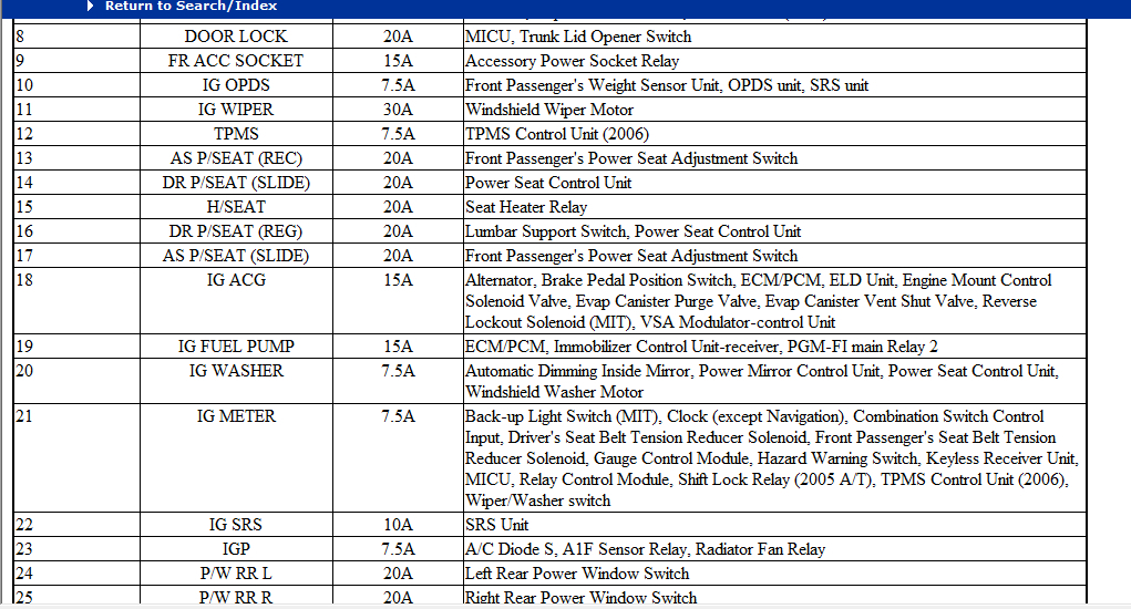

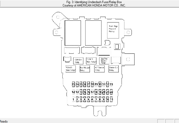

Yes, we should have power at the connector. let's check the # 8 fuse 15 amp in the under hood fuse panel. here is a guide and the fuse location in the diagrams below:

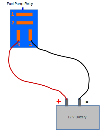

Per Acura's service instructions, the procedure for testing 4-pin relays for the 2005 Acura TL is to connect power to pin 3 and ground to pin 4 and test for continuity. There should be continuity between pin 1 and 2 when power is supplied, and no continuity when no power is supplied.
I tested a lot of the 4-pin relays on the vehicle without any issue (as soon as power and ground are supplied to pins 3 and 4, I heard the relay click and was able to check for continuity between pin 1 and 2).
However, when I tried to test the Fuel Pump relay (which is also a 4-pin relay), as soon as power and ground were connected to pins 3 and 4, instead of hearing the relay click, I got a spark/arc and the alligator clip/wire almost melted from heat within one second. I tested about 6 different fuel pump relays that I got from the junkyard (All were Mitsuba relays, which were known to fail) and they all caused a spark instead of clicked. Is it possible that all the fuel pump relays I tested were defective (very unlikely or extremely bad luck) OR is the fuel pump relay supposed to be tested differently from all other 4-pin relays? and if so, please tell me how to test the fuel pump relay. Thank you.

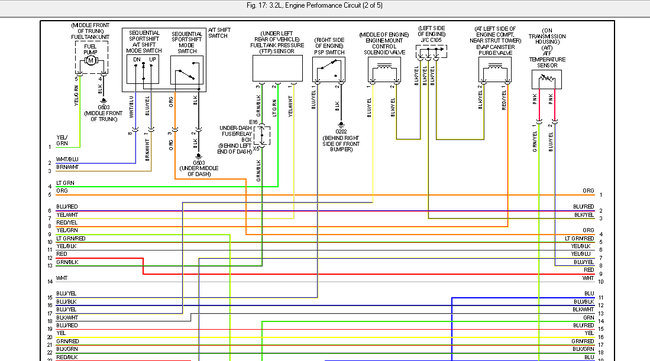

When you get spark when you supply 12v at pin 3 and 4 which means relay coil is shorted,

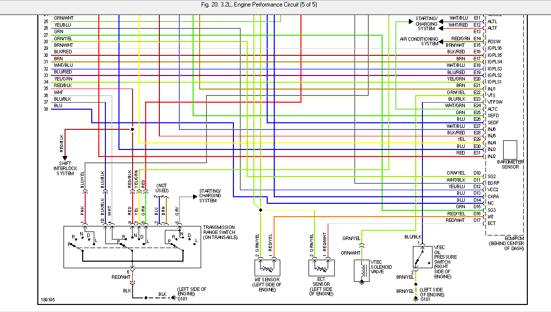

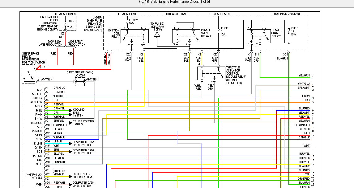

fuel pump relay is called main relay 2 in the diagram. its 4 pin normal relay, between relay 4 and 3 you must read from 40 to 120 ohms, between 1 and 2 infinity, when 12v applied at 3 and 4 pins click noise must be heard and continuity must be between pin 1 and2.
check our link below how to test a relay.

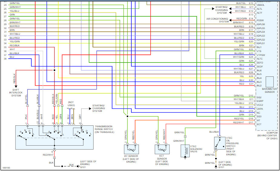

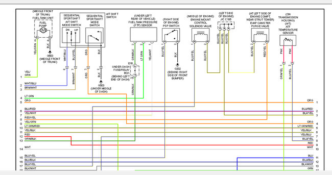

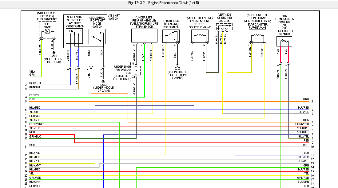

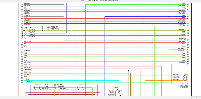

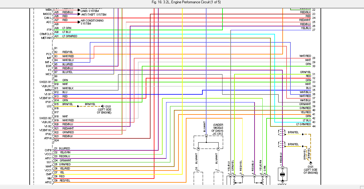

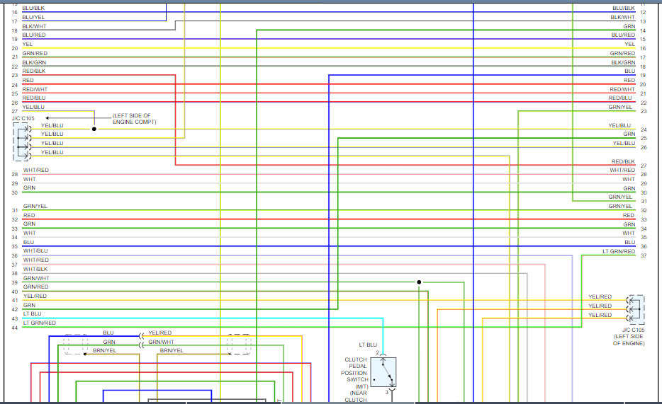

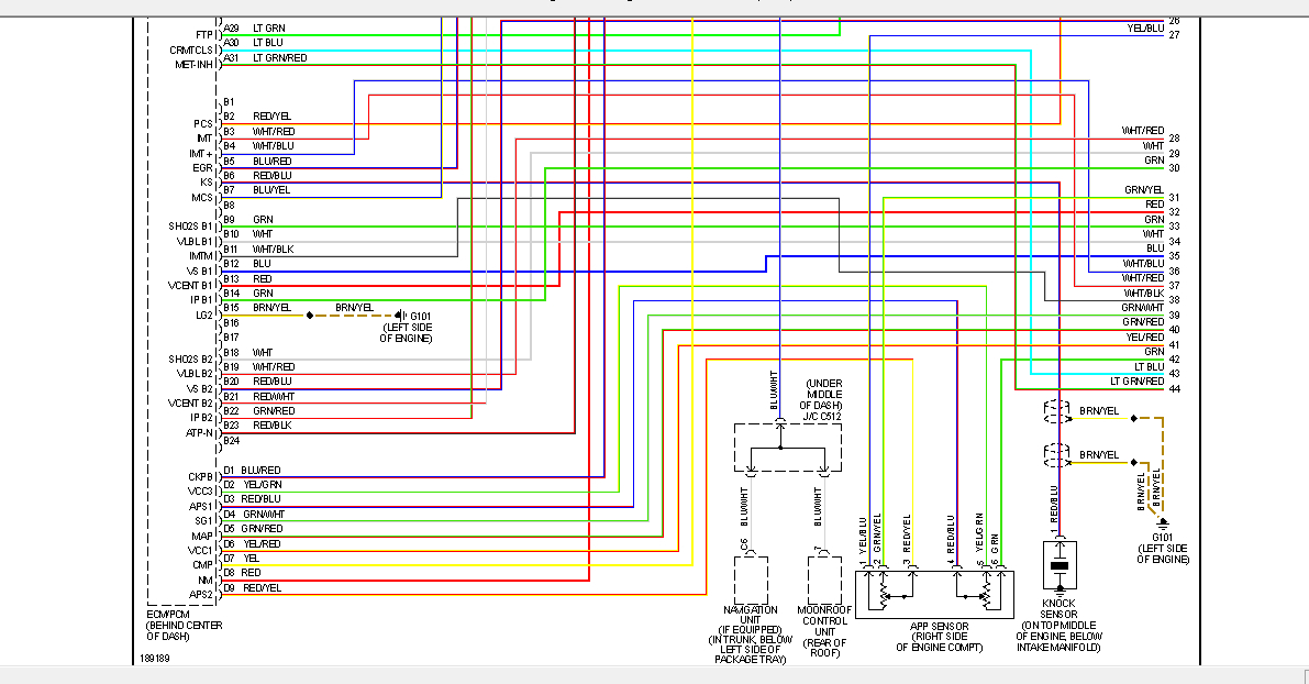

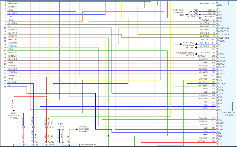

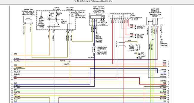

Check the diagrams below each page is cutted for 3 section for clear picture.

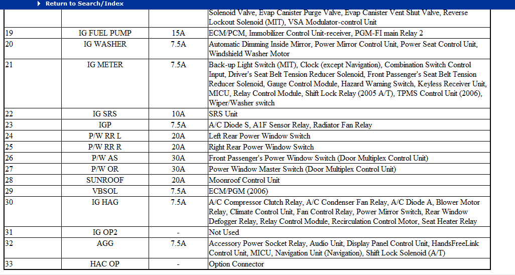

1.no main relay 2 (fuel pump relay ) just triggers the fuel pump refer to wiring diagram, fuse 19 (15A)under hood supplies positive to relay 2 pin1 and the immobilizer control unit.
check the main relay 1 which triggers the main relay 2 at pin 4.
check for positive at relay pin 1 you must get 12v from fuse 19(15A).
check pin 4 you must get 12v ignition on.
pin 2 is the positive voltage that activates the fuel pump. when the relay energized.
pin 3 is the ground that the engine control unit activates the relay2.
2.OBD port is not related to the relay2,check the fuse 8 (15A) which supply voltage to DLC, and relay 1.
3.yes for just testing purpose you can jump a wire between pin 1 and 2 fuel pump must be activated.

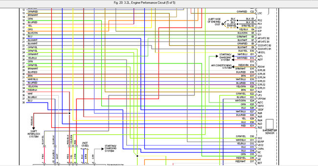

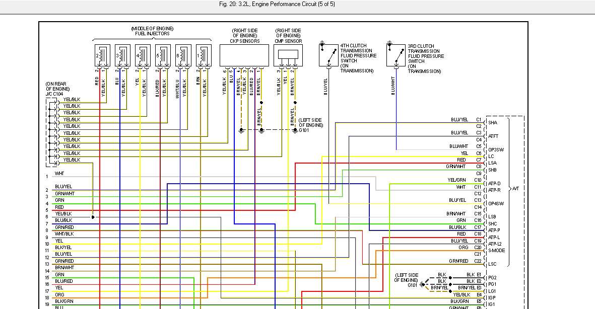

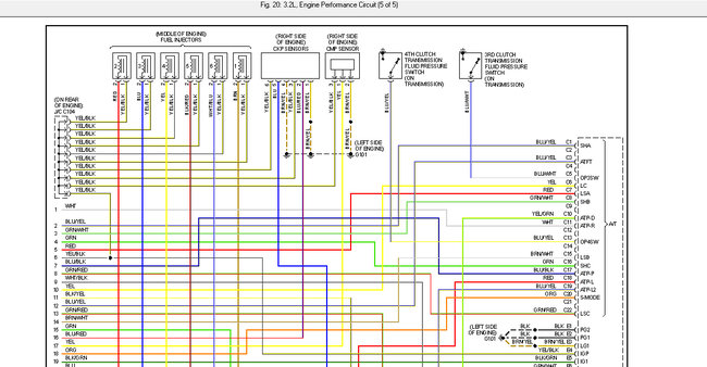

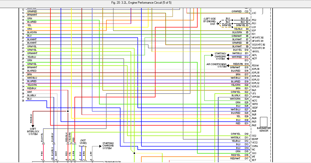

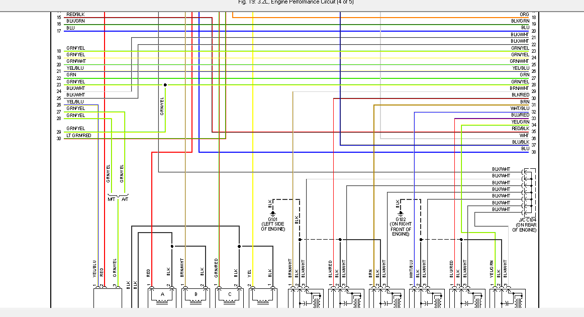

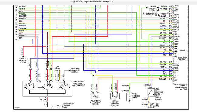

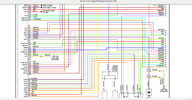

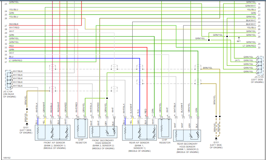

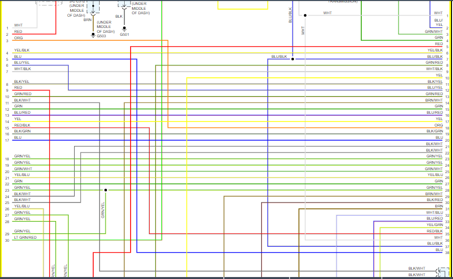

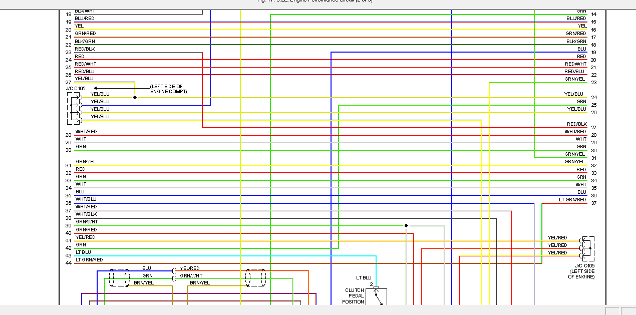

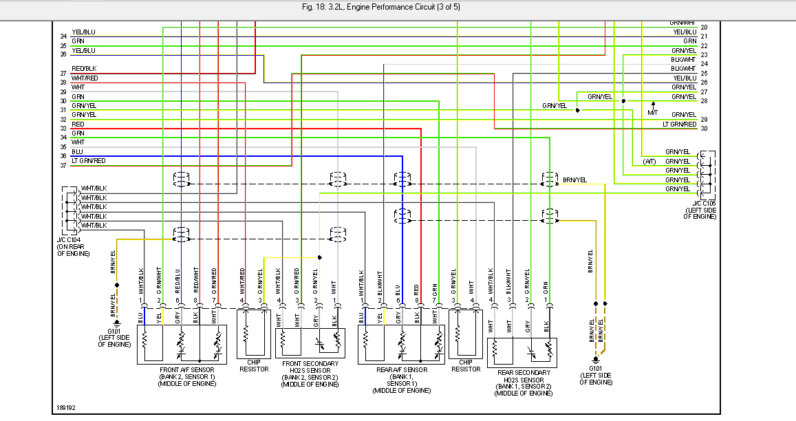

4.check the full engine wiring diagrams below which are 5 pages, each page i cutted to 3 sections for clear reading. also check the fuse box location.

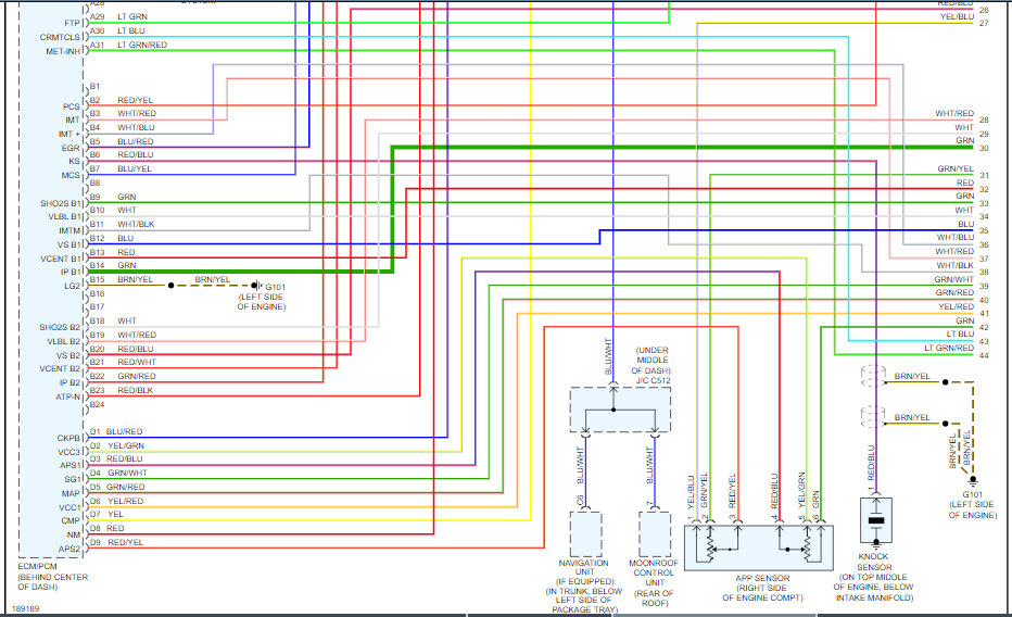

I tested the 5V reference at the MAP sensor connector and it did have 5v at the yellow/red wire and 0.02V at the green/white wire (ground). So, the ECU seem to provide the proper voltages to the MAP sensor.

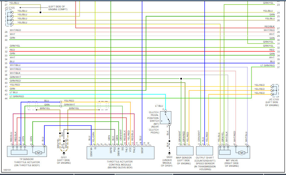

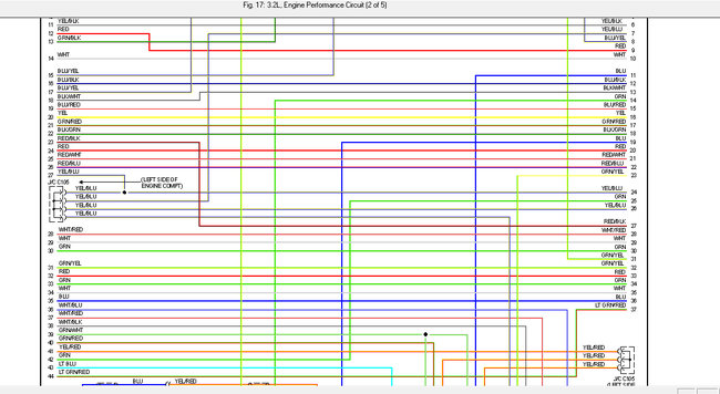

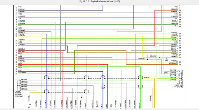

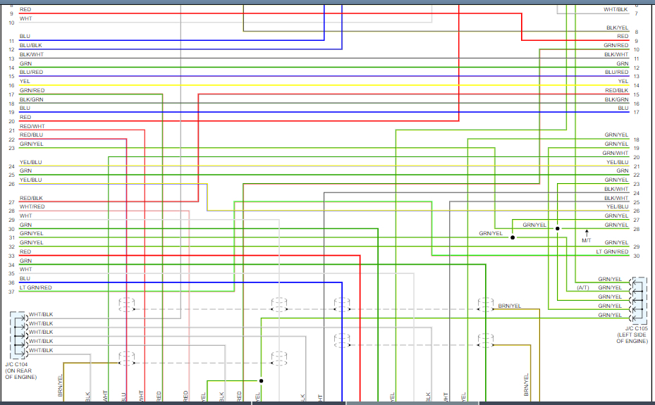

If you are not getting codes then you may have a ground issue with the DLC. I am not sure why you were checking voltage between 6 and 14. Take a look at the wiring diagram below. You don't have a wire in 6 but 14 is your diag high line.
6 and 14 are used in CAN bus systems but you don't have a CAN network so if you are not getting any voltage, this is why.

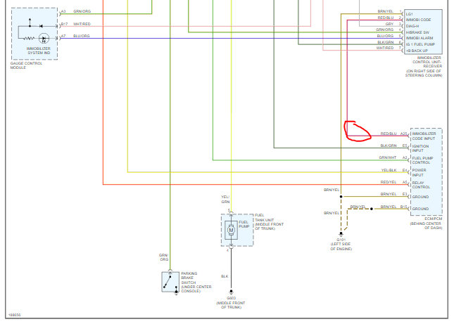

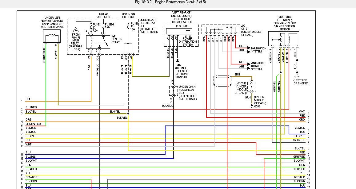

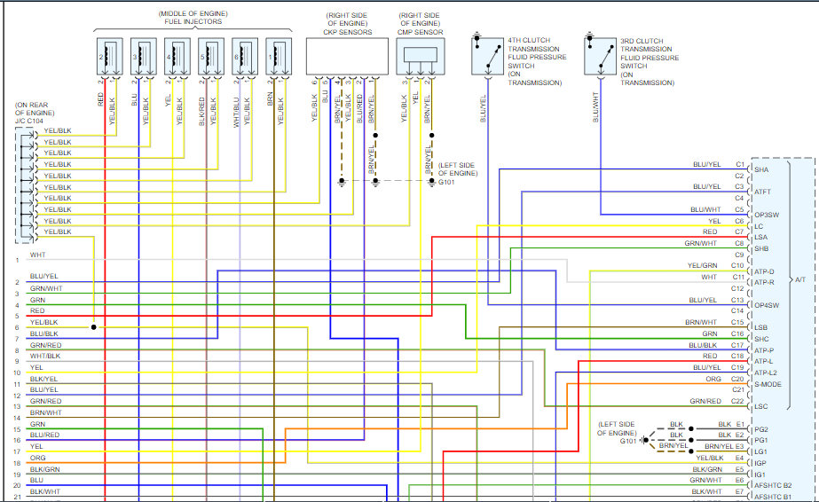

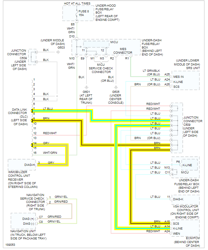

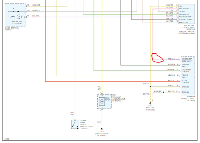

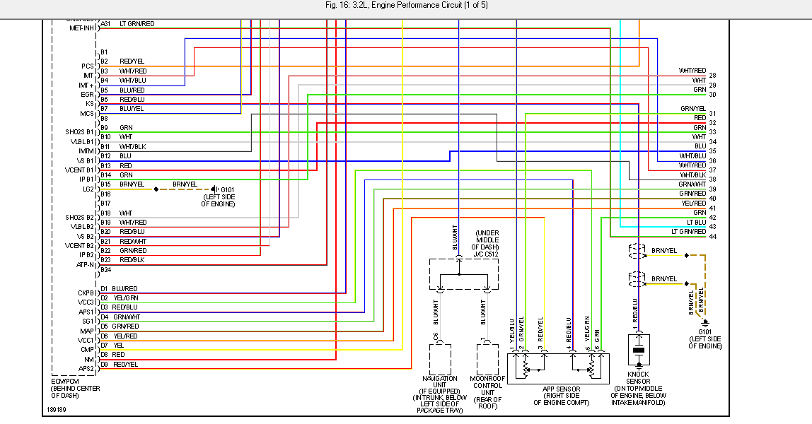

I was just curious to know since you've been doing a lot of wiring testing to see if you've checked the red-blue wire from the immobilizer control unit to the ECM/PCM? I've attached the diagram below. Let us know and get back to us. Hope this helps and thanks again for using 2CarPros.

I didn't test the red/blue wire that you mentioned. What do I test for: voltage, continuity, or resistance? and what value(s) should i be looking for? thanks

As I mentioned in a previously, I tested the 5v reference circuit at the MAP sensor, but based on the wiring diagram there seem to be 3 different 5v circuits (they may be internally connected) so I will have to test the other 2 circuits to see if they are alive. I learned that a bad sensor could cause the no communication error with the scanner. So, I will try to connect the scanner with as many sensors unplugged and see if that fixes the communication problem. But other than that, do you have any more suggestions? Thanks

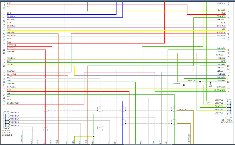

Okay. Clearly those voltages and pins look good. I suspect you have a communication issue with either the circuits highlighted below or the ECM has failed.
I understand what you are saying with the 5v signal issues however, I have not seen that cause a loss of communication issue with the scan tool.
However, just because I have not seen it doesn't mean it is not possible but it would be a new one on me.
If it were me, I would check continuity and resistance of the wires below from the DLC to the ECM just to make sure there are intact.
If they are, I suspect you have an ECM issue.
