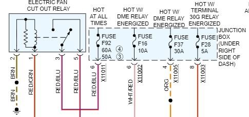

Also, here are a couple things you could check if you feel it is a fan issue. Check fuses F92 and F28. See attached picture 1. Also, in the same location is the electric fan cut-out relay. If there is another relay with the same part number, switch them to see if it makes a difference. Or, here are the directions for checking a relay.

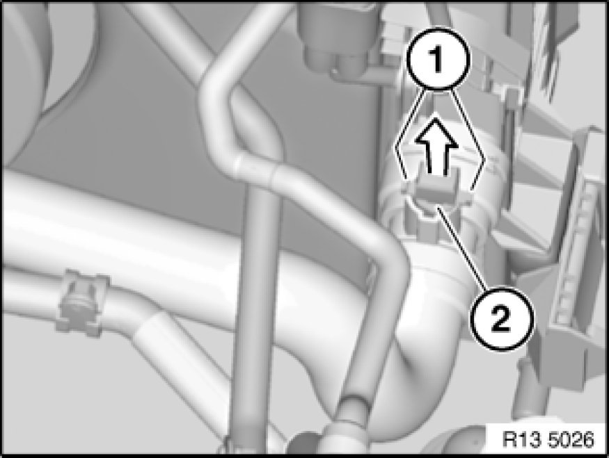

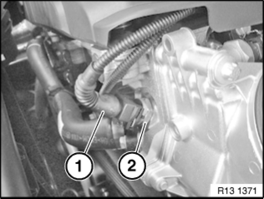

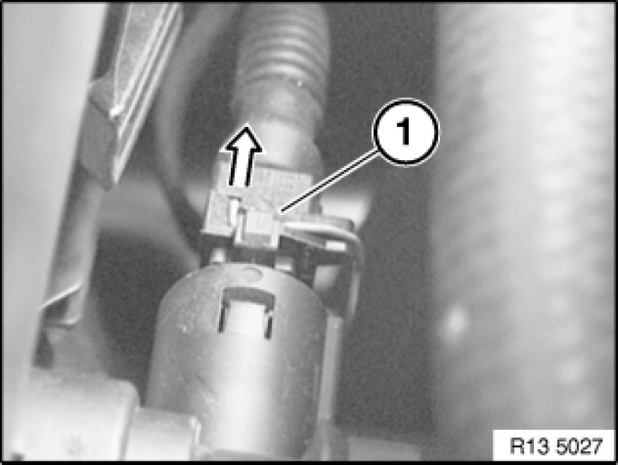

Also, check the radiator output temperature sensor's connection for corrosion. Picture 2 and 3 shows its location. Also, check the temp sensor on the right side/front of the cylinder head. Make sure wiring is in good condition with no corrosion. Picture 4 shows its location.
