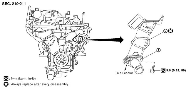

If you decide to replace the thermostat, here are directions specific to your vehicle. The pictures attached correlate to these directions.
REMOVAL AND INSTALLATION
WATER INLET AND THERMOSTAT ASSEMBLY
Removal and Installation
WARNING:
Never remove the radiator cap when the engine is hot. Serious burns could occur from high pressure engine coolant escaping from the radiator. Wrap a thick cloth around the cap. Slowly turn it a quarter of a turn to release built-up pressure. Carefully remove radiator cap by turning it all the way.
REMOVAL
1. Remove engine cooling fan (Motor driven type). See: Radiator Cooling Fan > Removal and Replacement > Removal and Installation (Motor Driven Type)
2. Disconnect radiator hose (lower) and oil cooler hose from water inlet and thermostat assembly.
NOTE:
Cap or plug opening(s) to prevent fluid from spilling.

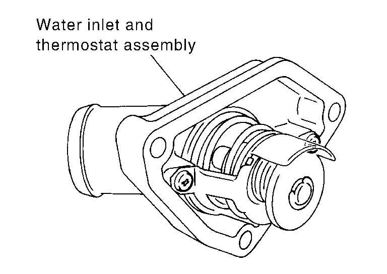

3. Remove water inlet and thermostat assembly.
CAUTION:
- Do not disassemble water inlet and thermostat assembly.
- Replace water inlet and thermostat assembly as a unit, if necessary.

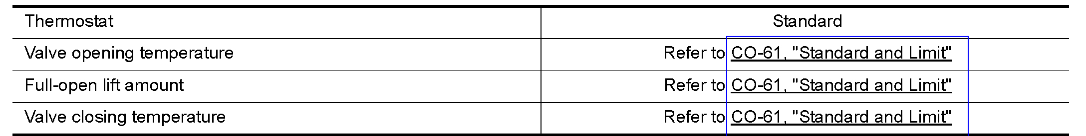

1. Check valve seating condition at room temperature. It should seat tightly.
2. Check valve operation.

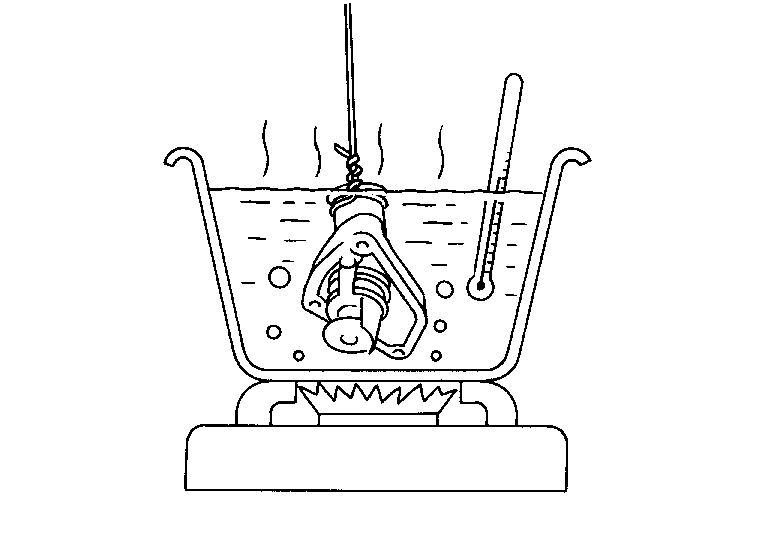

- Place a thread so that it is caught in the valve of the thermostat. Immerse fully in a container filled with water. Heat while stirring.
- The valve opening temperature is the temperature at which the valve opens and falls from the thread.
- Continue heating. Check the full-open lift amount.
- After checking the full-open lift amount, lower the water temperature and check the valve closing temperature.
- If valve seating at measured values are out of standard range, replace water inlet and thermostat assembly.
